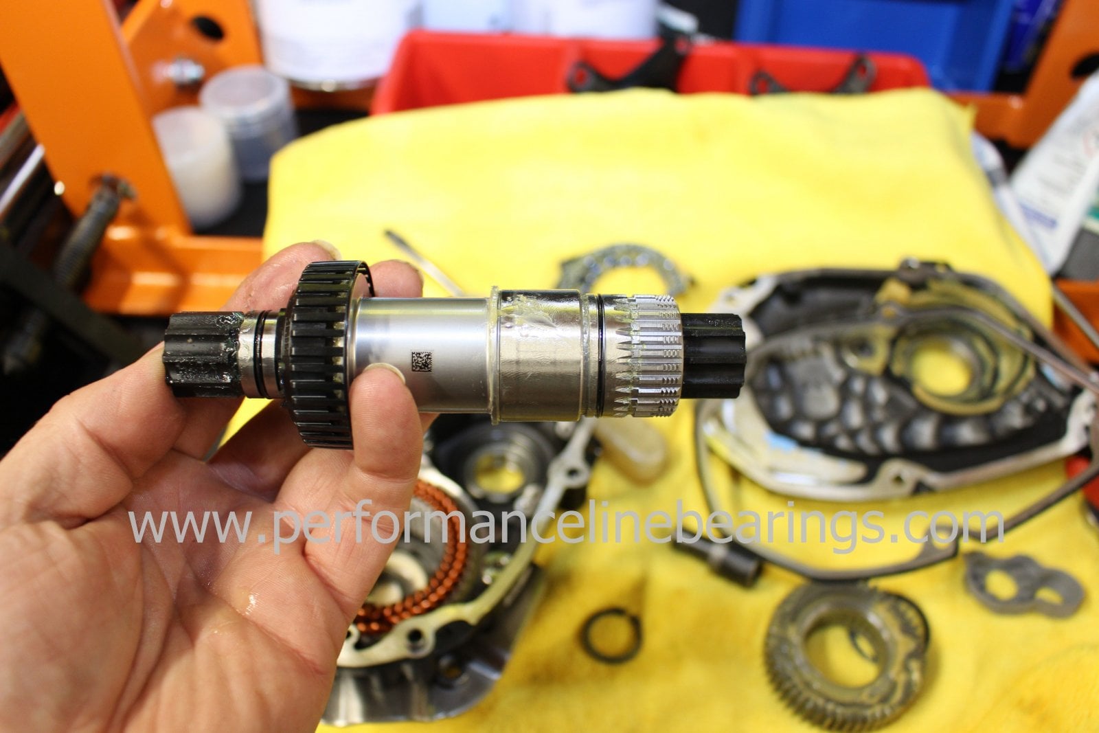

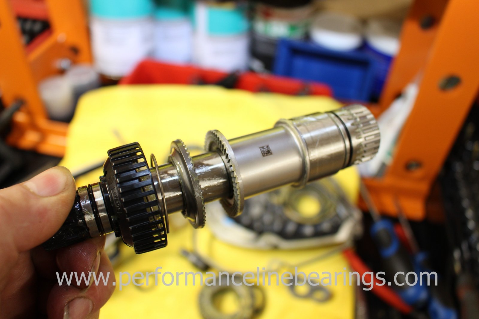

I have just finished stripping and inspecting the new Bosch Gen 4 motor and may have a theory for the clattering noise.
You will see in the photo the 2020 Gen 4's crankshaft with the sprocket carrier over the outside. 3/4 of the way down the crankshaft is a black "cage" inside is a freewheel mechanism that consists of two fine tooth ratchet faces pressed together by a spring as shown in pic 2.
If the ratchet lifted to the top of the teeth and was then slammed back into the stops of the teeth hard enough, it would "clack". This maybe happening as the bike is violently moving up and down from both ends while the crank is stationary?
