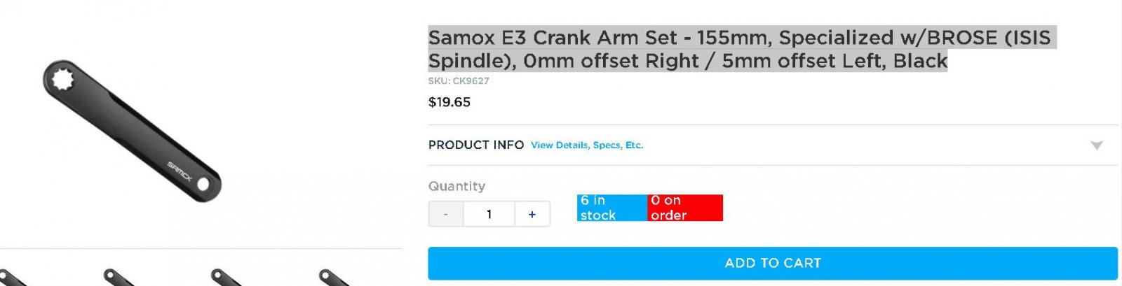

Anyway, was looking over all the threads and for sure know I need shorter cranks for my wifes 2017 Levo. It sits really low. I have seen lots of options out there, unicycle cranks, RaceFace expensive ones, SRAM but they don't make em short enough, Praxis, Miranda ones that seem to break, etc..
Stumbled upon these Samox E3 Crank Arms in 155/160/165 options.
"Samox E3 Crank Arm Set - 155mm, Specialized w/BROSE (ISIS Spindle), 0mm offset Right / 5mm offset Left, Black "
Guy at the shop who sells them (in a different state) had no experience installing them on a Levo, so wondering if anybody has heard or or used these?
They are about $20 USD shipped and claim to be 6061 Aluminum. The guys at the shop said they were a big company in Taiwan and are prob on some OEM bikes.
Any info? I ordered a pair of the 155s so I can share my experience when they show up..

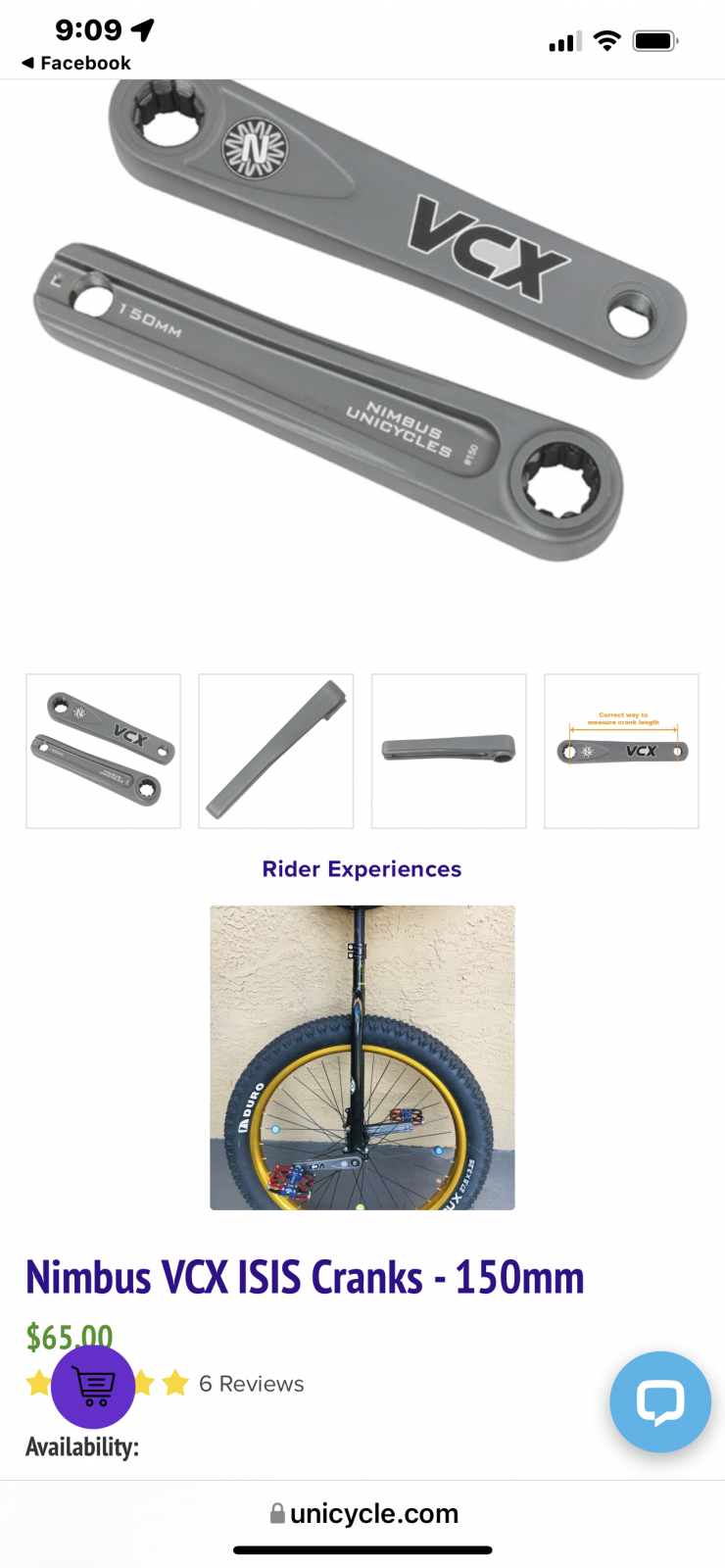

I'm brand new to the forum (awaiting shipment and build of my 2021 Oak Green Turbo Levo Comp) and e-bikes in general but I can provide some useful input on ISIS unicycle cranks. Saw it on an EMBN episode. Nimbus is Unicycle.com's house brand. Order online at Unicycle.com and tell Josh I sent you. If you want absolute bombproof crank arm look for an old pair of Kris Holm (unicycle God) Moment cranks or his newer lighter Spirit cranks.

Hey, the cranks arrived last week, but it turned out that the existing stock bolts from the Praxis cranks would not fit into the hole of the Samox crank arms. My local shop hooked me up with what were just standard ISIS bolts, which should work fine. Didn't get a chance to install yet, but should this week and then I will get a few rides in and update. Also, FIY if on the Praxis cranks, you need a 16MM allen to get the outer ring off. Didn't have one of those, but Amazon to the rescue.

After a few rides with the 155 cranks, my wife is a happy camper. Way less pedal strikes. She is not noticing the difference while pedaling. I have a few before/after pics I can post if people really want, but there is no clearance issues with the new cranks. They seem to be well made. They are metal, not really sure any other way to test quality vs the test of time so we will see. Will prob be making the same upgrade on my bike in the near future. For basically $30 out the door just really hard to beat. Might also look to upgrade chainring to a 36.
