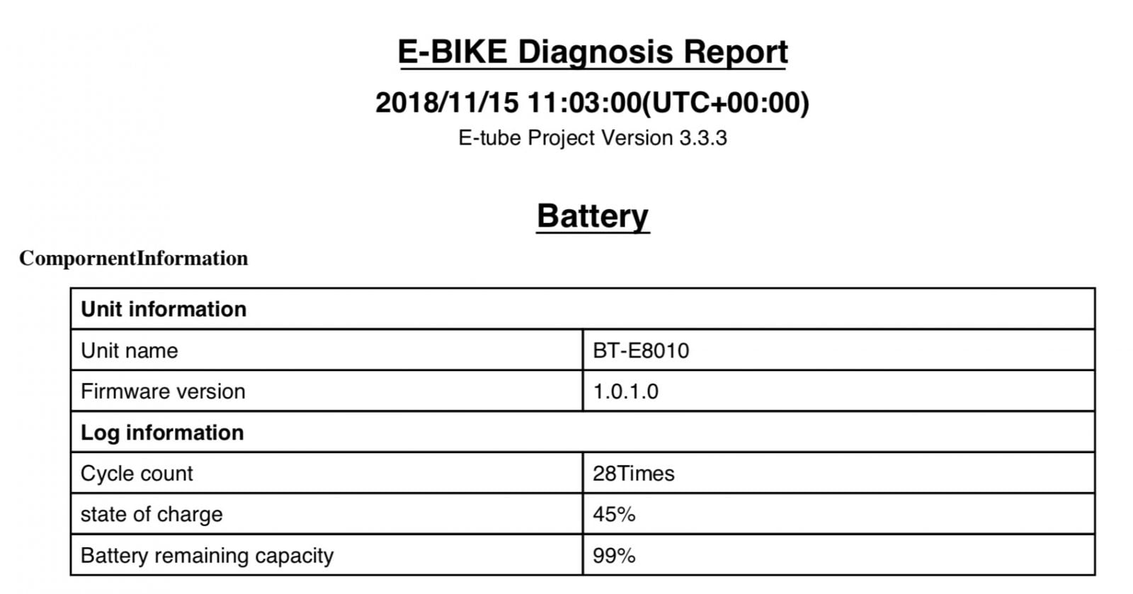

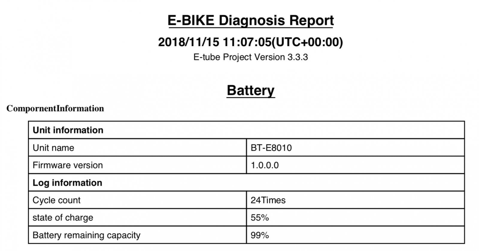

I was thinking we could compare the effects of the charging methods on the battery health and if any particular method is better or worth the 'extra mile' to preserve the battery capacity for longer. As far as I know, the battery diagnostic is possible by the user through the app on the Levo/Brose and the Shimano systems.
Here is mine:
2 batteries, 11 months, 24 and 28 charge cycles and 99% remaining capacity on both batteries.
After rides, I charge the battery to ~70-90% and before the next ride I top it off to 100%.

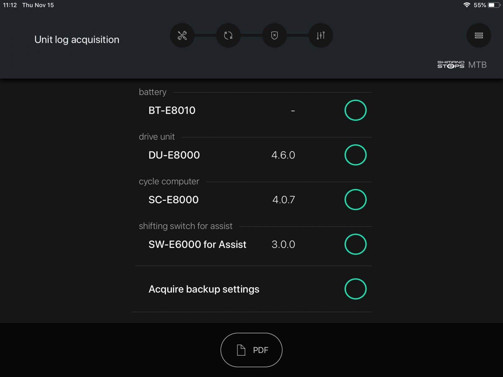

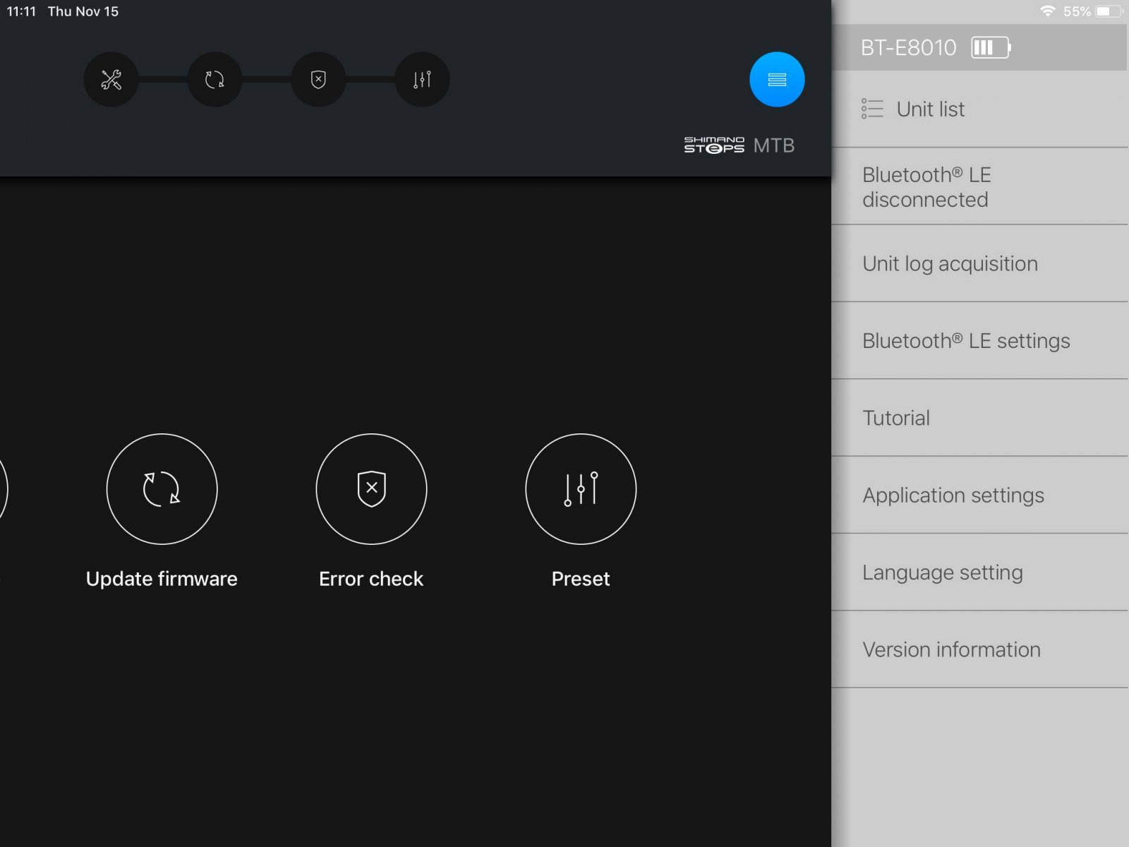

Sorry for the newbie question, but how can one find this diagnostic information for an ebike battery? I've got 2 x Shimano batteries, but can't find a Shimano app that will give me anything like what you've displayed. Is it Android only?
No, you can run diagnostics with the tablet version of the E-Tube Project app.
Tap the 'button' on the top right and tap 'Unit log aquisition':
Then on the bottom tap 'PDF' and you will be able to view and save it.
