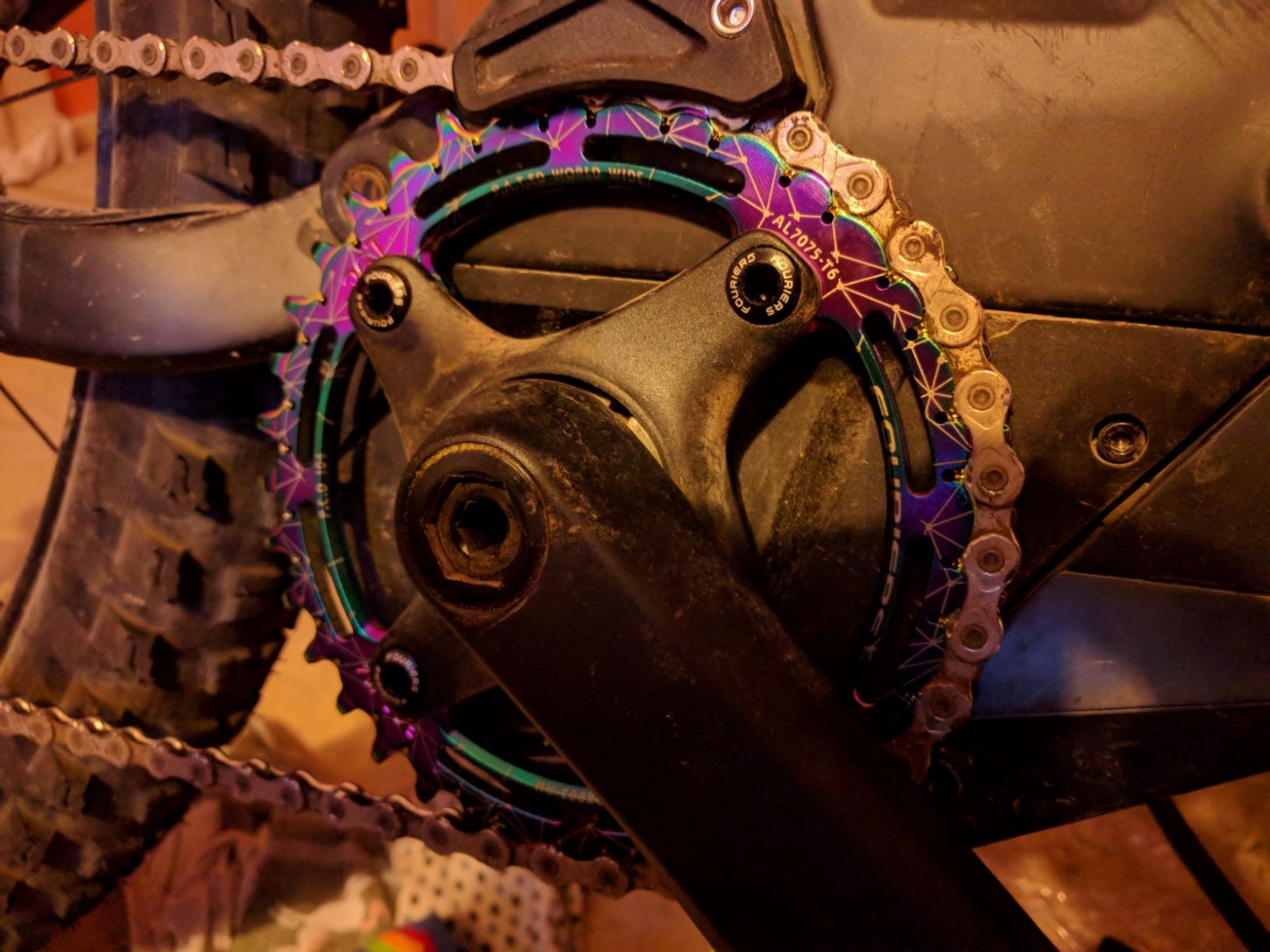

Thanks to all for the tips in this thread! I put a Raceface 36T on my Turbo Levo Carbon Comp. The factory 32T slipped off and the 36T went on with a little bit of puzzle solving skills. Never had to break the chain or remove the clipless pedals. I put steel chainring bolts on and used blue threadlocker. I used some masking tape to hold the backing bolts in while I got the ring aligned. I really like the 36T much better. I was spinning out downhill with the 32 and now seem to be hitting about 110 cadence at 30mph. I can live with that. On the low end on high teens slopes I'm going to be losing traction on dirt before I need a lower gear than the stock cassette and a 36T so no loss for me there. Very happy with this setup.

What Brand is that? I like the colors. Good match with the purple blue color changing Carbon Comp model. I put a Racefacce on mine and really like the 36T better. I Would like to source a steel one if someone knows of it please chime in?
