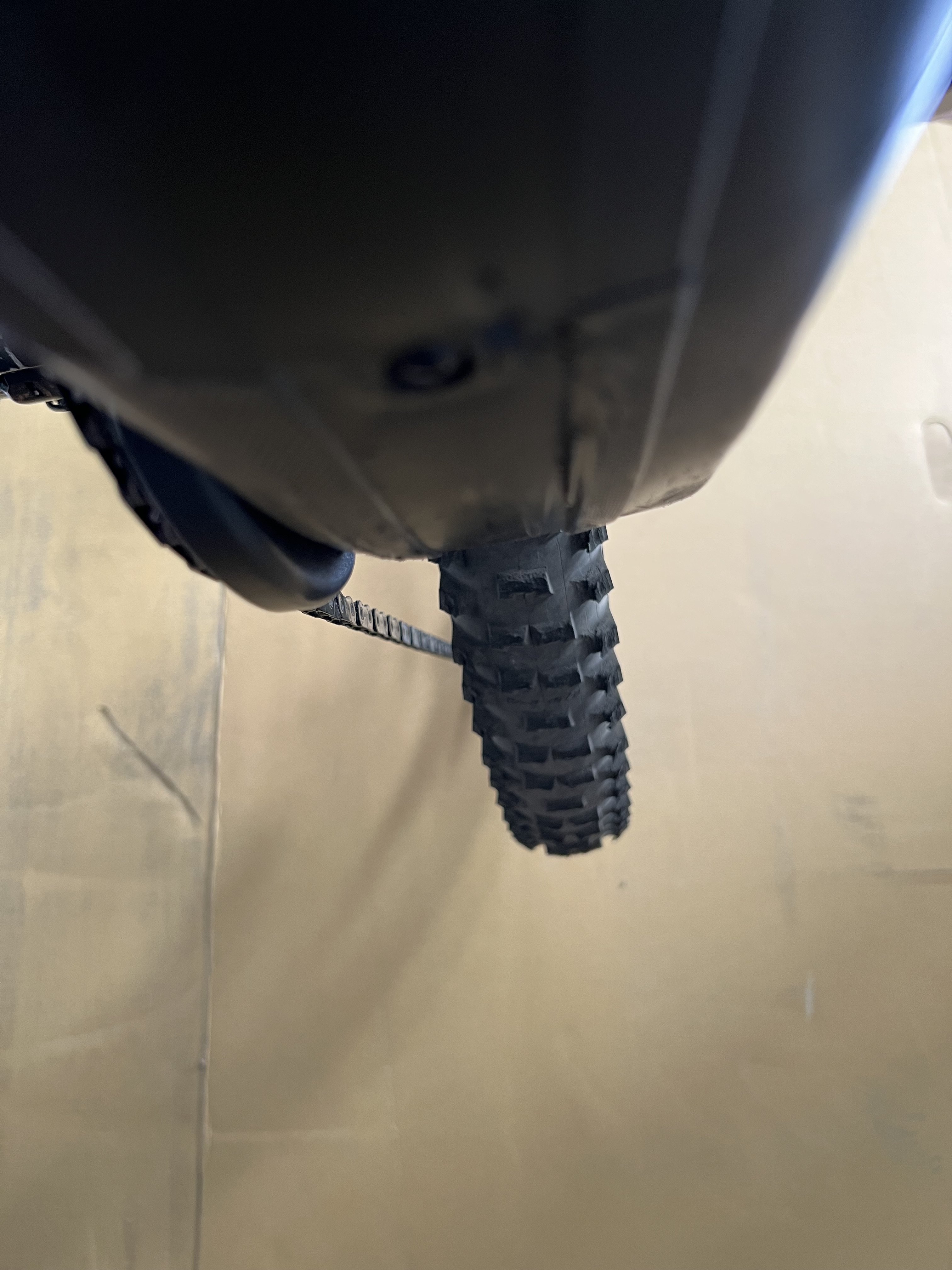

hello all

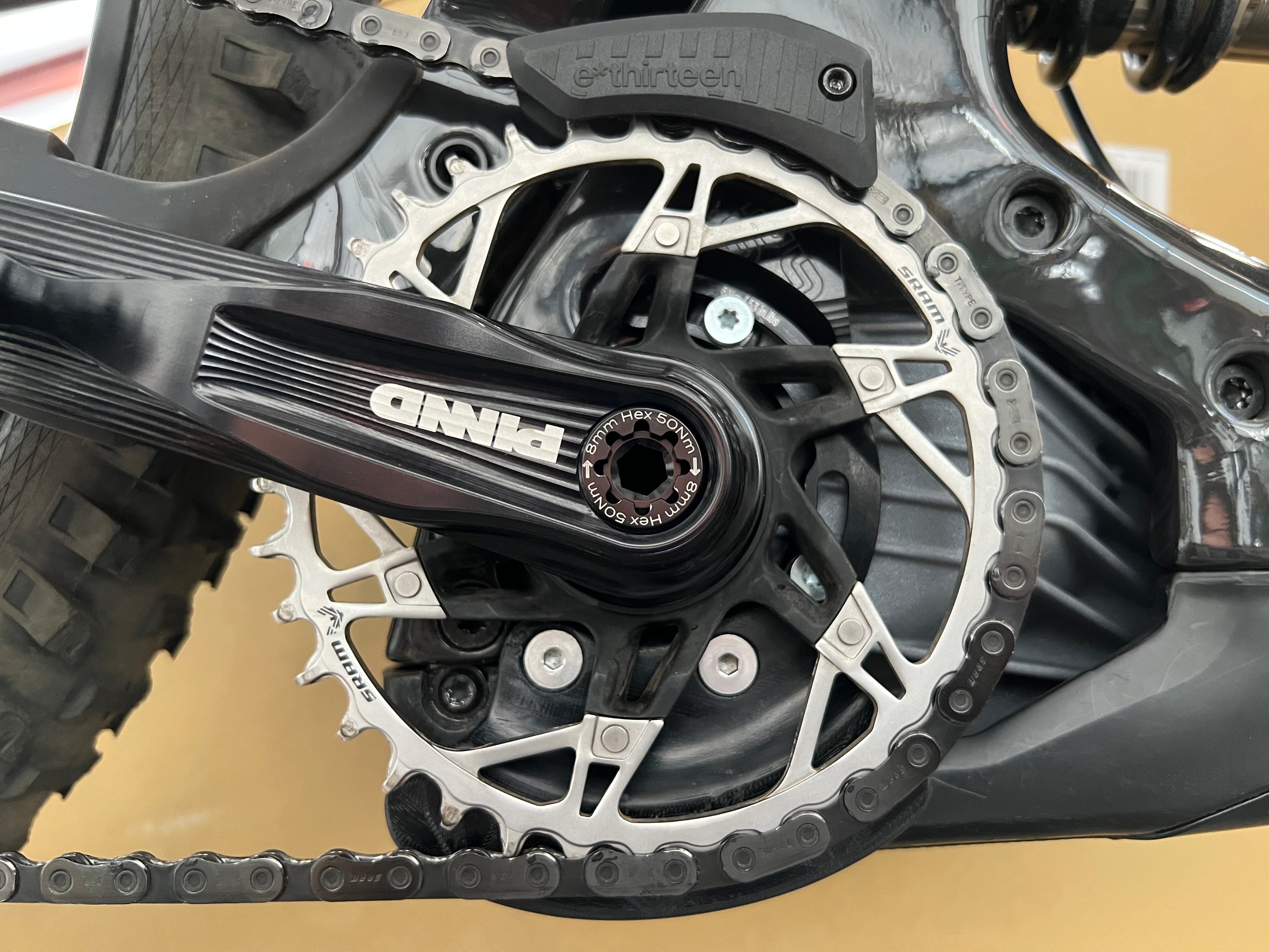

I ride a Cube Stereo Hybrid 120 (2021) with a the latest Bosch CX Gen4 motor. It has a 38 tooth chainring on the crank.

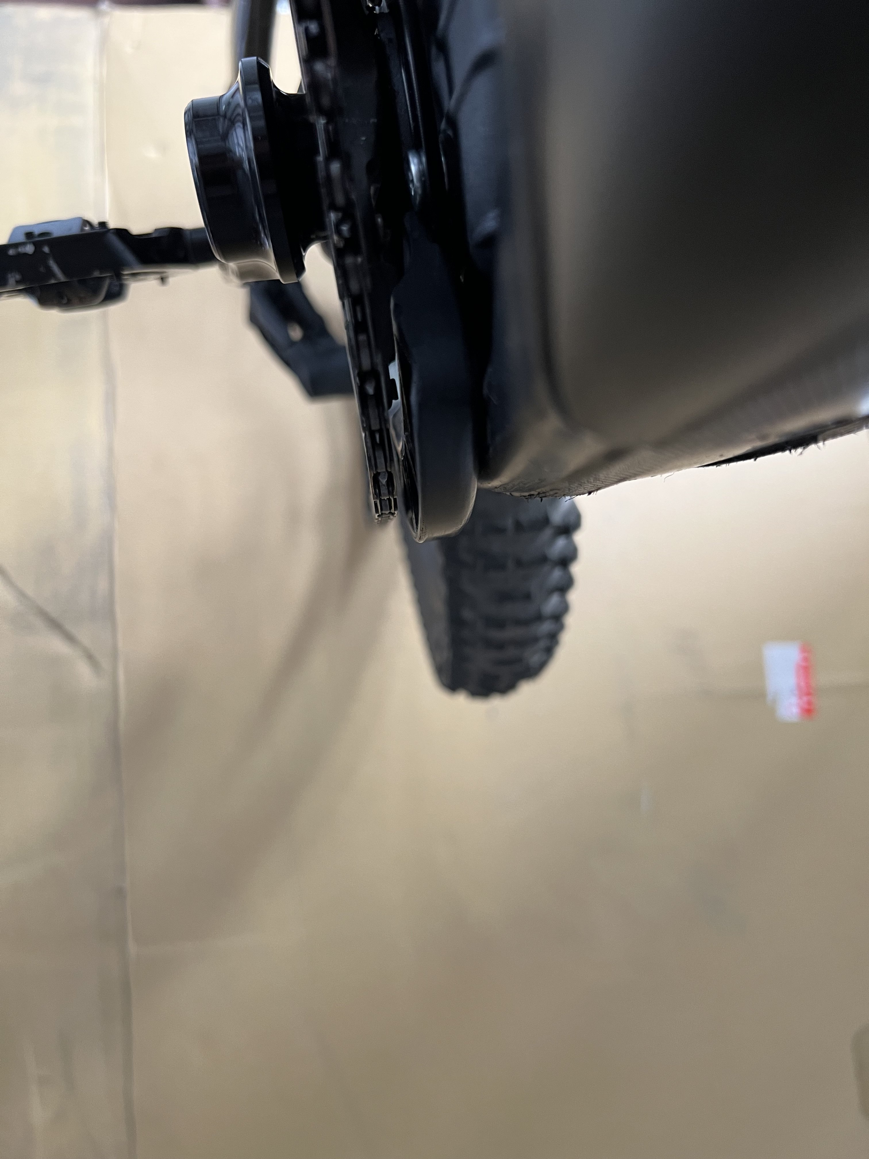

I find that this chainring + chain is sticking out under the engine plastic 'bashguard', about 1 cm . With the former gen3 motor, there was a very small chainring, and no risk of crashing the chain against a log in the woods...as i tend to do sometimes.
My bike already has a chainguide on top from E*13 off factory.
Looking at the bolt hole pattern around the BB and some comments on internet , i bought online a ISCG05 compatible bashguard/chainguide .
But the 3 hole pattern on the Bosch seem to be in a smaller circle than the IOSCG05 standard - it does not fit.
Is anyone familiar with that? Does Bosch use a different bolt pattern for chainguides ? any ideas for an alternative?
thanks
Chris

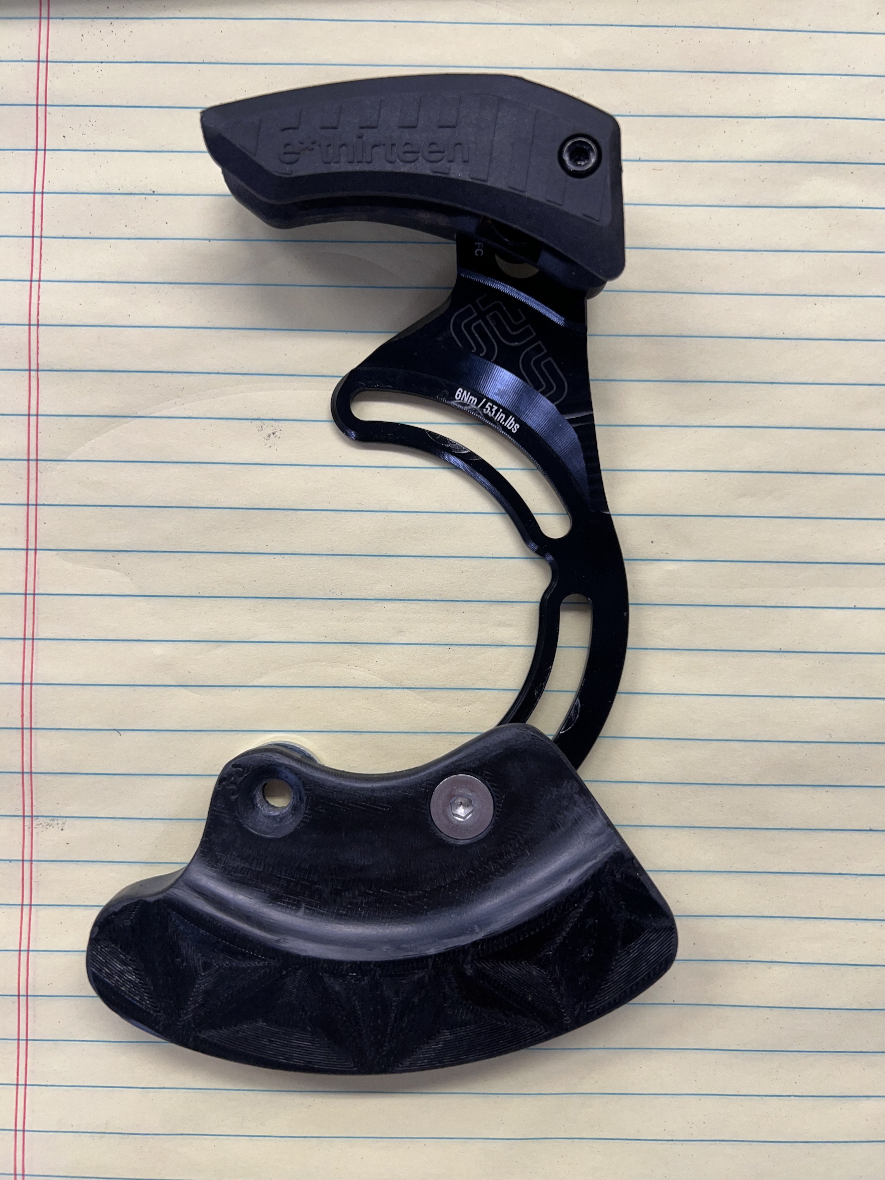

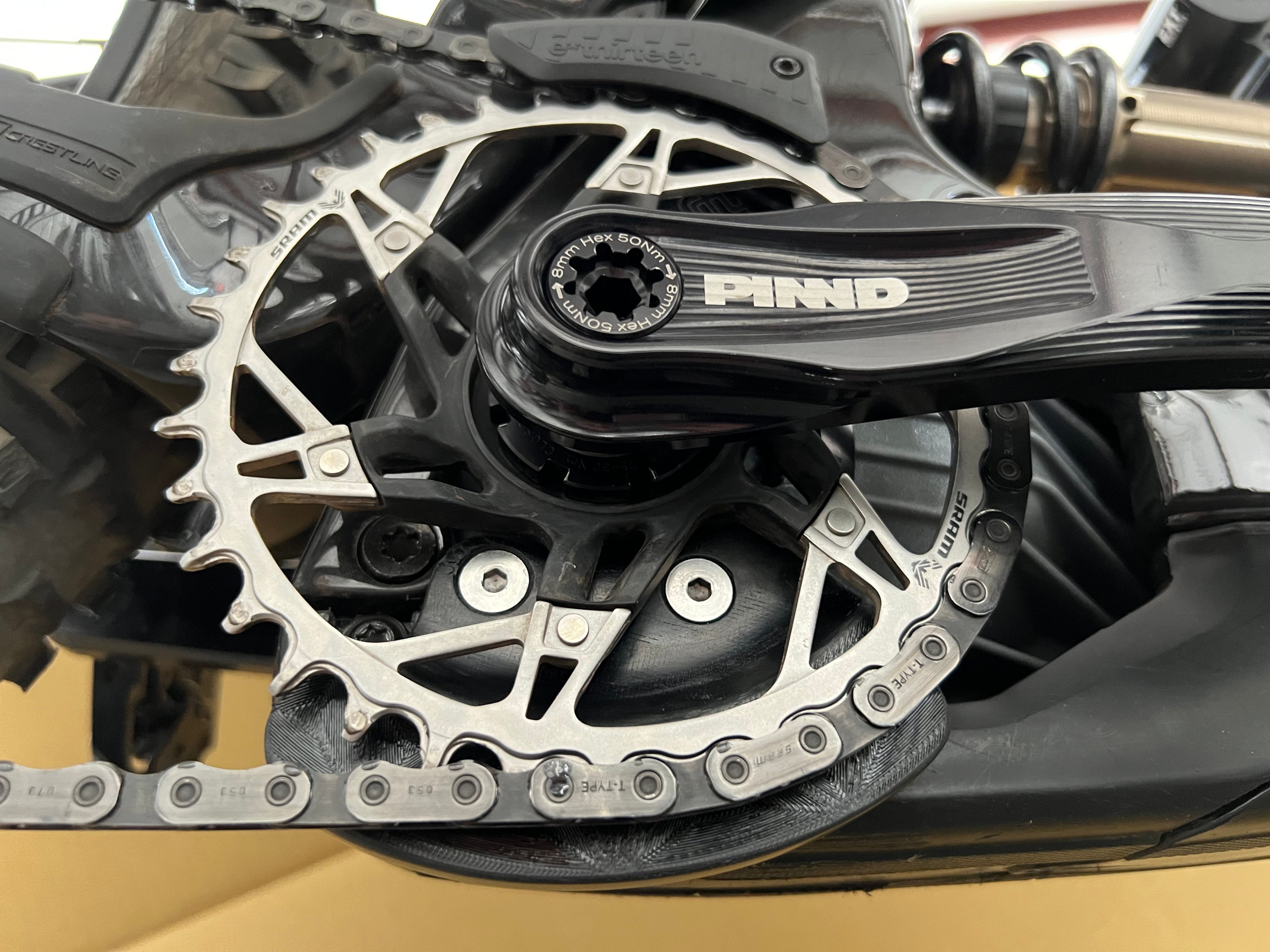

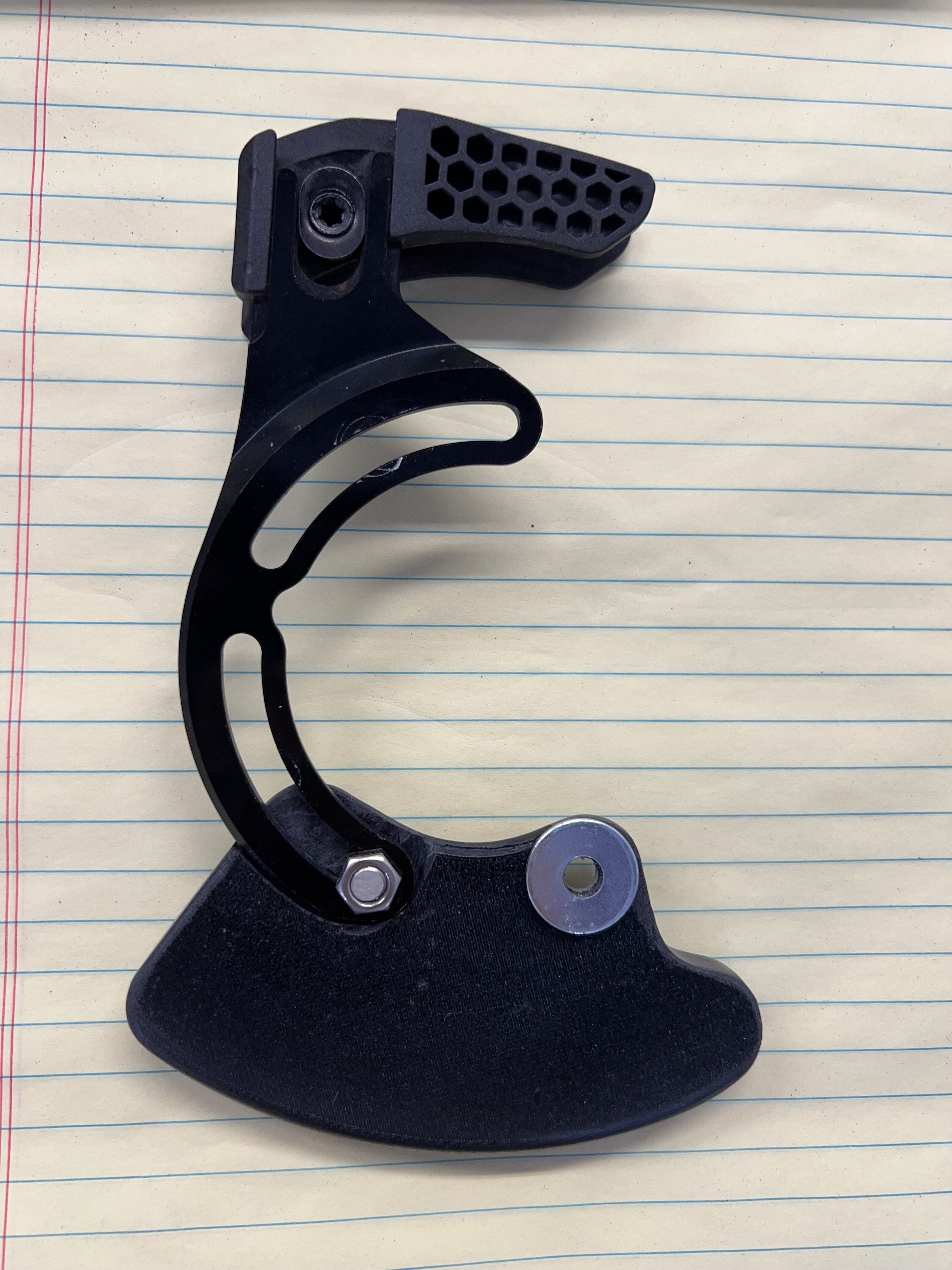

I ended up purchasing a 3Pinnovations printed BashGuard and modified it to bolt to my existing e*thirteen mount. The other bolt threads into an unused threaded motor bolt hole. Luckily I bought several of these bashguards and modified them all so I can replace as needed. They are now unavailable on Amazon, and my first one installed has already taken a few hits…..better than my chain and chainring.

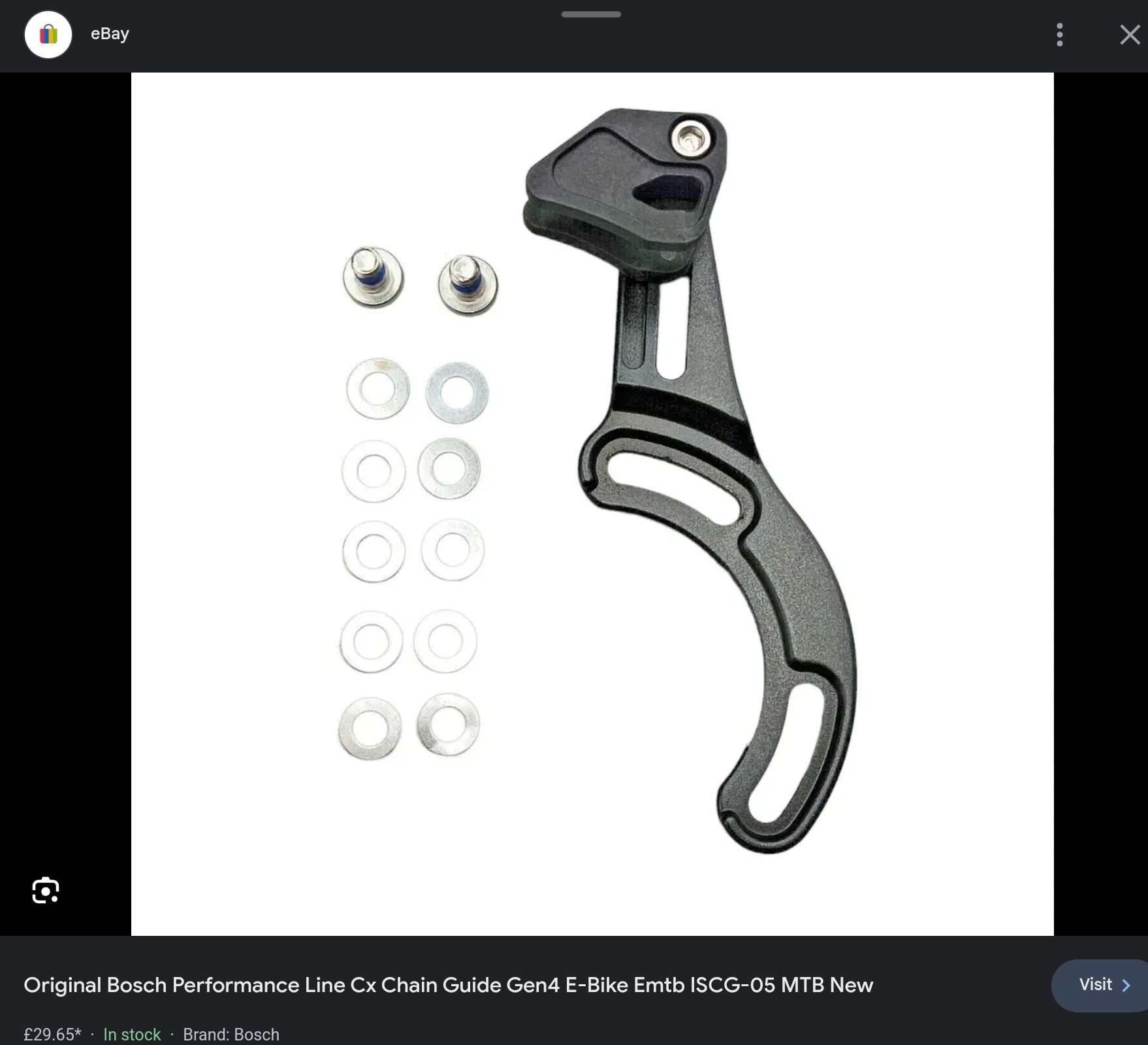

Found this it should fit the cube stereo it's the bend I need to clear my frame as wide over top of motor thanks for everyone's help
