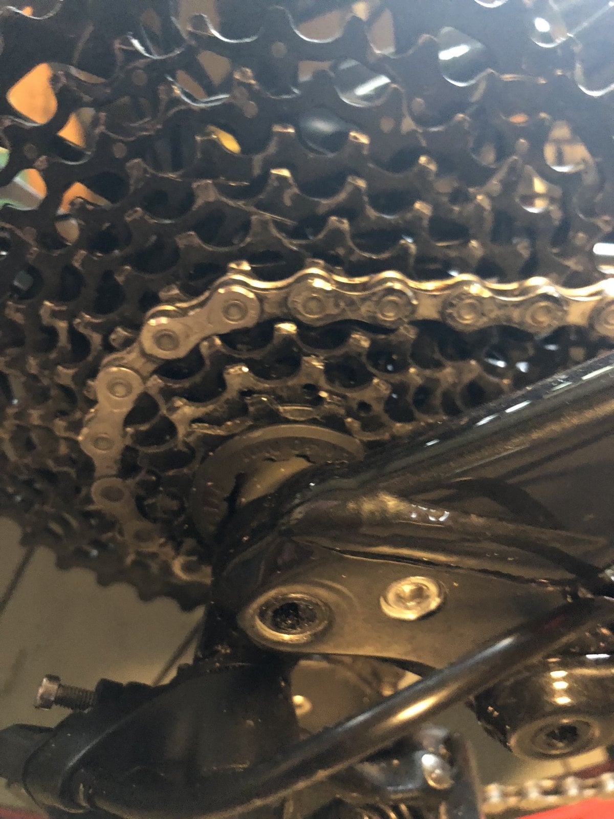

Update on the SRAM PC XX1 with hollow pins. I’m at 250kms with a really muddy last ride and the chain measures like new no visible stretch. I won’t get to excited but it is only 50kms behind the KMC ebike chain now and the KMC was on its last legs at 250kms. I’ll keep you posted. Also shifting is really good still.
Question what lube is everyone using dry or wet? I switched to wet for this chain as well.

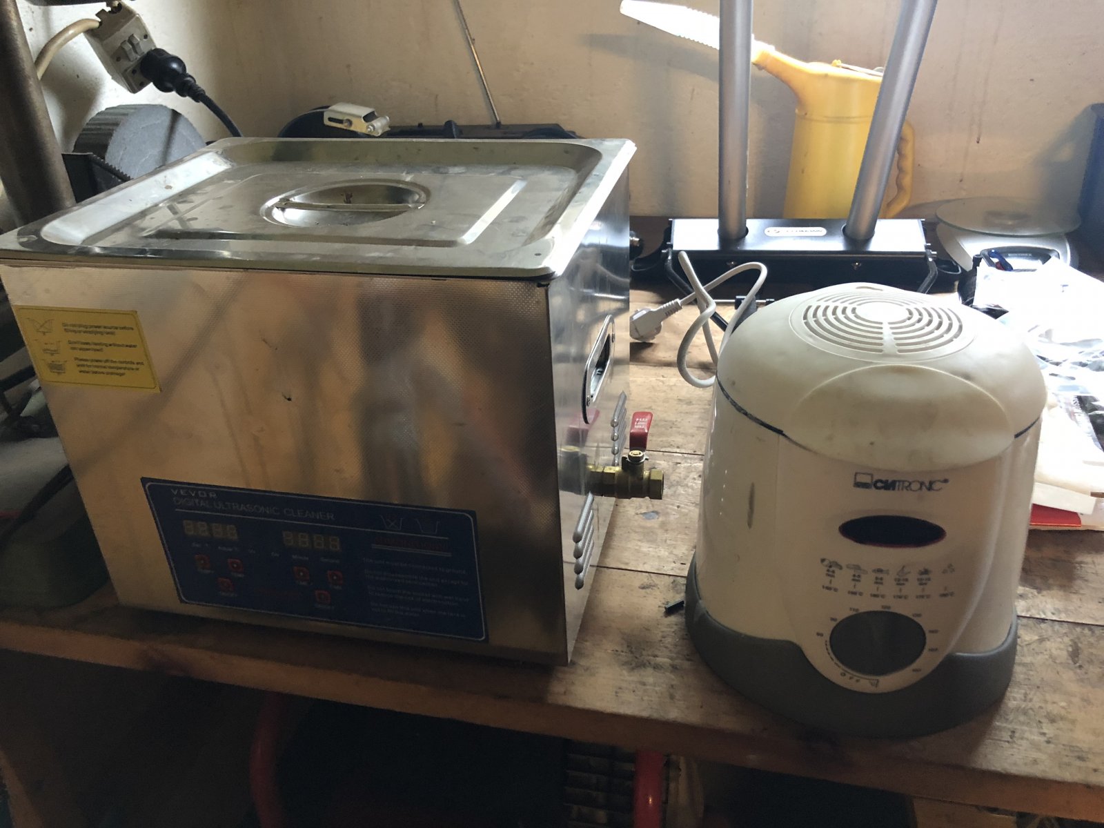

I do use wax where I initially clean my chain in a ultrasound cleaner and then afterwards melt my secret formula wax with the very clean chain inside for 30 minutes. It’s a bit extra work but I have 2 chains for my Levo and preparing one while riding with the other. Using this type of waxing the chain means that no dirt stick to it - this is how my chain looks after 100 km of wet dirty riding:
I’m on 300 km with each chain and no measurable wear so far.
My cleaning and lubing kit:

wow, that's impressive! Never heard of ultrasound used like this before, I've just watched a couple of youtube vids and its amazing!! how much does a unit like yours cost? and you cannot mention a secret wax formula without letting us in on the secret? :)
