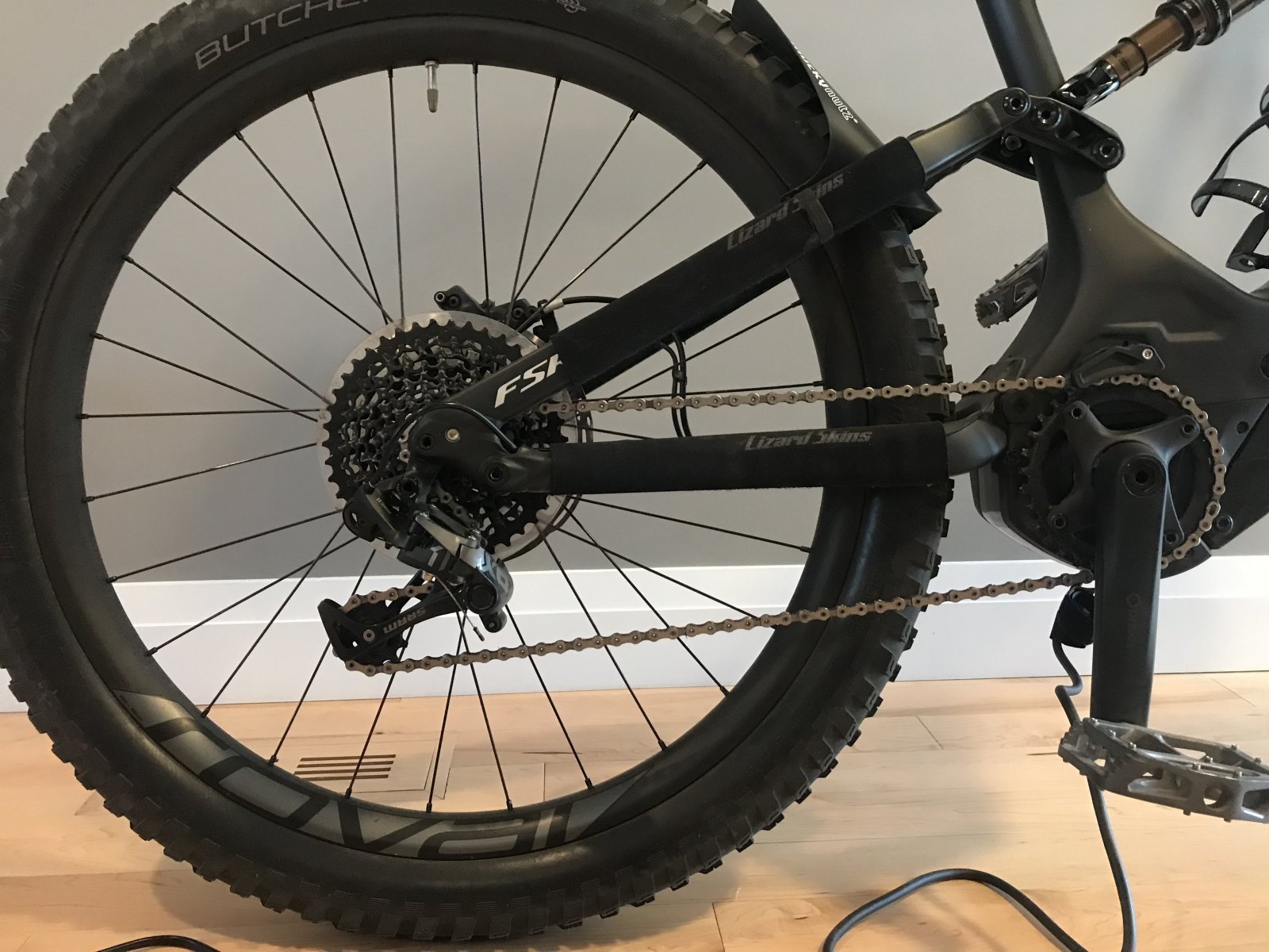

That’s great news I have a large Levo also and have run the 118 I was worried as this was two View attachment 2582 links shorter than the original factory chain, guess that may of helped the premature wear?
What size front chain ring are you running as this will have an affect on chain length. I’m running a 32 but have a 10-42 XX1 cassette fitted.
Could you possibly take the same photo with the chain on the smallest cog of the cassette? That will give you an indication if your chain is too short or too long or just right ?

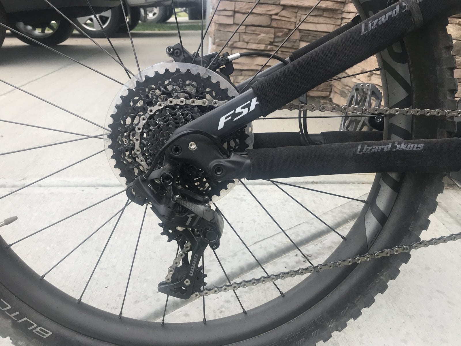

Sto
Stock front steel 32 rear 10-42 sram xg 1175
Mountie
Apr 29, 2018
421
254
Canada
Here you go
