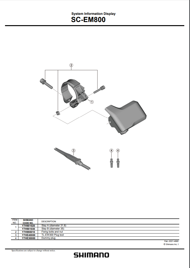

What display are you running? EM800?
You can search with those shimano part numbers.

Check your parts box that came with the bike. I believe my 2021 Spectral:ON CF 8.0 came with the clamp, tool and screws.

where can you find the Shimano display clamp so you can run normal bars?
What headset did you replace this with? I have a 2023 Spectral:On with integrated handlebar stem combo and so far I have not been able to get an answer from Canyon on what kind of stem I can replace it with, mainly due to the fact that they are doing internal routing of cables through the stem. I hate the fact that the handlebar is not adjustable and that you can't fit normal accessories on it (near the stem because it is not round).
