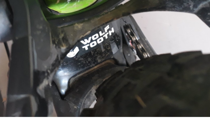

my levo expert 2019 has no sponge, but a plastic cap that seal the hole.

nope, any new levo have this plastic cap

This is not the location of the hole with sponge, you have to remove the wheel to clearly see it, it is below this plastic cover.
