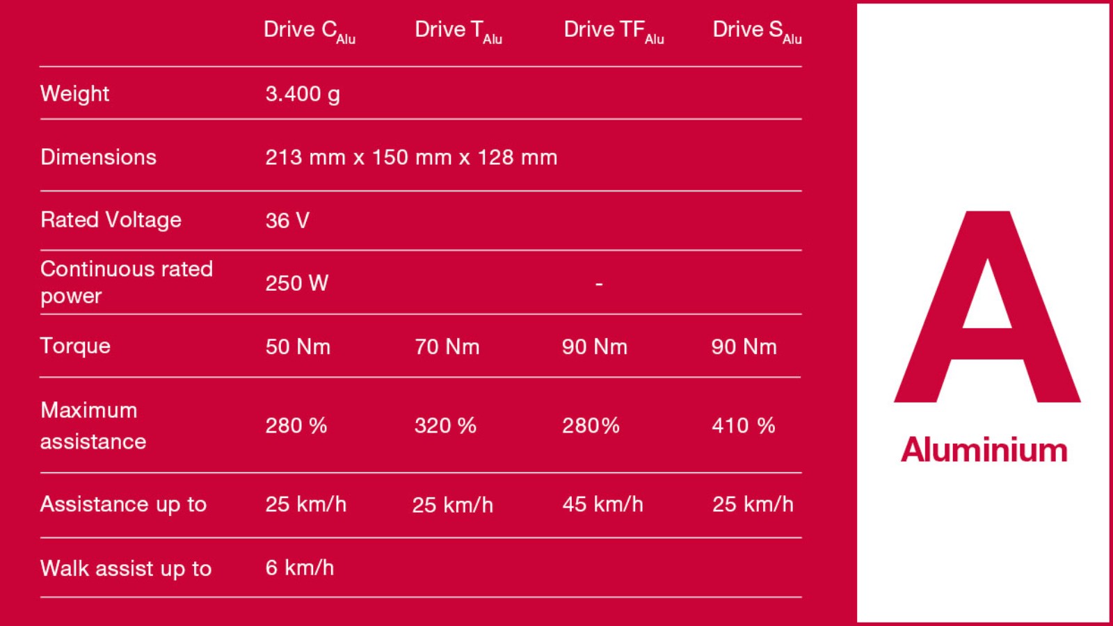

Thought this post might be worth resurrecting if anyone is interested.
The 1.2 and 1.2e have less plates in the motor windings and fewer armature magnet plates compared to the 1.3. The 1.2e is detuned for extra battery range, no other reason.
I have yet to see any of these Brose motors overheat. If you leave the heat sync pad off, it makes no difference and is not used with the same motor in any other bike.
This was a thermal image taken by @Zimmerframe after a hard ride and shows a top temp of 40.1°C. Not saying they don't get hotter than this but unless you're climbing a monster mountain in Death Valley, you probably shouldn't worry too much.
For accuracy on power and assistance, the specifications below on power and assistance are from Brose:
1.2e Drive C (E22243)
1.2 Drive T (C16162 - Later C91143)
1.3 Drive S (C97272)
1.3 Drive TF (C79232)
When comparing maximum torque, consider assistance and when/how that torque is used? We test ride almost every motor that we repair or overhaul and most drive T motors (70Nm) feel faster or more powerful than the Drive S (90Nm). The Drive S seems to have more initial torque but then drops down where as the 70Nm motors keep delivering.
We have not tested this scientifically yet, just all different motors in exactly the same bike over several years gives you a pretty good feeling.
Anyway, hope this helps.

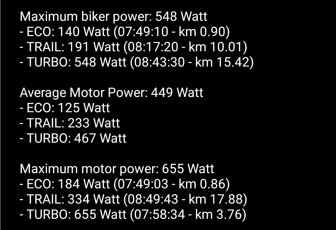

Hi all,
Not sure if any of you guys use Blevo but it supplies you with all the info (and much, much more) that you have been talking about In the above posts. Motor temp, Battery temp, Motor Power measured in Watts, and loads of other geeky measurements for the entire ride which you can view after your ride on your phone. If you want even more detail like Current draw measured in Amps, you can download the CSV output file that has an output measurement for every second of the ride that you can easily download and ‘geek’ over. I don’t know how accurate the info from Blevo is but I guess it will be within + or - 10% or better?
From the data I have the gathered from the 1.2 engine in my newly acquired secondhand 2019 Levo HT on ‘Turbo‘ mode I consistently get outputs of between 580 to 601 Watts of peak power with a Current draw of 15.2 to 15.4 Amps. Motor temp will go over 50 degrees centigrade if consistently climbing on ‘Turbo’ but so far I have never seen it go over 55 degrees. Also, I have noticed it is very economical even on ‘Turbo’ with a 400 Wh battery and if you flip it to ‘Trail’ mode or ‘ Eco‘ it is of course even better. The thing that I ‘really’ noticed is how quiet the motor is compared to any of the 2.1 and 2.2 engines.
My Comp Carbon 2019 Levo FS with the allegedly ‘improved’ replacement 2.2 engine on ‘Turbo’ mode consistently outputs between 710 to 723 Watts of peak power with a Current draw of 19.0 to 19.2 Amps. Now the next bit is interesting as it could be due to the carbon frame not being the best at heat dissipation. Heat definitely increases on these engines. On ‘Trail’ mode if you are continuously climbing it will creep up to nearly 60 degrees. On ‘Turbo‘ mode I have seen it exceed 70 degrees which is why I have asked @PaoloBLEvo if he could add motor temperature to the voice alerts on Blevo so I can back off if it starts to hit a scary motor temp as I carry my phone in my body armour so I can’t see the display.
The question I have for @Specialized Rider Care is what is an acceptable motor temp and what temp range should we be trying to keep within? Is this possibly a reason why some motors have been failing and are still failing? I do not know what damage a consistent 70+ degrees will do to an engine or belt so your feedback or anyone else that knows about heat limitations on electric engines in ebikes would be much appreciated.
Maybe the heat output is not so high on the engines in the aluminium frames with the 2.1 or 2.2 engines in them but I do not have one to give you the feedback on. It would be good if someone who has Blevo and an Ali framed 2019, 2020 or 2021 could do some testing and feedback their numbers to compare?
I have a 1.3 engine which I purchased from Berks cycles a couple of years ago as a spare which I am going to drop into the HT to see what the temps are like continuously climbing on Turbo mode. I can only presume it is going to rinse the 400 Watt battery in just over half an hour as I know I measured the 1.3 engines output when I first got it and it was putting out figures of 740 to 750 Watts and a Current draw of 20 to 20.1 Amps.
Anyway, hope the above info helps and I will feedback what I capture on the 1.3

Hi all,
The question I have for @Specialized Rider Care is what is an acceptable motor temp and what temp range should we be trying to keep within? Is this possibly a reason why some motors have been failing and are still failing? I do not know what damage a consistent 70+ degrees will do to an engine or belt so your feedback or anyone else that knows about heat limitations on an electric engines in ebikes would be much appreciated.
I have a 1.3 engine which I purchased from Berks cycles a couple of years ago as a spare which I am going to drop into the HT to see what the temps are like continuously climbing on Turbo mode. I can only presume it is going to rinse the 400 Watt battery in just over half an hour as I know I measured the 1.3 engine output when I first got it and it was putting out figures of 740 to 750 Watts and a Current draw of 20 to 20.1 Amps.
