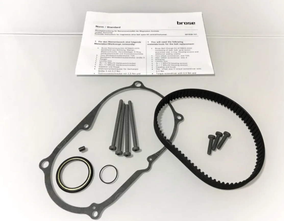

I would open motor, could just be a belt failure you can purchase the belt for a $100.00 from Germany.https://youtu.be/DkK7mkNRfdI {} Hope this works out!

Yes, the replacement kit is the way to go and it's available between $100-$200 and the replacements is quite easy I think. Here's a photo of the kit. Guys who offer this can also replace the parts if you send them the engine.

Thanks for the advice. I didn’t get any loud noises or bang - one minute I was getting assistance, the next the motor just whirred & no forward momentum. Waiting on Specialized at the moment but the plan is the open up the motor & see if I can see what the problem is before deciding what to do next.
If you're now in that limbo state, once you open it up if you mail Performance line or put the pictures on here and tag @Bearing Man , I'm sure he'd be happy to help you in the right direction ..
