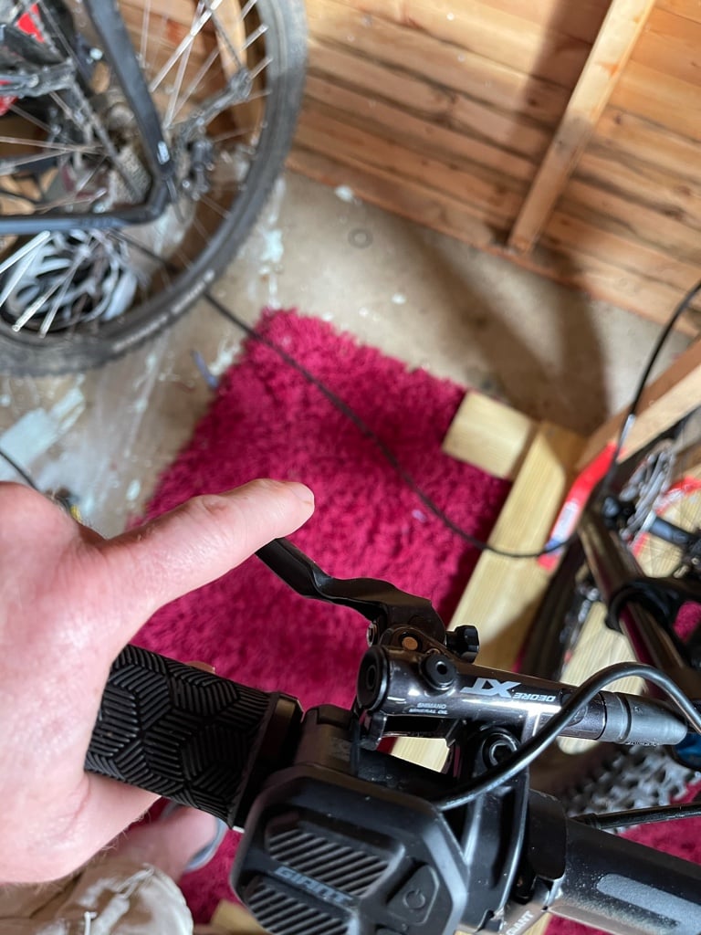

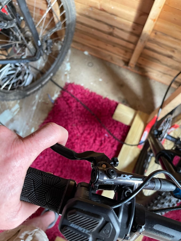

@JoeBlow Ref my post#10. In response to your concern at "about an inch of play" I said that I thought my levers were about 15mm. I have finally remembered to measure them. With both brakes having had new pads in the last week or so, and being 100% happy with my brakes and braking, I discovered that the free stroke measured at the tip of the lever is ....25mm! It then takes a further 10mm to get a hard lever. That may go up by a few mm in a really hard full-on emergency adrenalin -powered stop! Both brakes are the same.
Either we both have something to worry about, or neither of us do. (I'm opting for the latter). :)
I think many of those who have doubted this will also be surprised if they actually measure the travel on their brakes.
