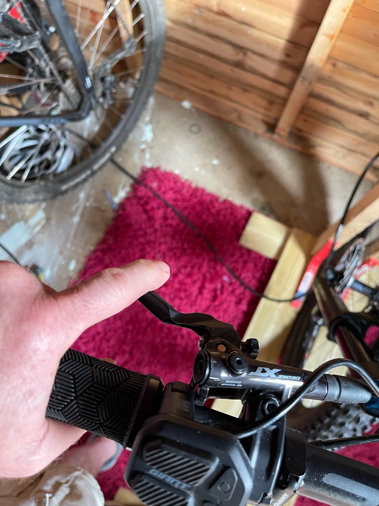

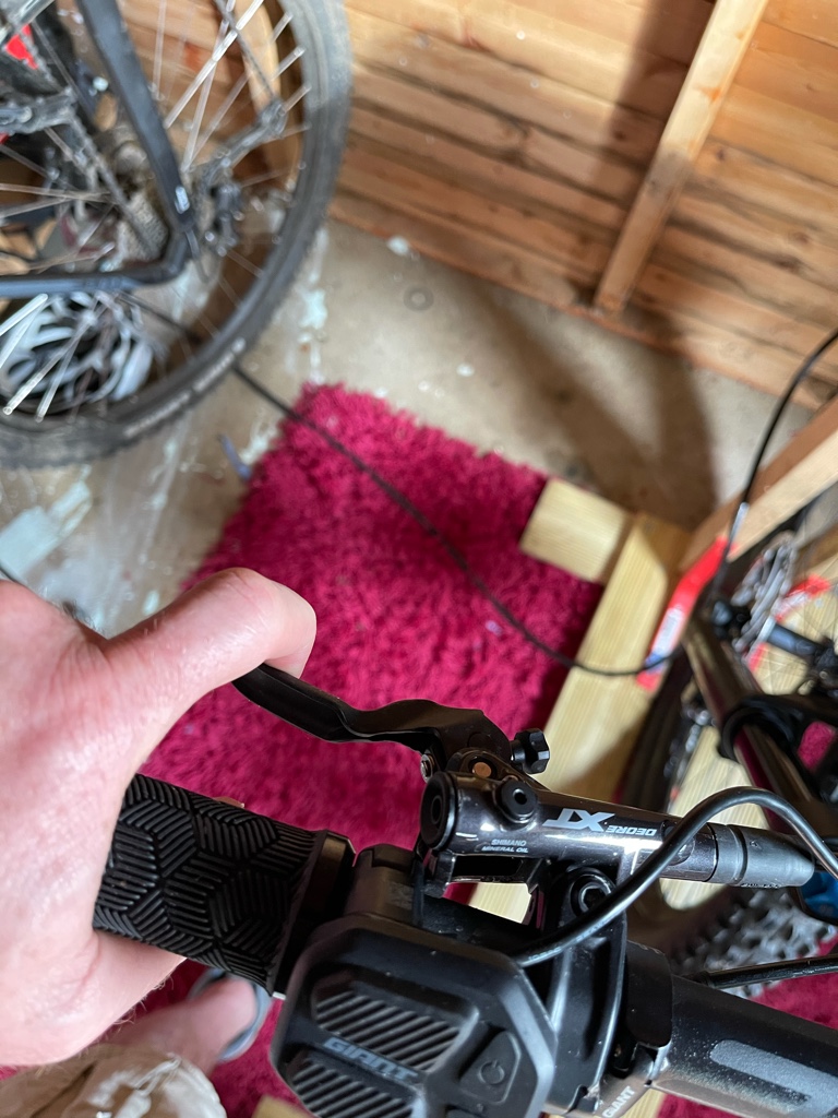

I’ve never really given it much thought but you made go out to the shed to see .
Mine don’t move quite an inch, about 3/4 of an inch.
When descending I just have my finger resting on the lever permanently, as in pic 1. All other times I am holding the grip with all 4 fingers.
3rd pic is to show the angle on the bars.
I also have them at the maximum/furthest away from the handle bar setting so it’s just the end of my finger activating.
