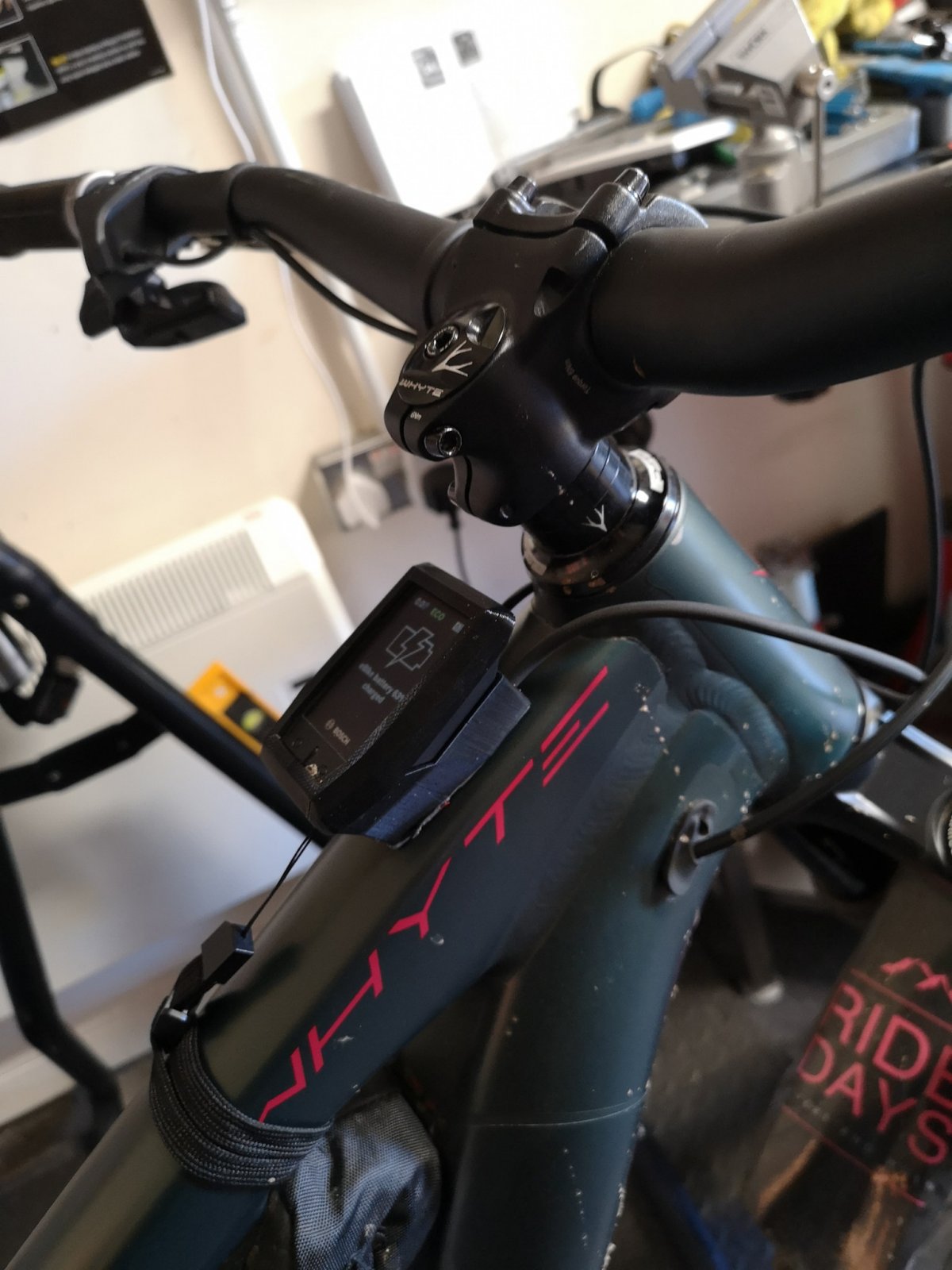

I fitted the Kiox myself. Easy 1hr job with no reprogramming involved. The mount i use is from ebike prints and works very well. I have had a big crash where i broke the trigger switch but it was an easy fix, had i been using the purion it would have been destroyed i'm sure.
I love the extra displays and the connectivity with your phone to record rides and then upload to strava etc.

Gogsie, I take it you feed the Kiox cable down through the frame to the motor. Does it go through the frame grommet OK?
Open this link and in the posts you will find a "How to.." that I wrote for the upgrade. Kiox fitment. - EMTB Forums
The grommet is probably the hardest part and I ended up replacing mine (they are sometimes cut in the middle by the bike assembler and split when trying to get the Purion connector out).
Yes it does, just follows the purion cable route, It does go through the grommet, lots of lube and patience and its no problem.
View attachment 59783 View attachment 59784
Looks good, but why not mount the display where the centre cap is, and move the controller up out of harms way?
Because then the display would then be in the firing line when i crash and i don't fancy it pounding into my chest if i go over the bars, the display is £??? to replace the controller is £50.

@Tribey I'm not in as much danger as @gogsie so currently have mine mounted on the stem but going to fit the Cube handlebar mount soon. Unless you have the display screwed to the mount it shouldn't get damaged as it is designed to breakaway in a crash and technically the only part that would break if would be the mount itself. To prevent accidental loss of the display use the tethering hole on the display to tether it to your bike with a lanyard.
