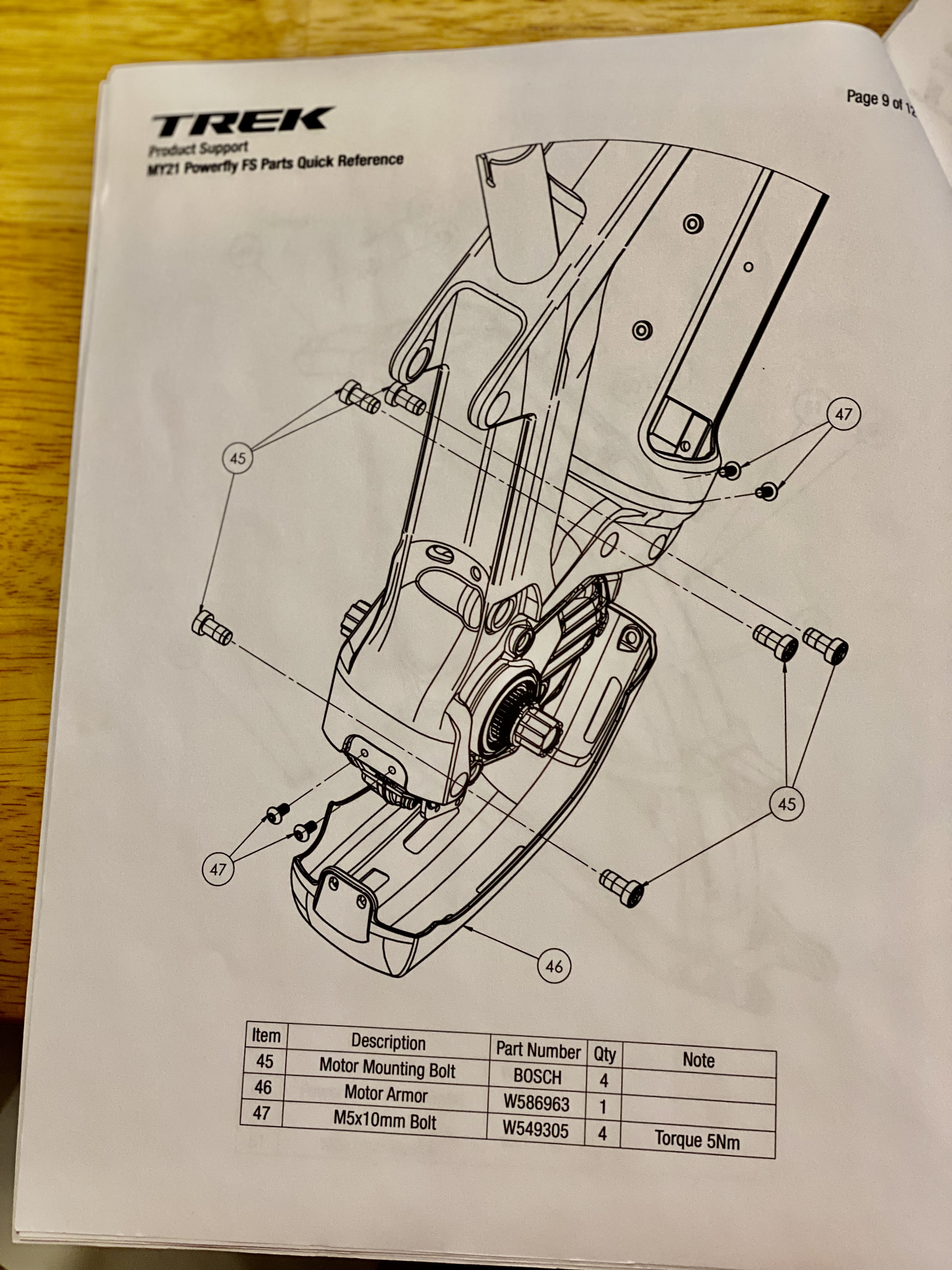

I emailed a website that rebuilds/reconditions these units sending him the diagram highlighting the bolts and the reply was 20nm 🤯 personally I'm not seeing that size bolt take 20

20Nm is for the big bolts that go through the frame into the plates (No54 in the above pic) and that is for aluminium frames.
The smaller bolts should be 6Nm and all bolts loctited.
(coming from the Cube area and a carbon frame 11Nm for big frame bolts, 6Nm for plates to motor)

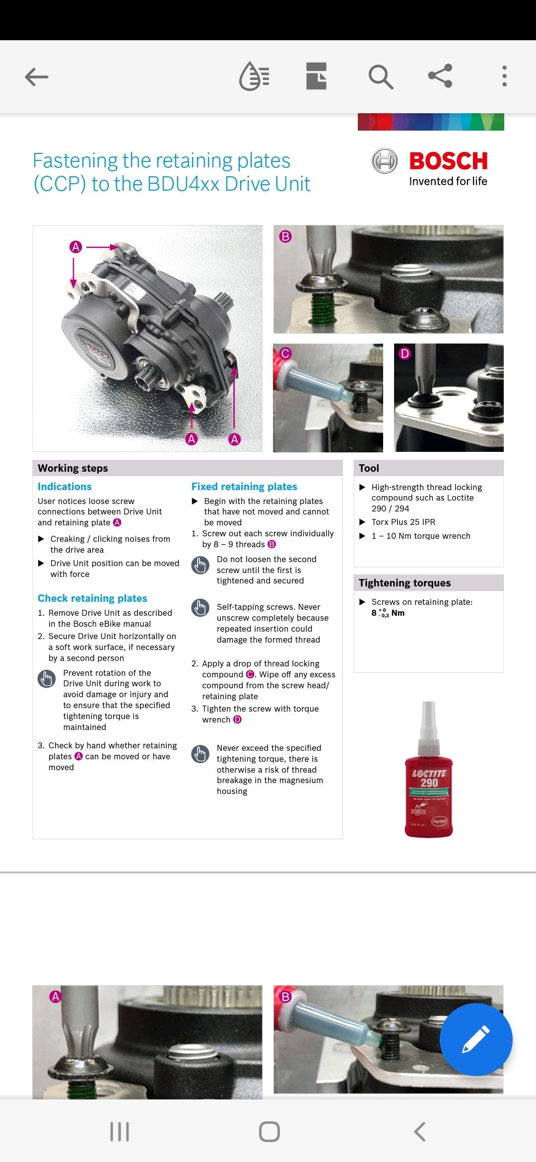

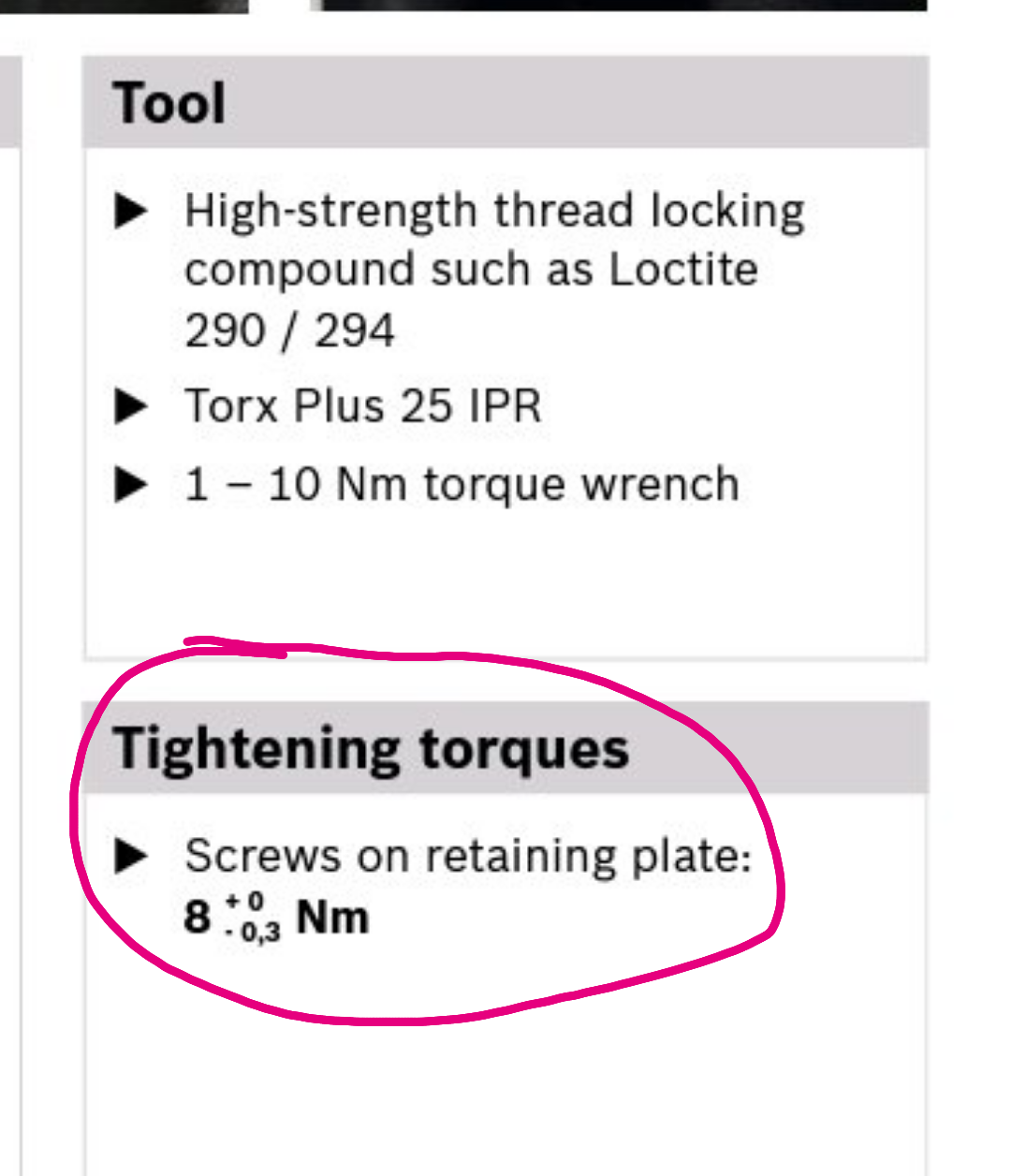

I happened to come across this so I'm hoping the stated (8nm) is the magical figure.
@Bearing Man is the kind of manual you got the 9.5nm from?
No, what you have found is the paper sheet that comes with new mounting plates. I am gobsmacked that they tell you that you will need a 1Nm to 10Nm torque wrench, but then don't tell you what torque you should tighten it to! 🤪

That may be it then. In those instructions the bolts mentioned are t30 m6 where as the other on the heads are t25 m5. Not sure why 2 different size bolts are being used but seems logical the smaller would have a lower torque value.

I did it yesterday. Undid screws one by one, slapped some Loctite on and torqued up to 8nm. The weather is horrendous today so will test out tomorrow. Plus wasn't sure how long that Loctite would take to fully set.
