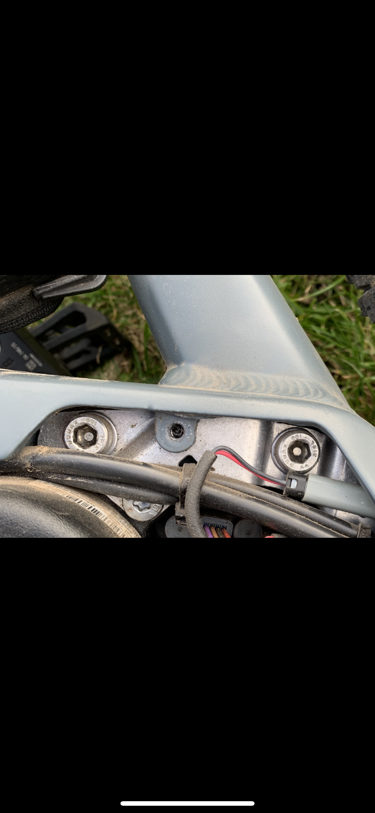

Beekeeper
🍯Honey Monster🍯
Aug 6, 2019
1,751
2,199
Surrey hills
After years of no creaking after tightening up the motor bolts (gen 2 Bosch) the dreaded creak returned the other day. The two large bolts shown here were loose. Tightened these two back up to 24nm (the limit of my torque wrench). I’m guessing over time the aluminium compresses and these need tightening up eventually.
