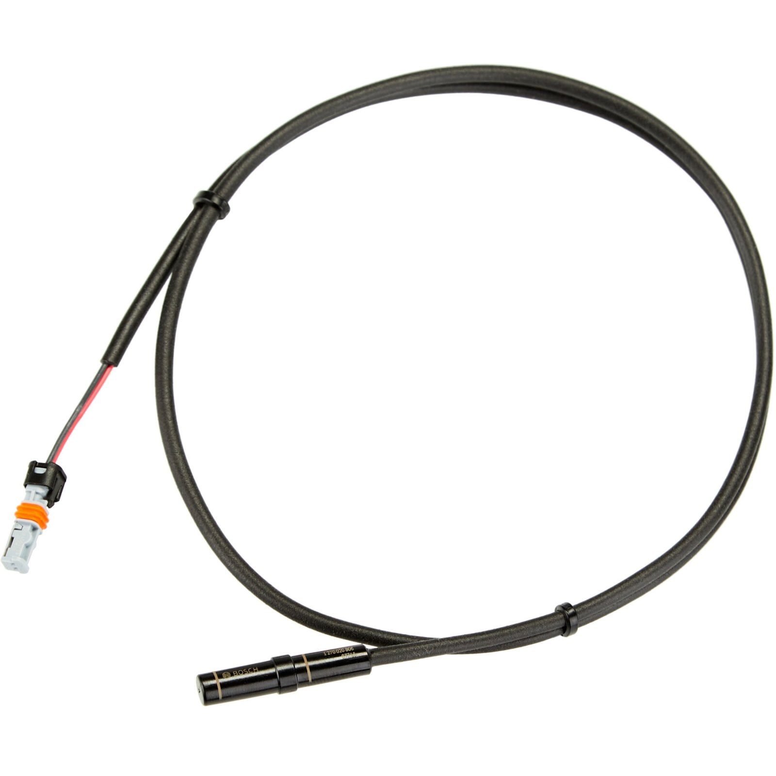

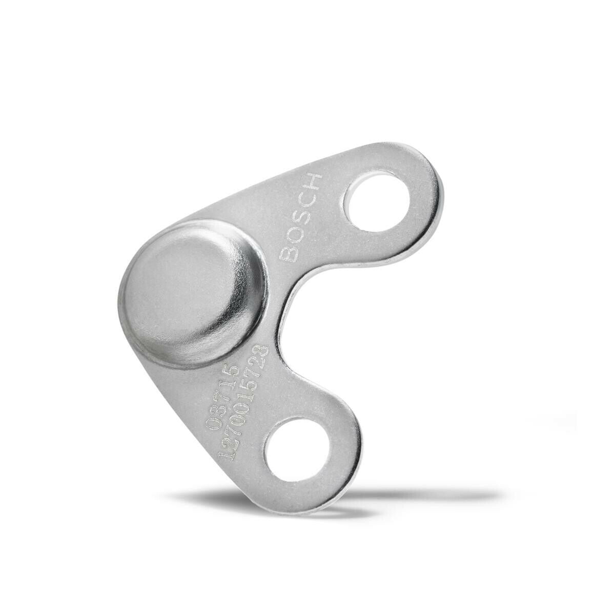

I mount the slim speed sensor and the appropriate magnet.
I have had the electronic diagnosis done several times and the chip I had installed never resulted from the diagnosis. I have now ordered a new sensor and magnet and they must arrive.

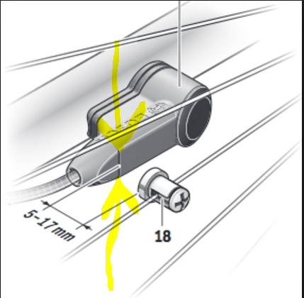

A 503 error is a speed sensor error, usually around the magnet becoming misaligned with the sensor. Bosch recommend the magnet should be spaced between 8-14mm from the sensor. Your bike is the same as a Decathlon Stilus, so the magnet is mounted on the spokes. I would look there first.
I have also seen on here a guy who had ££££ of warranty work done chasing the same error only to discover the speed sensor wire wasn't fully pushed in to its connector at the motor.

Today I try to check the wire harness to the engine. For the sensor I mount a different one and the magnet is screwed onto the disc with 2 screws. It cannot move.

The line and distance are important, had some 503 errors here, distance was to big, lined it up with a 5mm gap, but after some months 503 again, changed the gap to 11mm and no more 503's.
