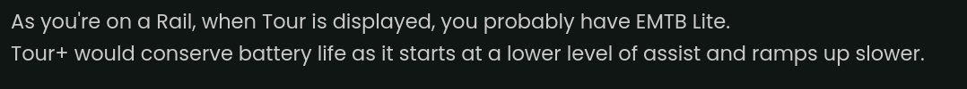

On a positive note, at least we know you have Tour+. You're not broken. Your bike isn't broken and you have Tour+ which I'm sure you'll grow to love.

I guess I have Tour+, which doesn't conserve energy... ?
eMTB Lite would do that, by NOT providing full power.
I'll try to get rid of it :)
It depends how you use it.
Tour is fixed at 140% of assistance, with a torque limit of 50nm - but generally feels like a flat line of assistance, but with too much for going steady.
Eco has a fixed 60% assistance with a torque limit of 40nm
Tour+ has assistance starting at 60%, so compared to just running in tour, depending on how you're riding, you could conserve energy compared to using just tour. Lets say for example you were riding and it assisted between 60% and 120% - you'd use a lot less battery than riding at a fixed 140% assistance.
eMTB lite may conserve you energy compared to tour+ of you were riding harder as it only gives 140%-250% ? But tour+ gives you a wider spread. Most people prefer Tour+ over emtb lite, but we're all different so not everyone.
Your dealer should be able to switch your tour+ to tour if you want it.
