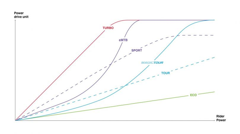

As per the graph above that Zimmerframe posted, Tour+/Magictour does give you full power if the rider pushes it hard enough.
For me as per the graph why does Tour+/Magictour need to reach the same peak as EMTB and Turbo, if it peaked at say the old "sport" level and had a less gradual climb I would be happier.

With all respect, you keep saying this but they don't. Even if you have the legs of Chris Froome you won't get 85nm of assist out of Tour mode. If you do, then yes you have a problem.
The graph that Zimmer posted tells it exactly how I feel it on my bike eg on Tour the peak assist is way below what Turbo and eMTB can offer.
I appreciate that the graph doesn't show any flatlining of the Tour, Eco or Sport modes (like eMTB, Sport and Turbo do) but that doesn't mean they just keep climbing, it's just because the graph isn't as clear as it could be.
Perhaps rzr meant Tour+ which does give full power.
