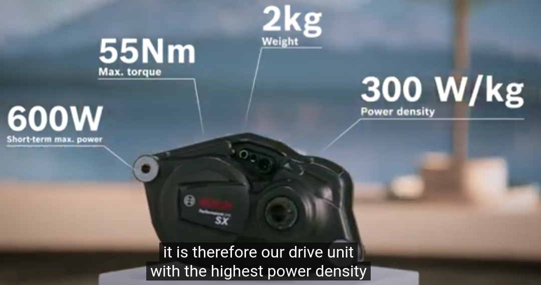

400wh battery (2kg !!)
55nm motor, but the relevant bit is upto 600wh power ! Way more than the other Light weight motors .. Semi Skimmed with some extra fat ! (2kg)

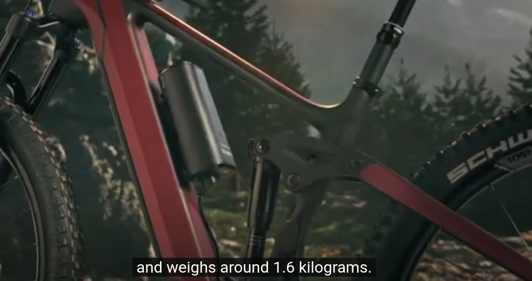

250wh Range extender - 1.6 kg

A 250Wh range extender *sounds* nice but - if i can be really picky - the unit is perhaps a bit big? I like my 1kg, small-bottle-sized, Levo SL range extenders, and at 160Wh i have never needed to use more than one of them. I’ll wait to see how well integrated the mounts are for these, because it doesn't look like they can be carried in an actual bottle cage.

New bosch SX is a lot lighter:
Bosch SX
2KG motor
400Wh battery 2KG,
Total system weight 4KG (3.2KG lighter!)
