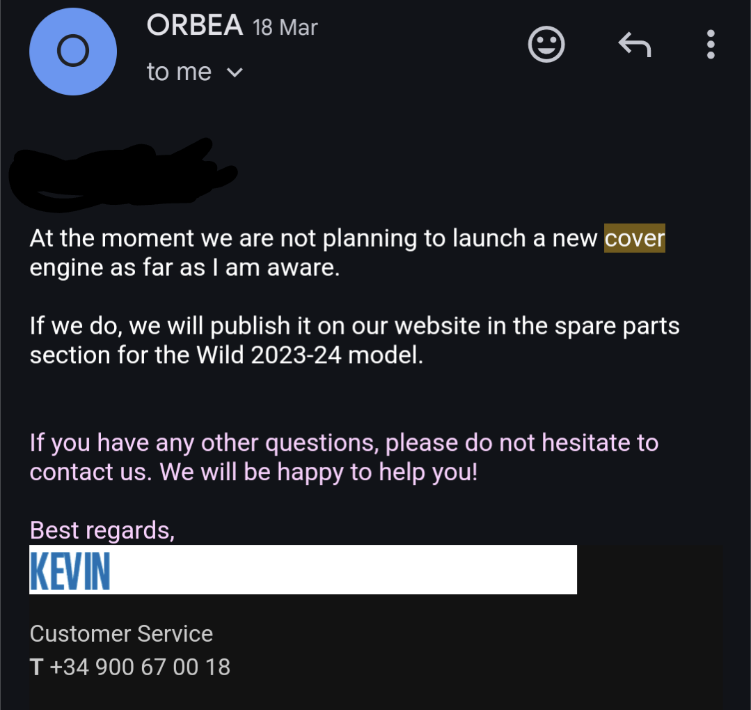

Interesting to see how/if you are able to get this to work. I have asked Orbea about a motor cover that would allow fitting the connect module, and got the below response.
Keep up posted on how you get on! Good luck.

Well I had a response from Orbea - as expected - lame!
I mailed back and pointed out their competitors such as Cube do indeed offer an alt cover to accommodate the module and they should follow suit .....
Thank you for contacting Orbea and for the trust you have placed in our brand, Nick!
Regarding your query, the Bosch Connect Module is compatible with the motor and electrical system of your Wild, however, the Wild frame and motor protector do not allow the installation of this component.
We apologize for the inconvenience, and recommend that you consult with your official Orbea dealer or with the closest one in your location about smaller anti-theft systems that may fit with the motor protector or frame of your bike.
We thank you again and invite you to contact us for anything else you may need.

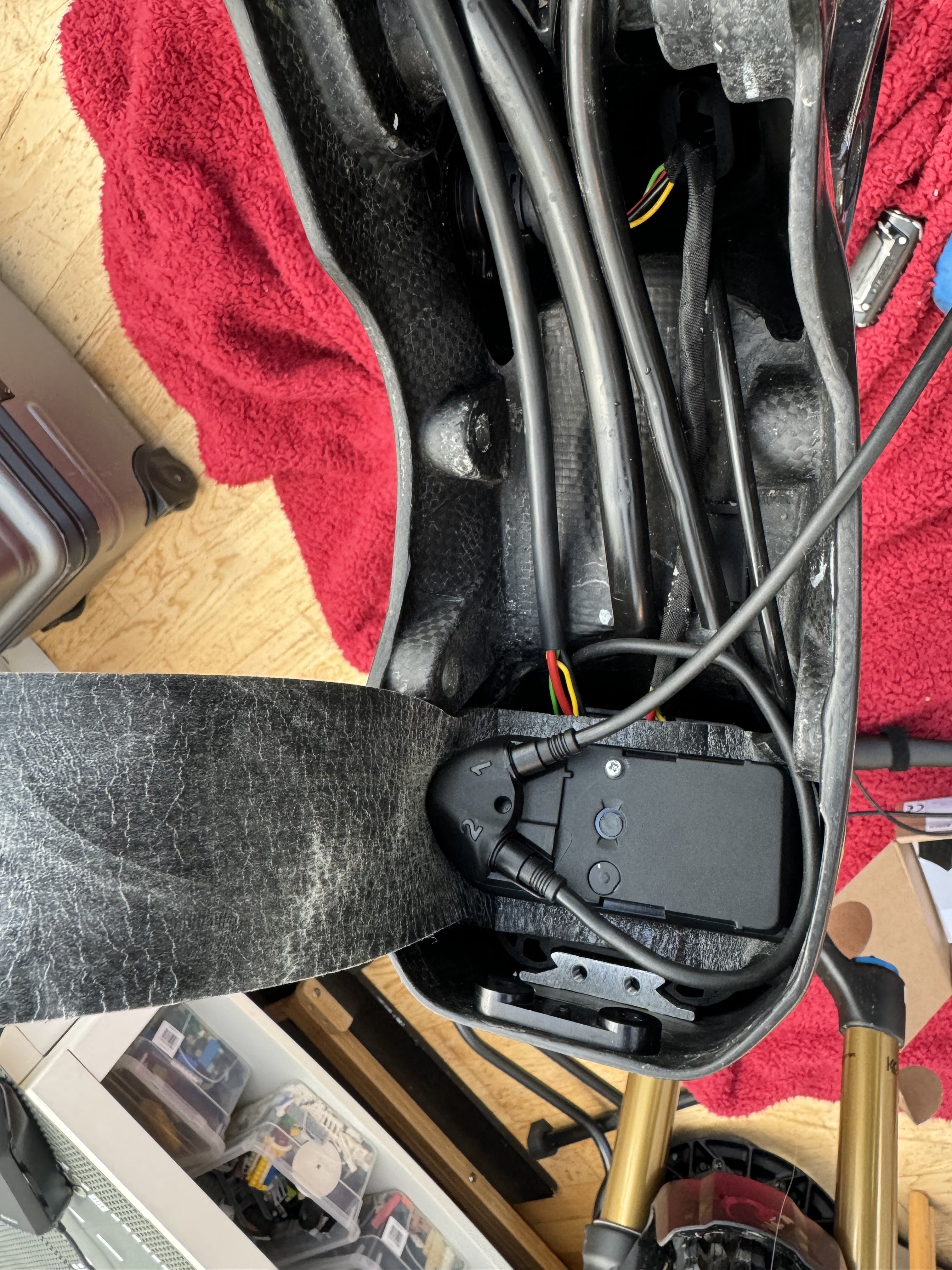

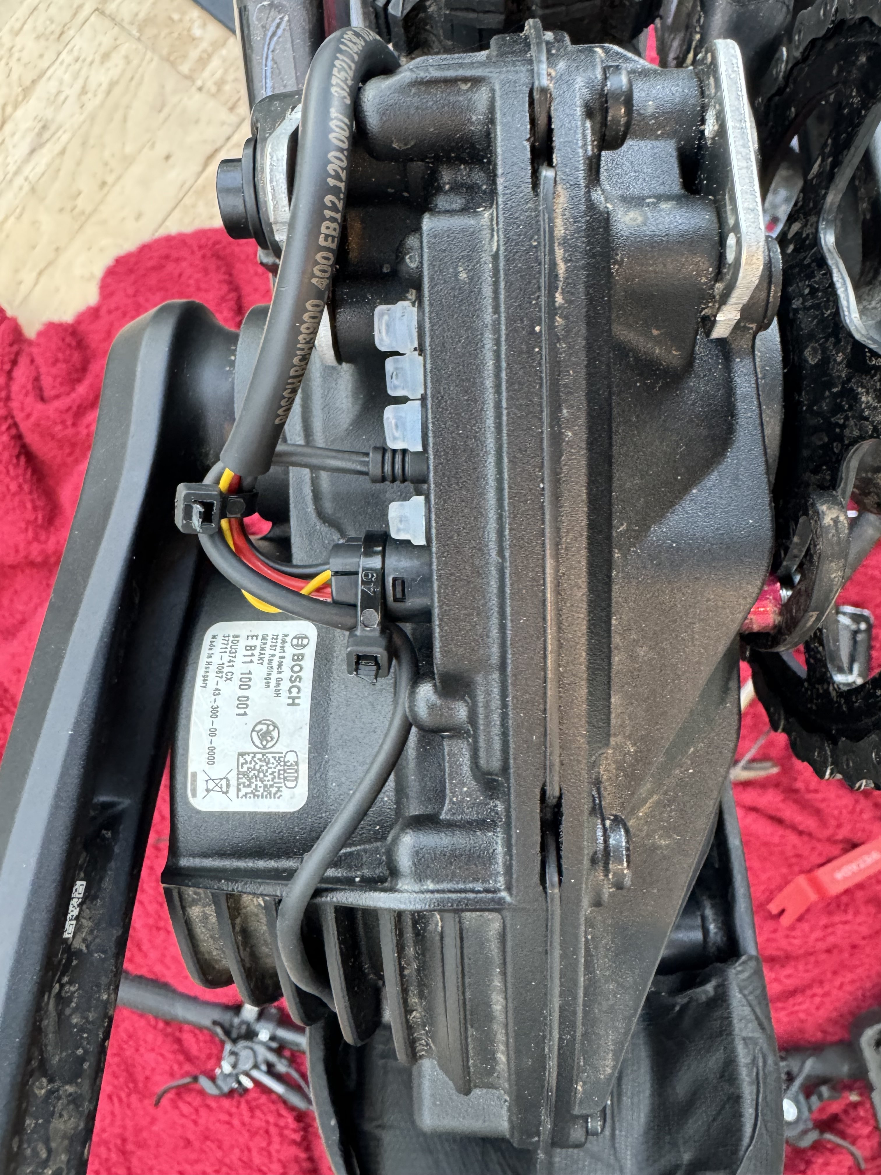

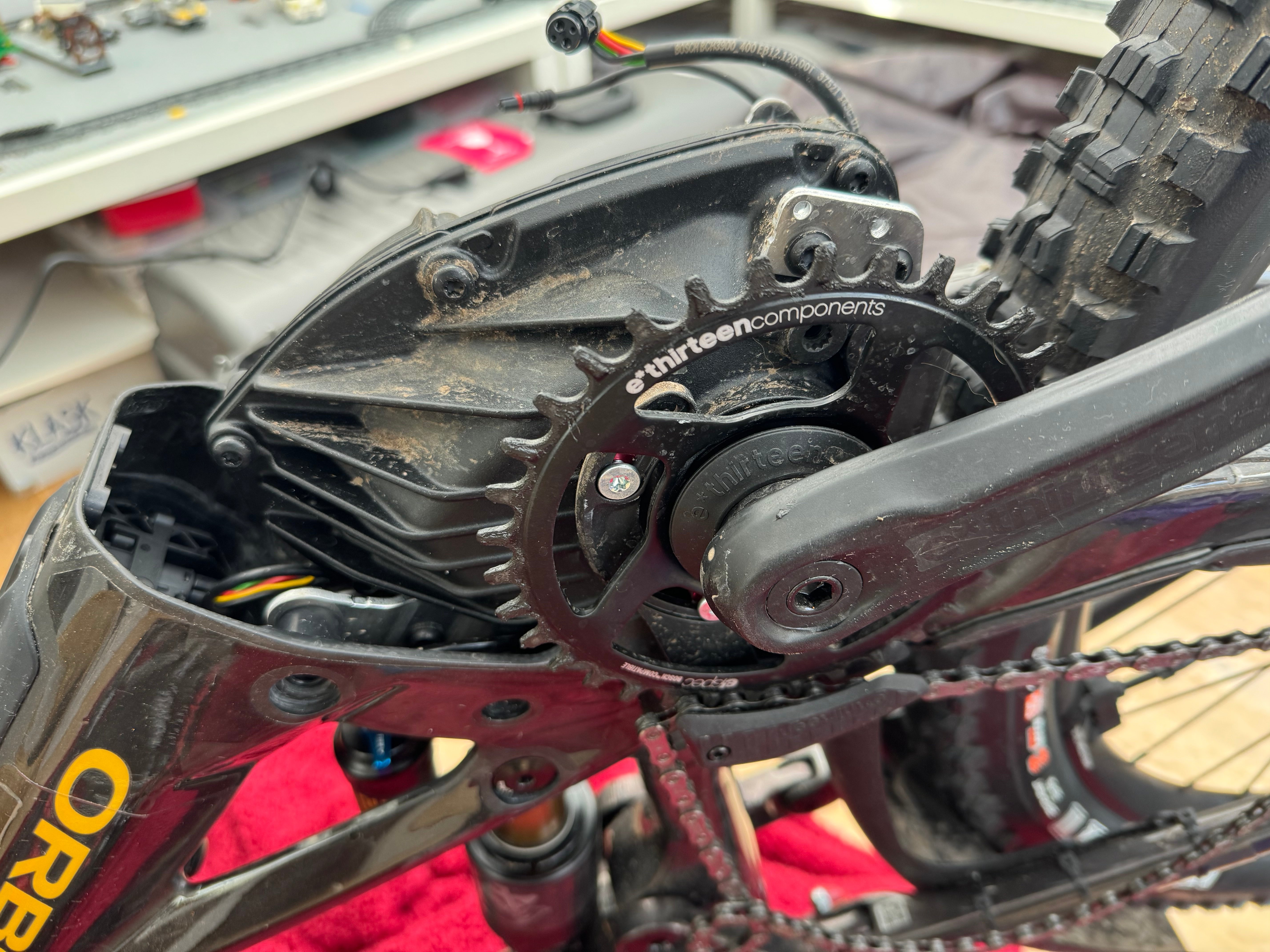

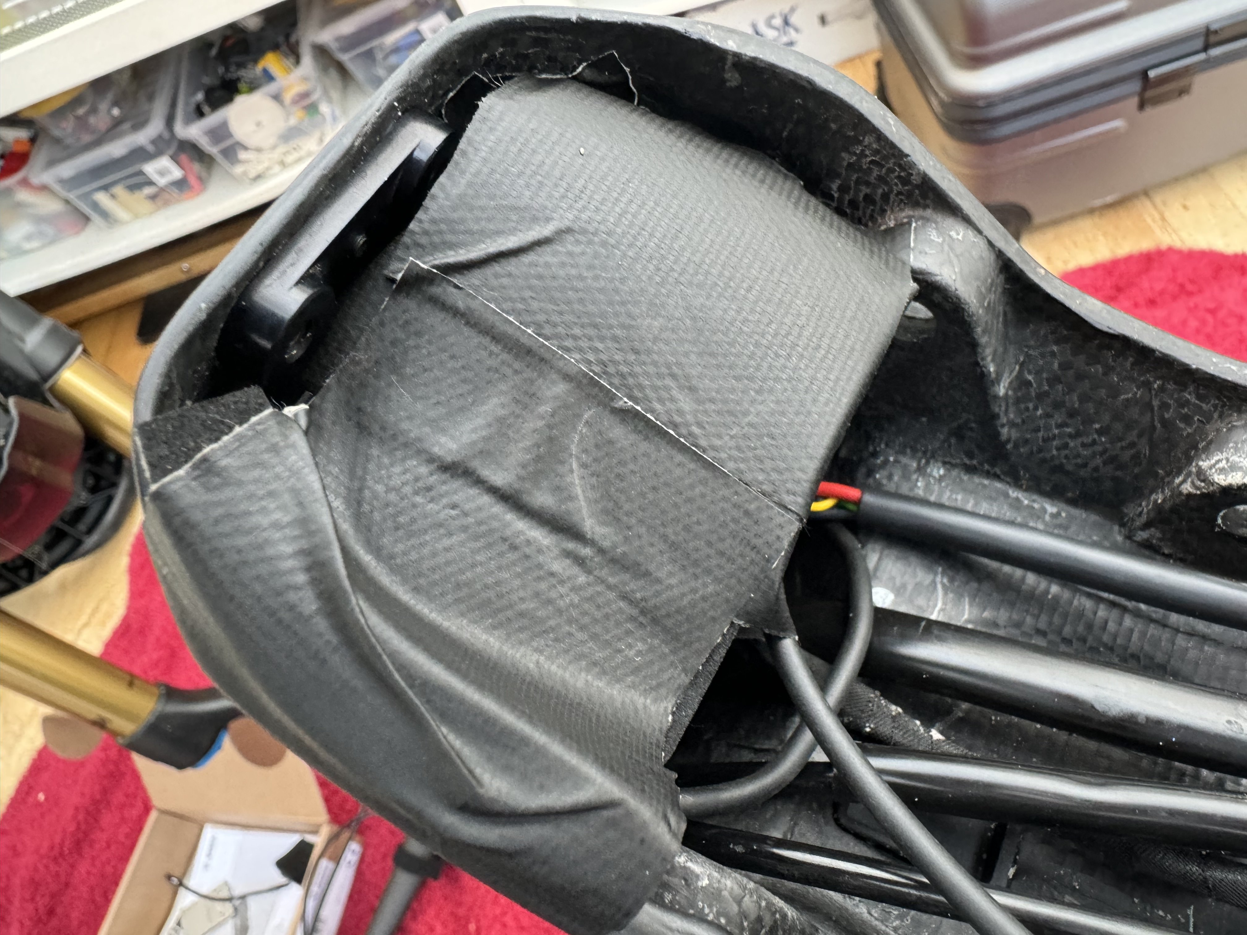

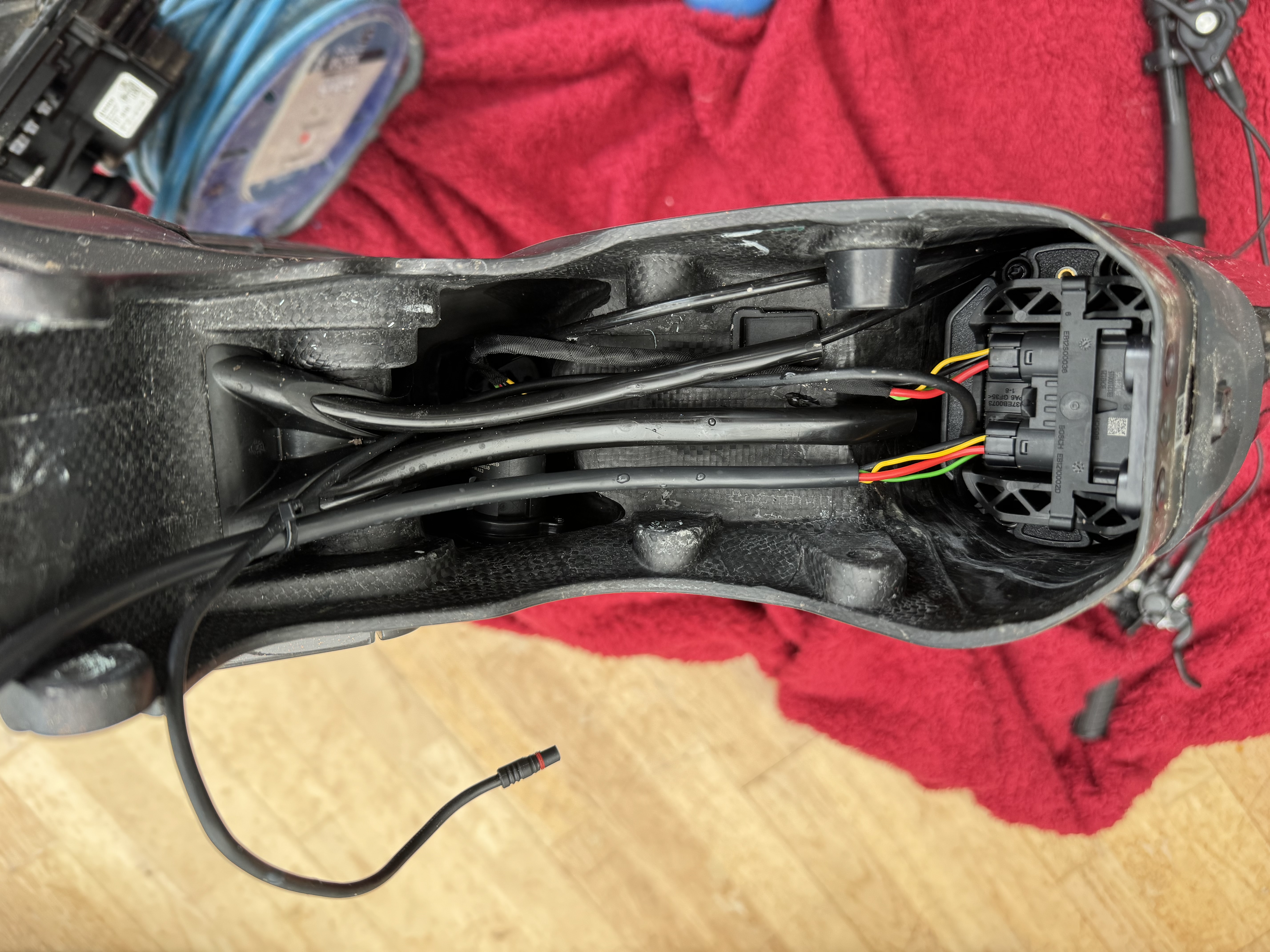

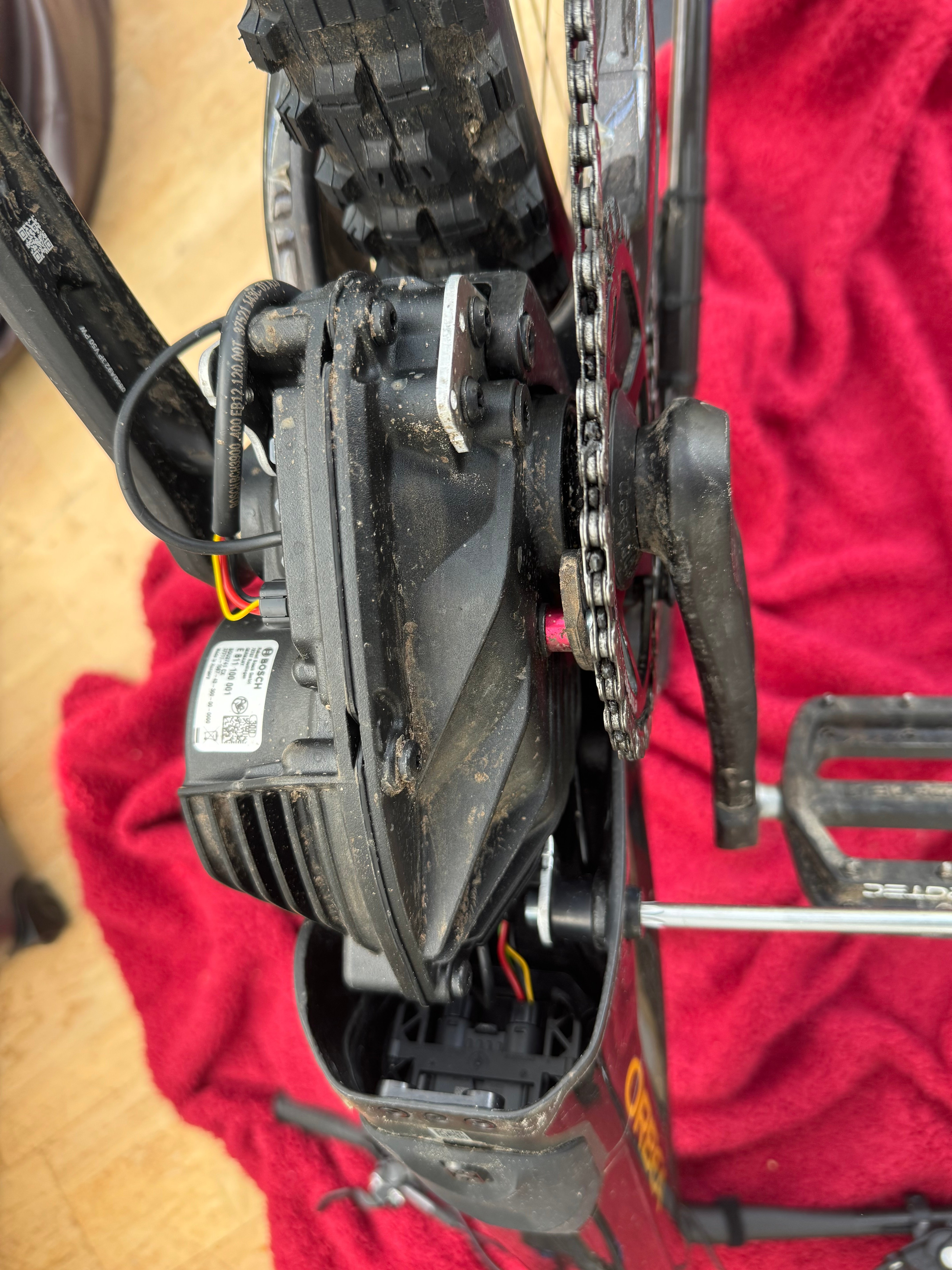

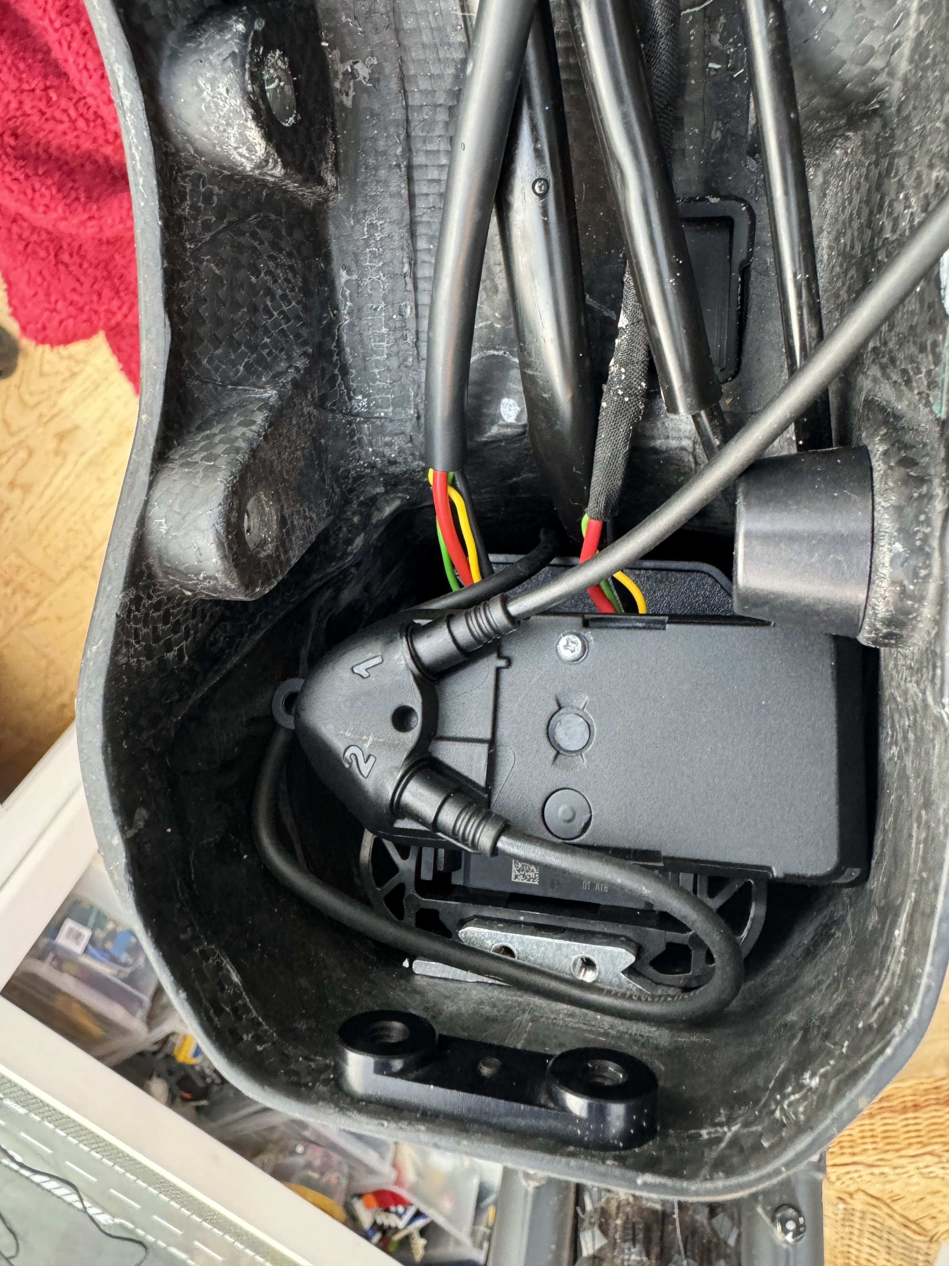

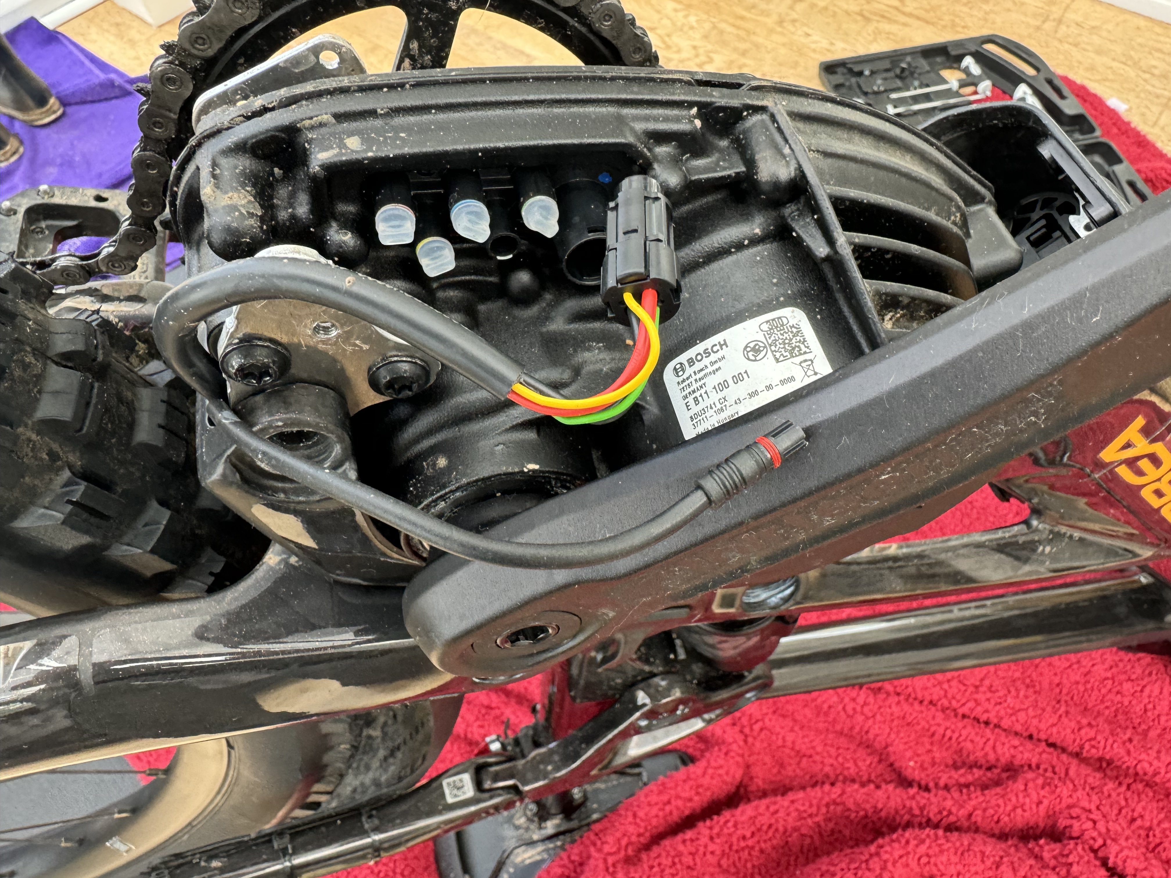

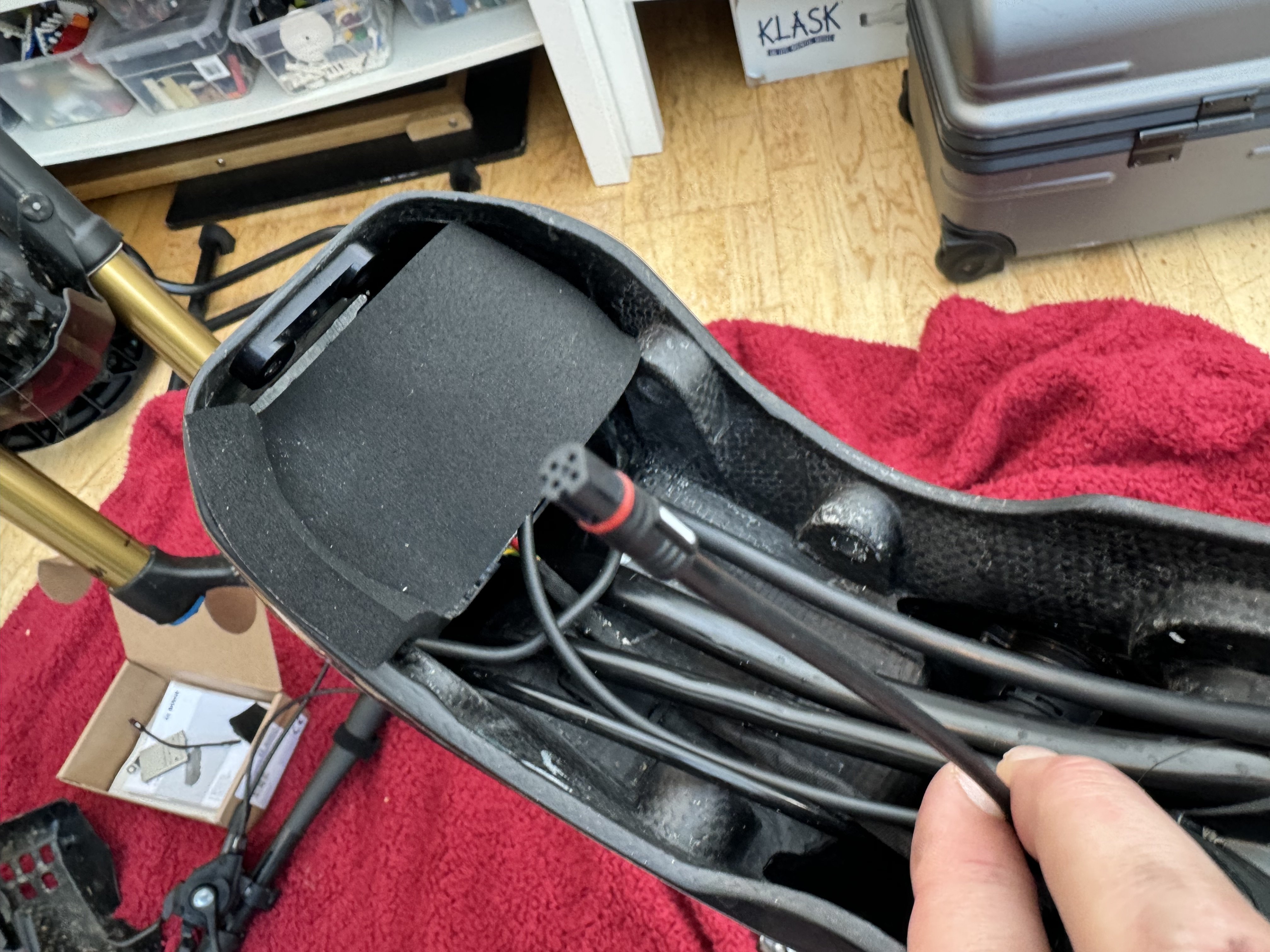

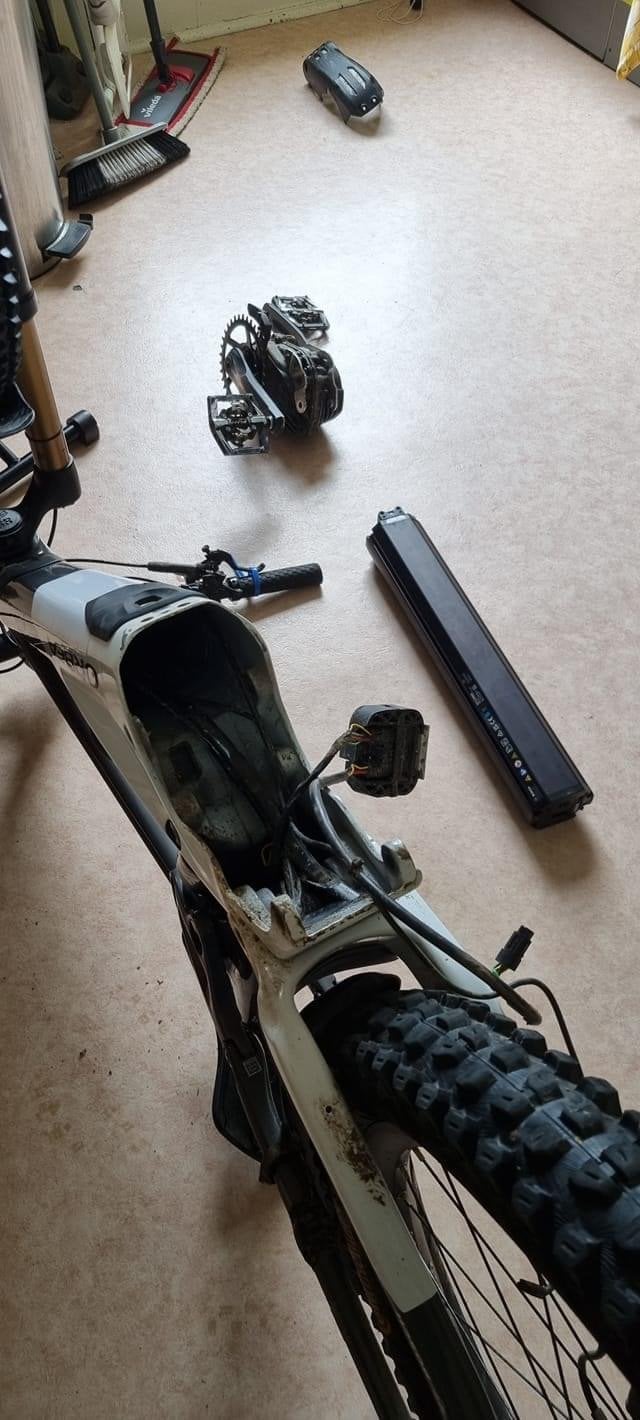

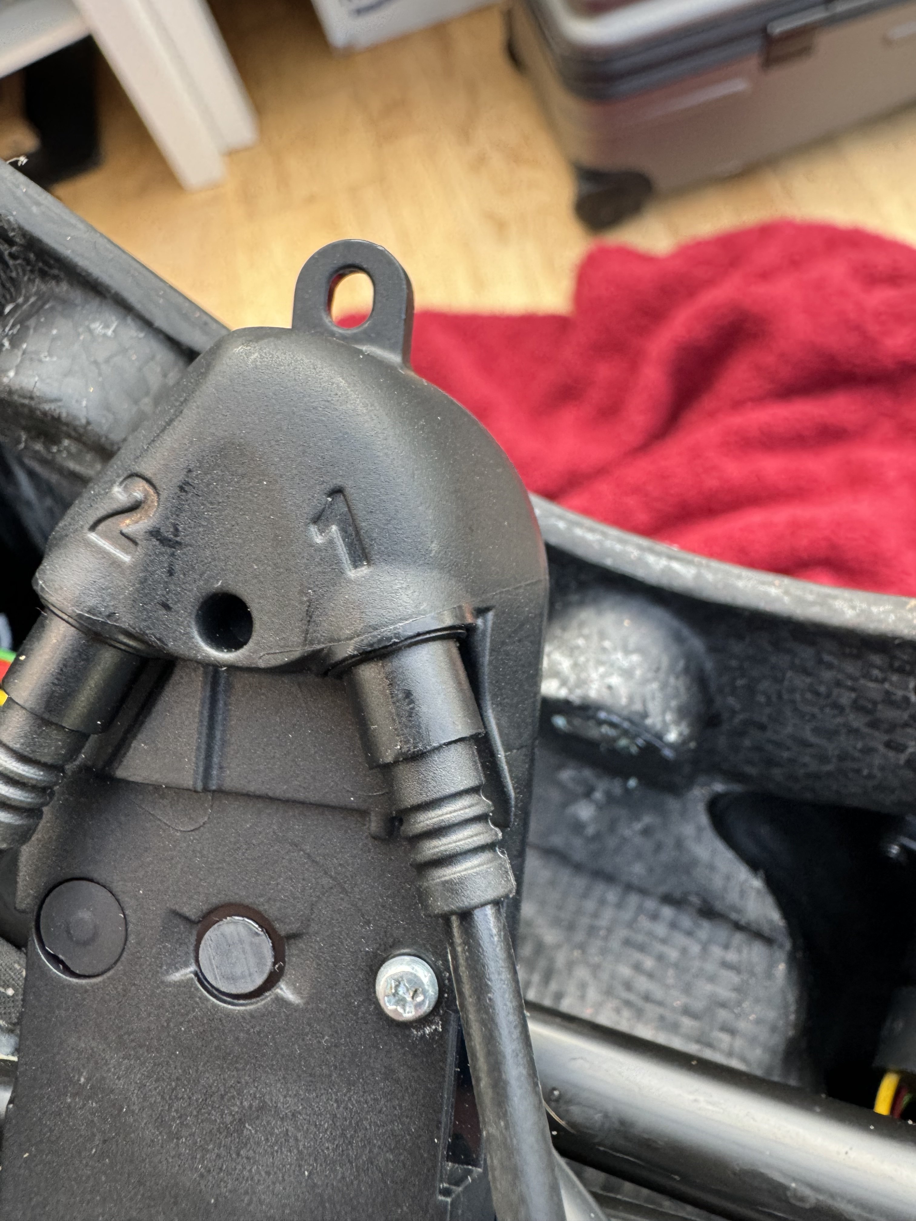

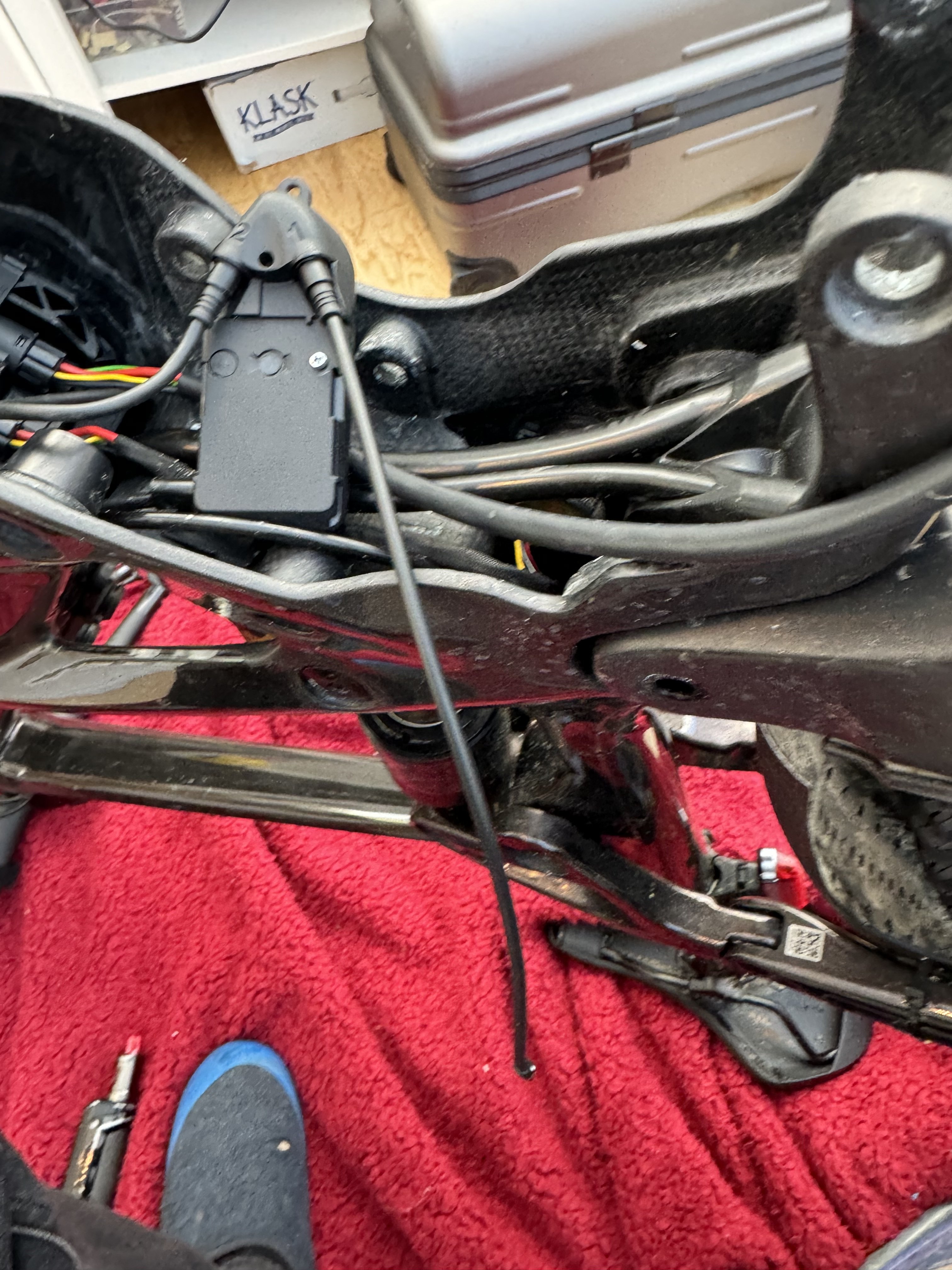

It just works, as soon as its powered up and you are connected to the bike & you get a notification that the unit is fitted. The alarm works if you try and nick it and tracker shoews its current location - the front room much to my wifes disgust :)

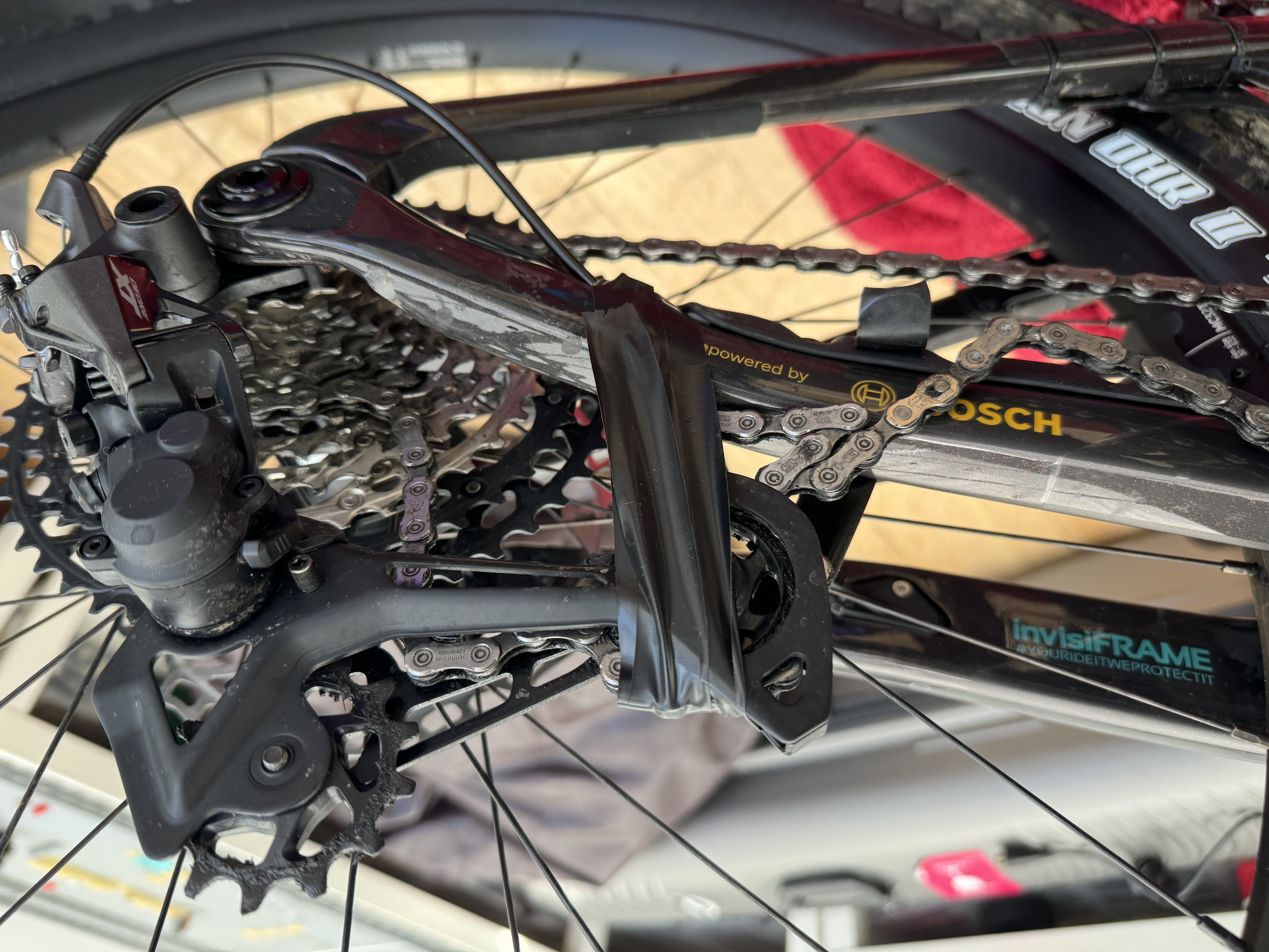

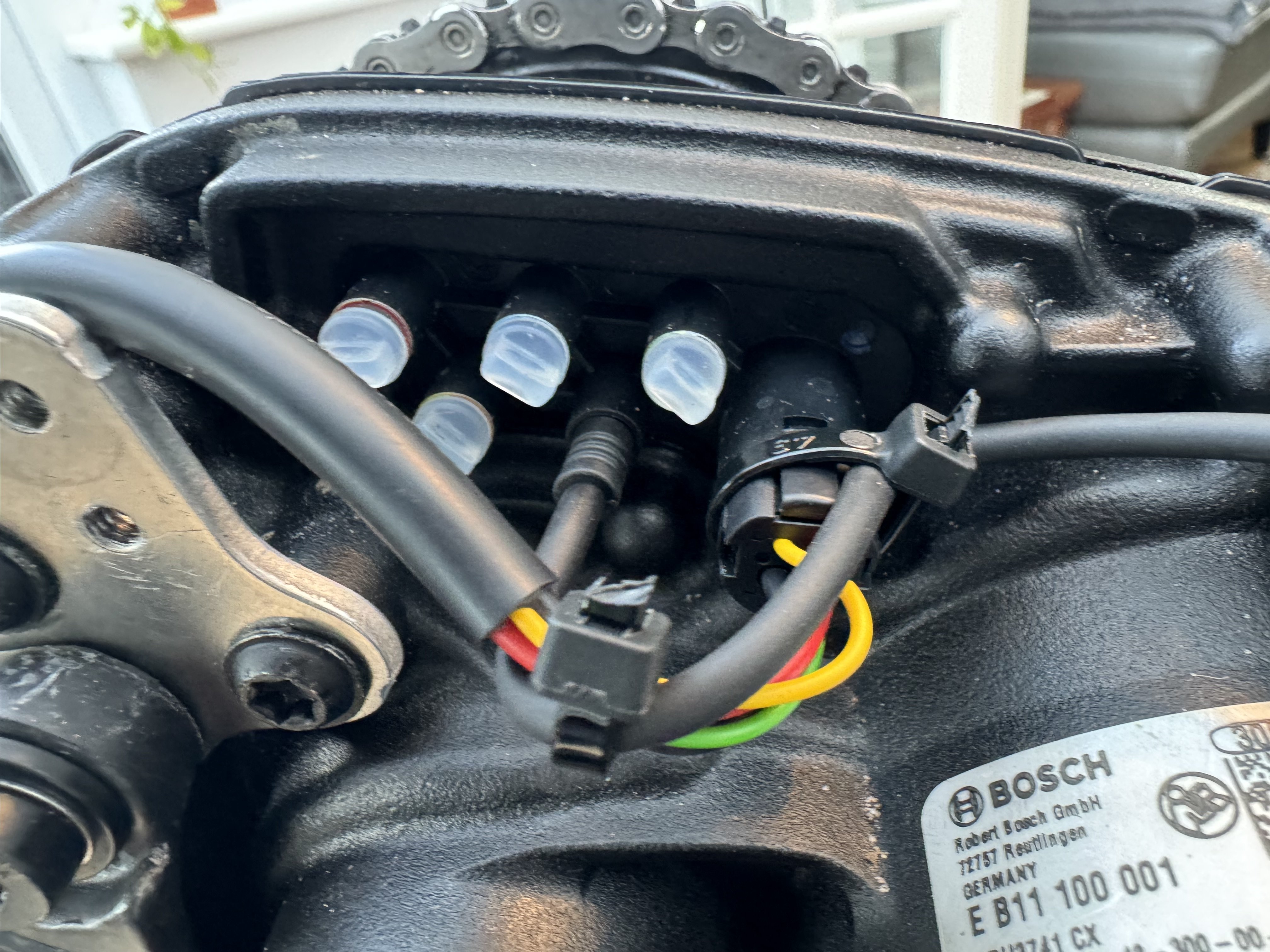

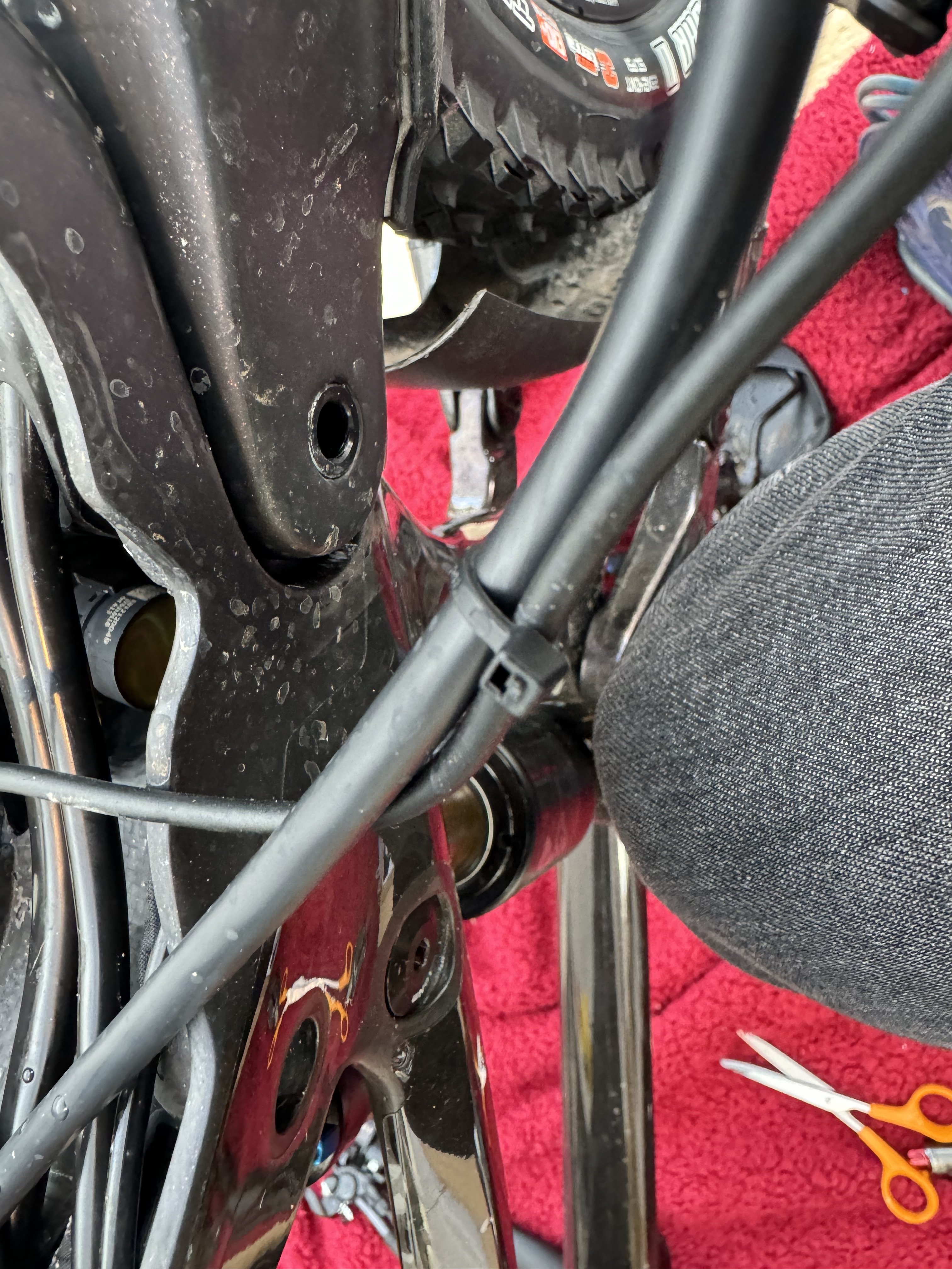

It was really easy to fit - I taped up the chain to keep it slack and put a box down for motor to sit on whilst doing the work.
The control cable is cable tied as shown in one of the pics. Snip that and its free.

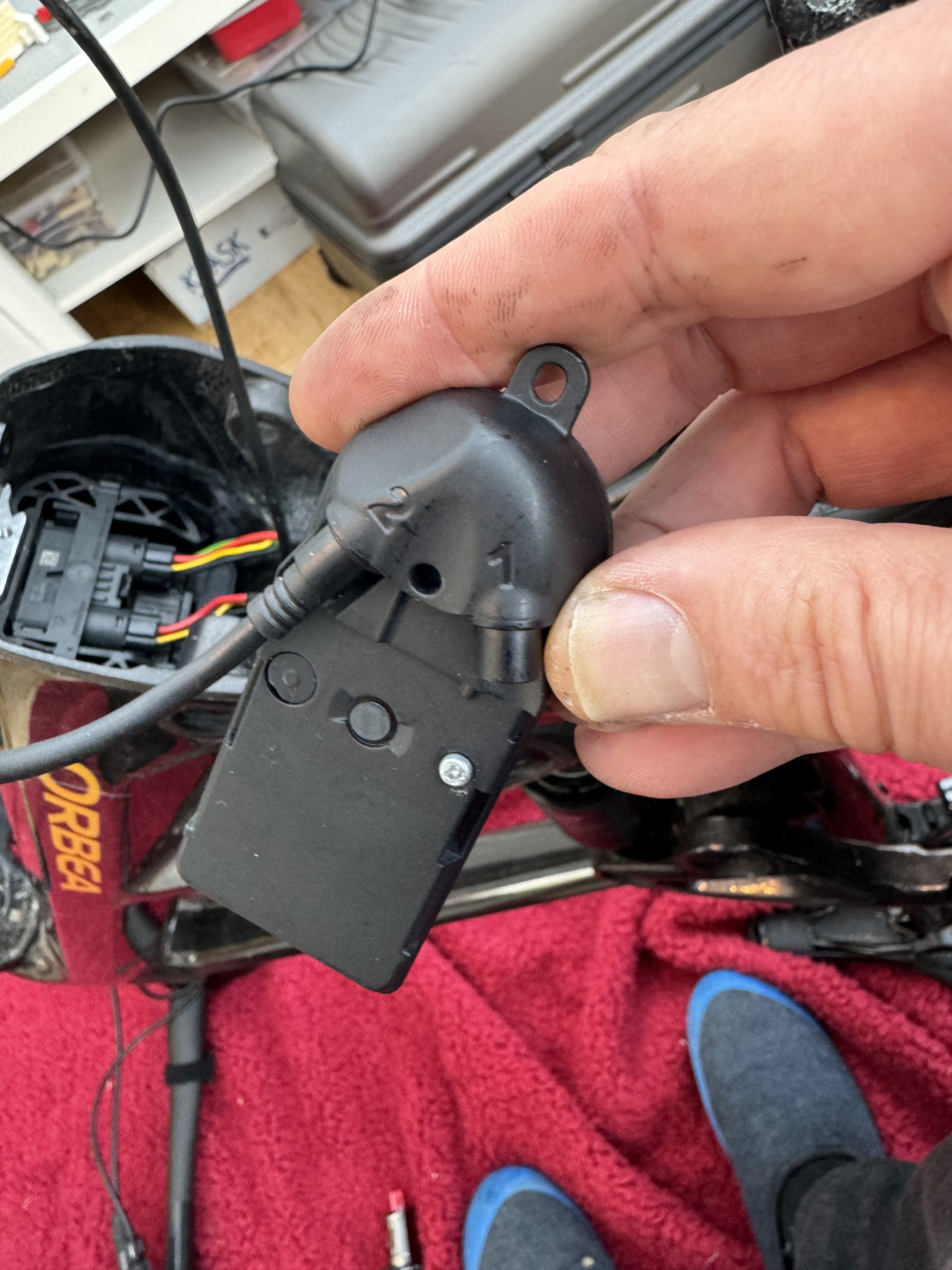

I also took the original fixing plate off the module to give some extra room.

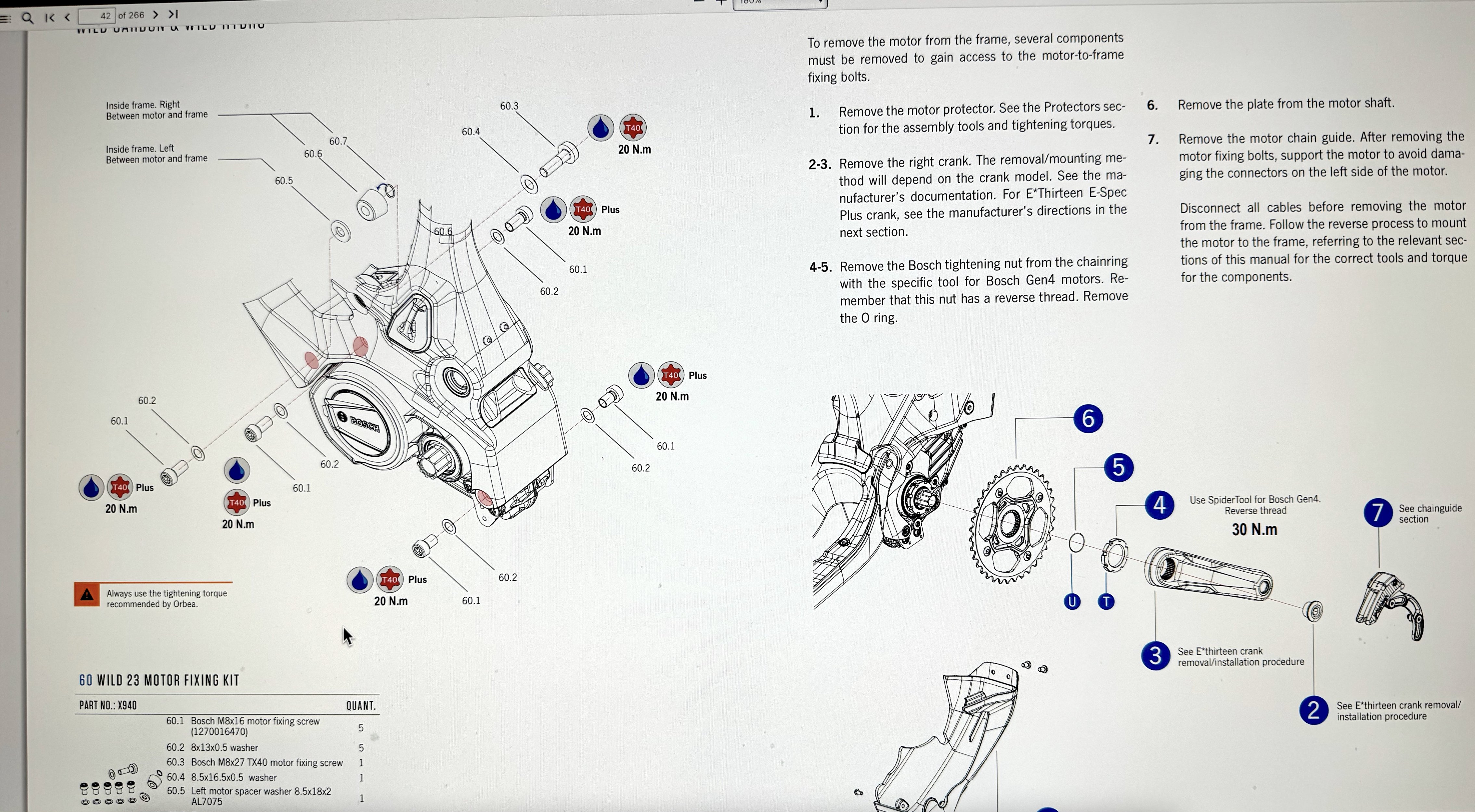

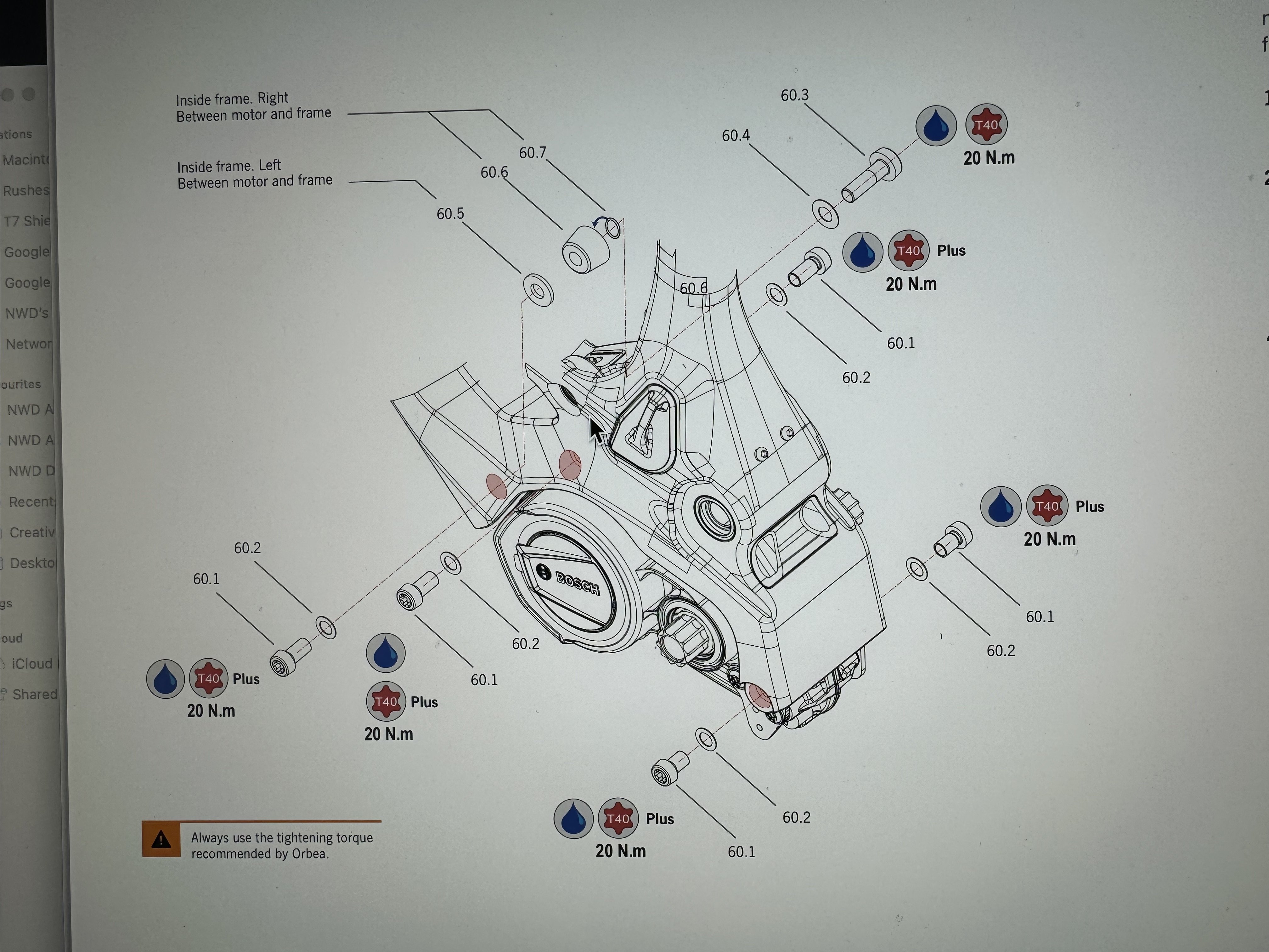

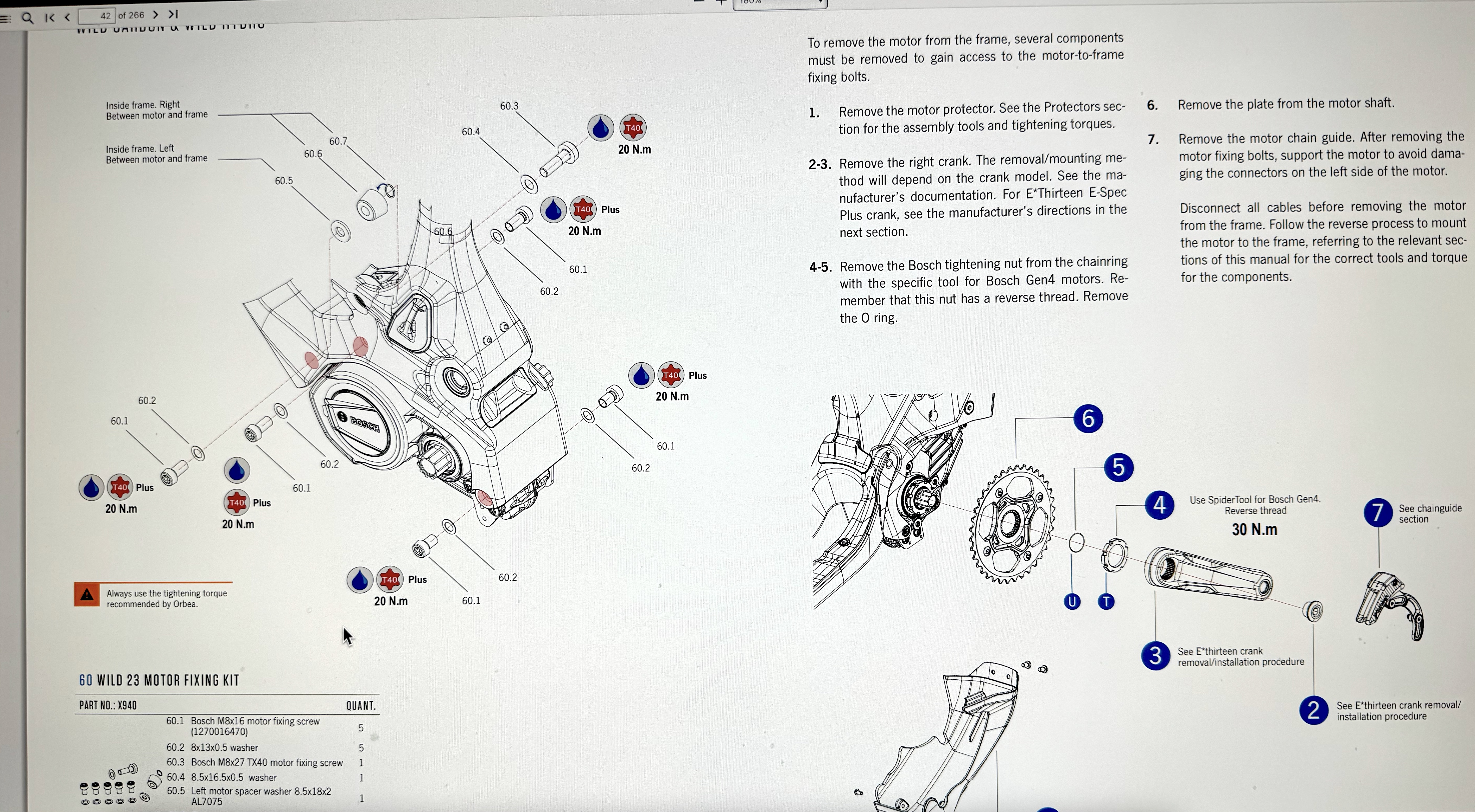

6 motor bolts to remove after you take the cover off.
There's one tricky plastic dome washer fitting inside the frame that you have to keep in as you put the bolt back into it. I kept it in place with a screw driver inserted thru the bolt hole into the plastic washer as i lowered the motor back in.
It's easier to fit the motor from the back first, lineup bolts and partially screw in - work your way fwds.
Keep the Orbea blue print image handy that shows bolt layout.

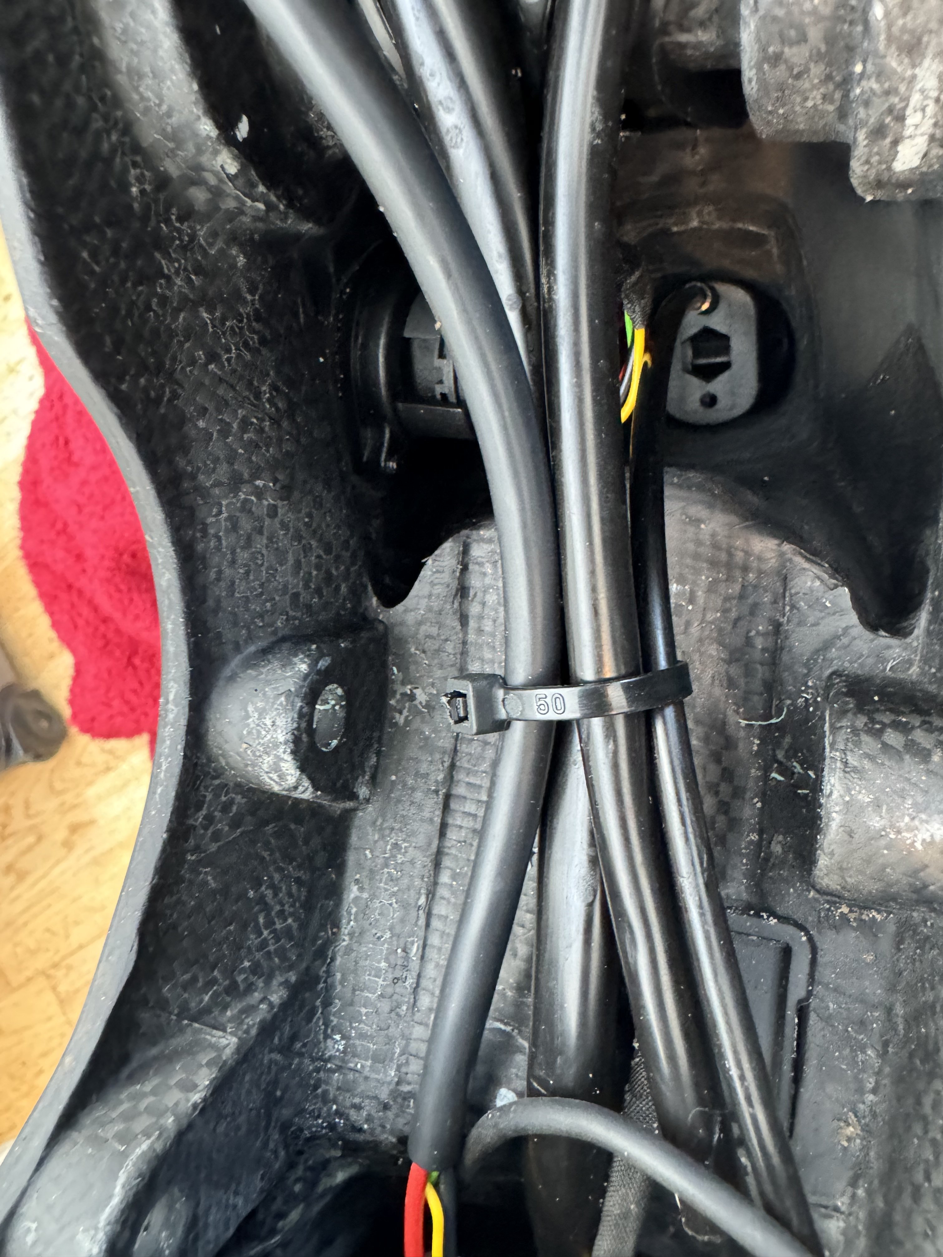

Cable i bought
One i should of probably got which would of enabled me to run behind the motor - but does mean stuffing excess up the battery cavity - shame there's nothing in between. Not that I've seen anyway.
When buying the module just get the vanilla device as the 'fitting kit' is usless on the Wild - that will prob cover the cost of the cable you need.
And get a 20NM Torque Wrench & some blue nut lock for when you put bolts back in.

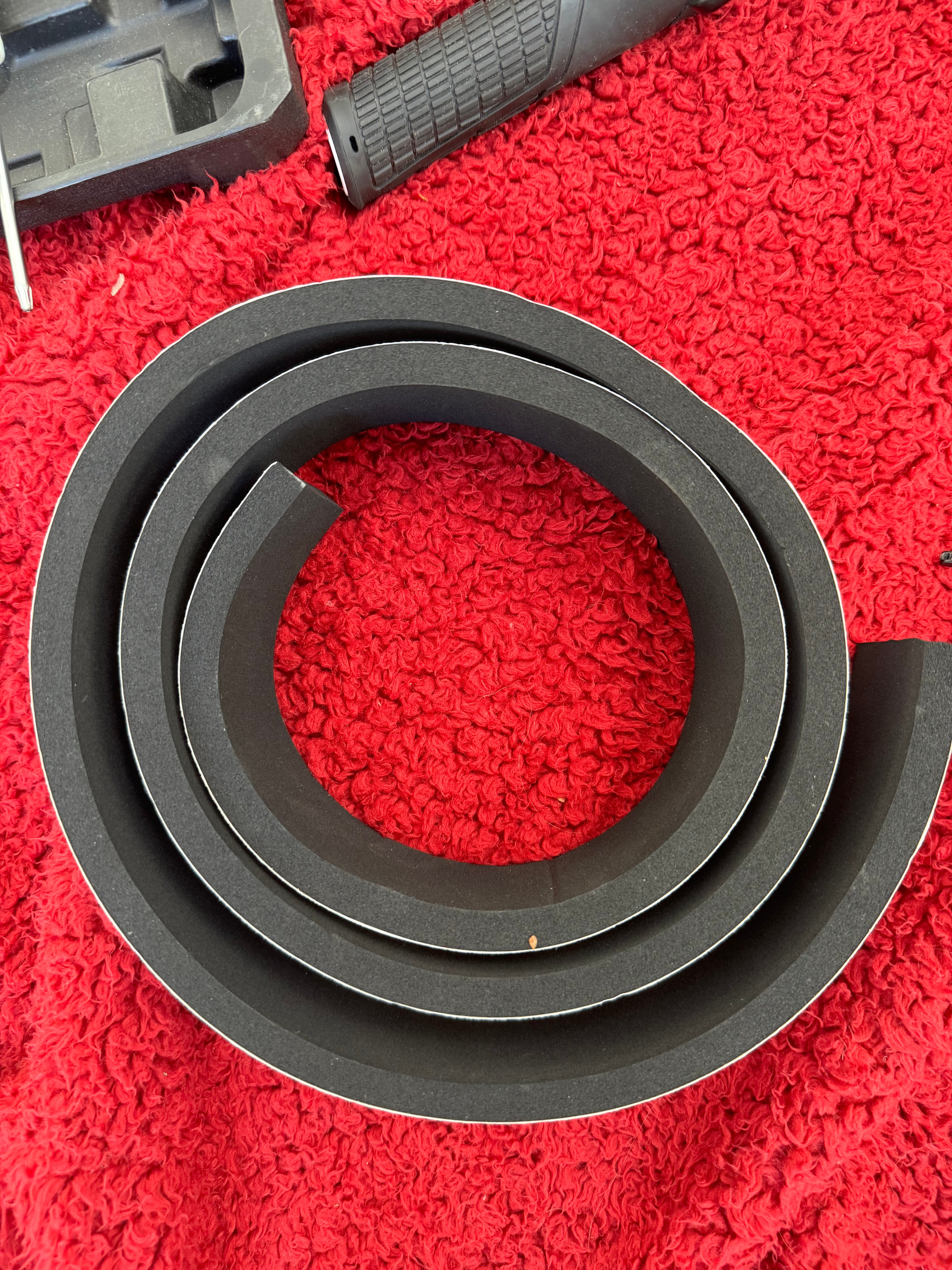

I used this foam for the padding. It's a really snug fit.
