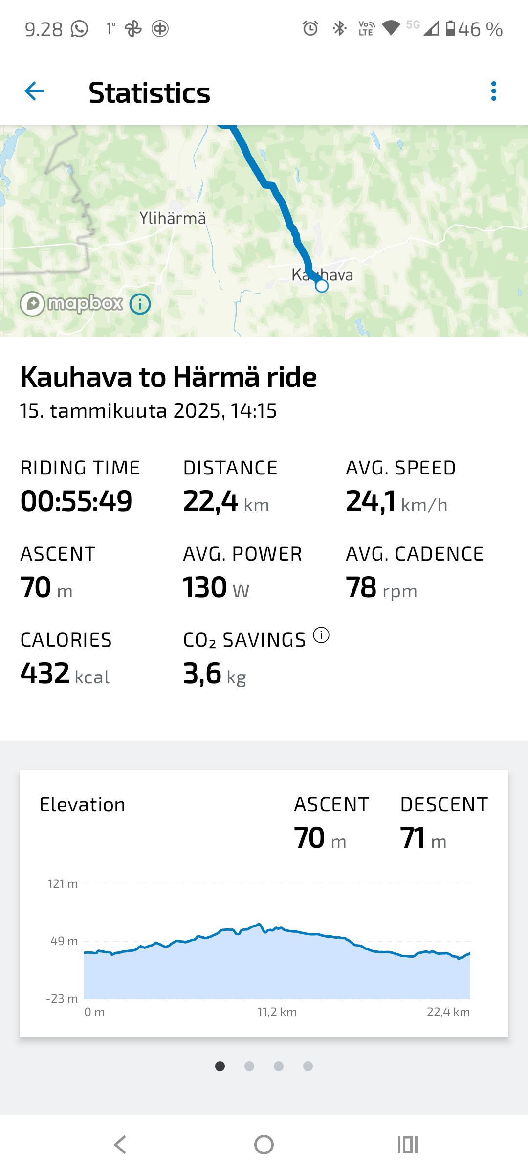

And I did not mean DH in that way. My daily commute has 70m ascent and descent, but still fairly flat. Check the elevation profile in the screenshot. There is a long straight which goes by a railroad track, with just a slight gradient. With this bike I can't hear the engine at all, but with the Canyon at this point I would have heard the engine shut down. In the morning when I leave from home, the first 5km is also a slight descent and good roads. With the Canyon, I usually see the first 1% drop at that 5km point. With the Crescent I'm 8% down at the same point.
Looking at the screenshot, does that look like a ride that would drain 49% of the battery? It did.

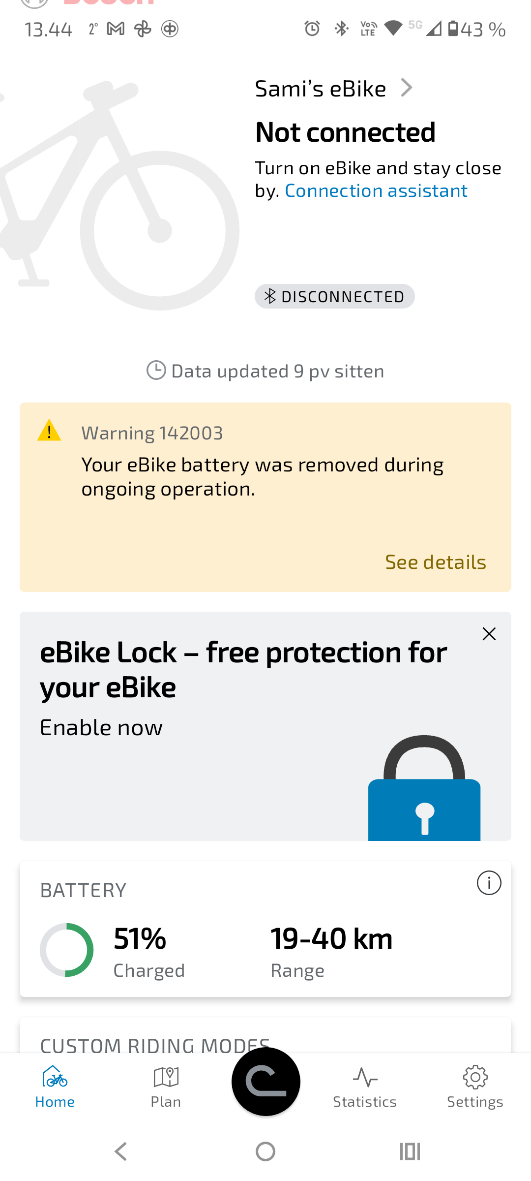

Take a look at this. The battery level, end the expected range. Yes, I forgot to turn the bike off before removing the battery so there is a warning about that :D But the range with 51% just doesn't make any sense to me. What do your bikes predict?

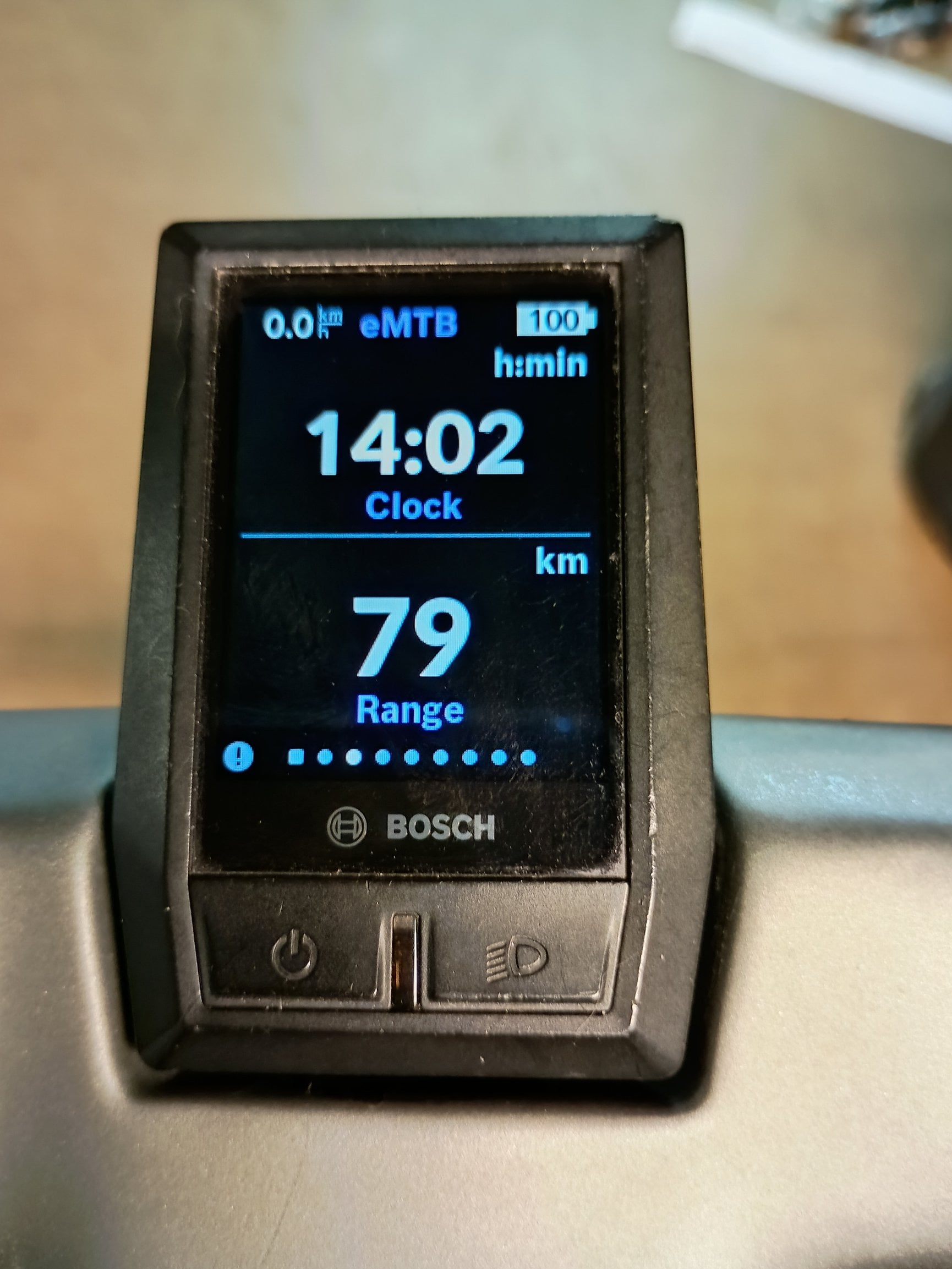

This is what I'm used to with the Canyon. eMTB mode and 79km of predicted range on a full battery, and I have always gotten more out of it. The Crescent has never showed more than 40km on a full battery.

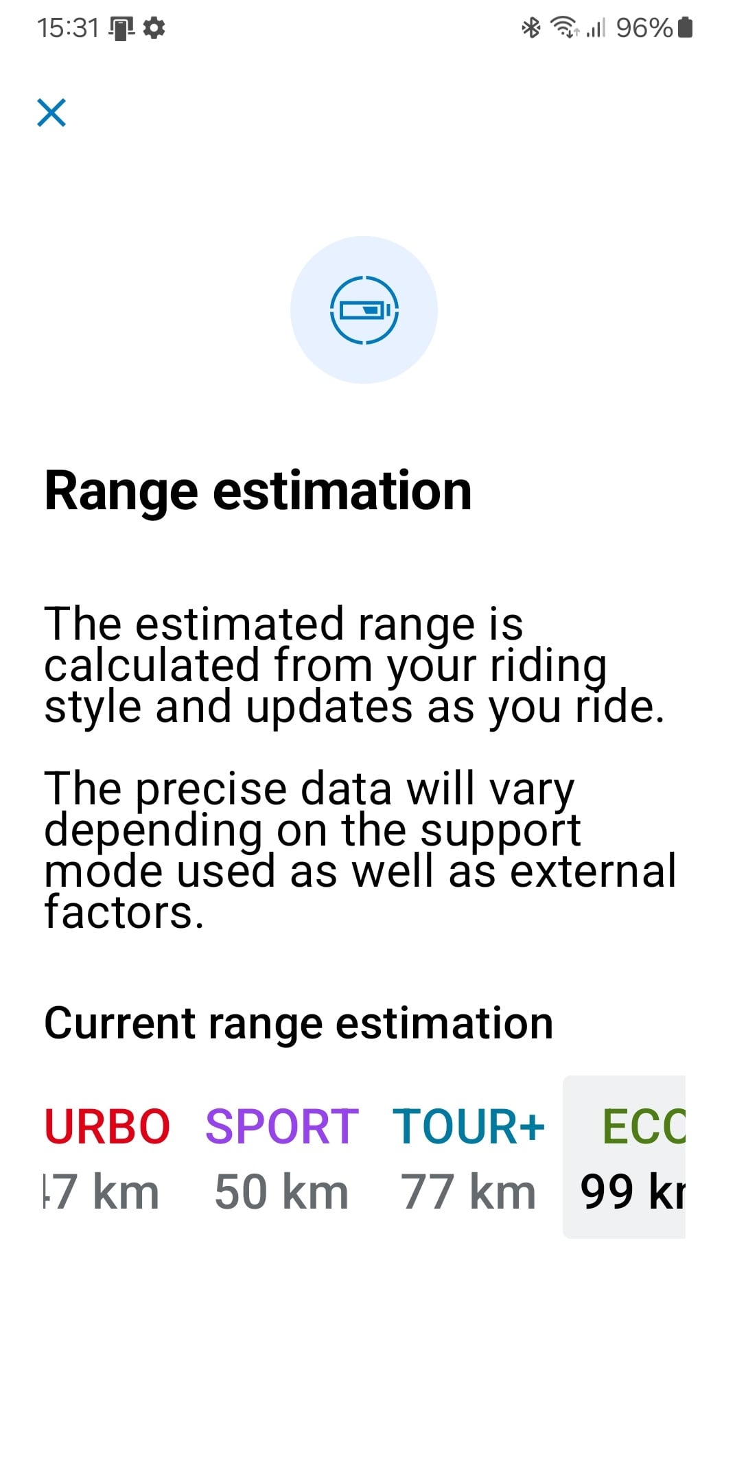

If you hit the ! on the first range screen in the Flow app. you can get the details based on your riding style as per mine below.
While not connected to the bike the Flow app shows a range estimate from the lowest (normally ECO) to the highest (normally TURBO) support mode. If you want to see the range estimate for a specific mode you need to connect Flow to the bike and switch on the desired mode.
Generally speaking it is almost useless to compare the range estimates of an older bike, ridden many kilometers with those from a new bike. Bosch constantly calculates the estimate during rides and stores the resulting values in the drive unit. A new bike comes with factory standard values and shows those for some initial time. These values will change over time and probably trend towards those you are used from the older bike.
You can reset the range estimates to factory values on both bikes.
Other factors that could influence the estimates are ride mode customizations (check all modes for any changes from factory values), different crank length in eMTB mode, or the set value for light output (this will reduce battery energy available for the motor).
And last, you could have a faulty battery.
It is showing the same readings it did, when I ended my last drive and disconnected it. So although I took the screen shot while to bike was disconnected, it is showing the same as when it was connected. But this learning curve was something I thought about, and even asked about it the original post. However the eBike system 2 did not have such, it was showing 100km-ish ranges out of the box and it still does. So perhaps the Smart system is more adaptive by time?
I understand the estimates could be wrong. Canyon usually shows a bit less than the actual range would be, like now when it's showing 79km. The range would count down less than what I ride, if I would take it out now. But the battery comsumption is the thing that I still don't understand. Maybe I just have to find time to ride it empty and see if it learns something new. I just can't do it on workdays, because I don't want to run it empty halfway :D That bike is a pain to pedal without assist.
