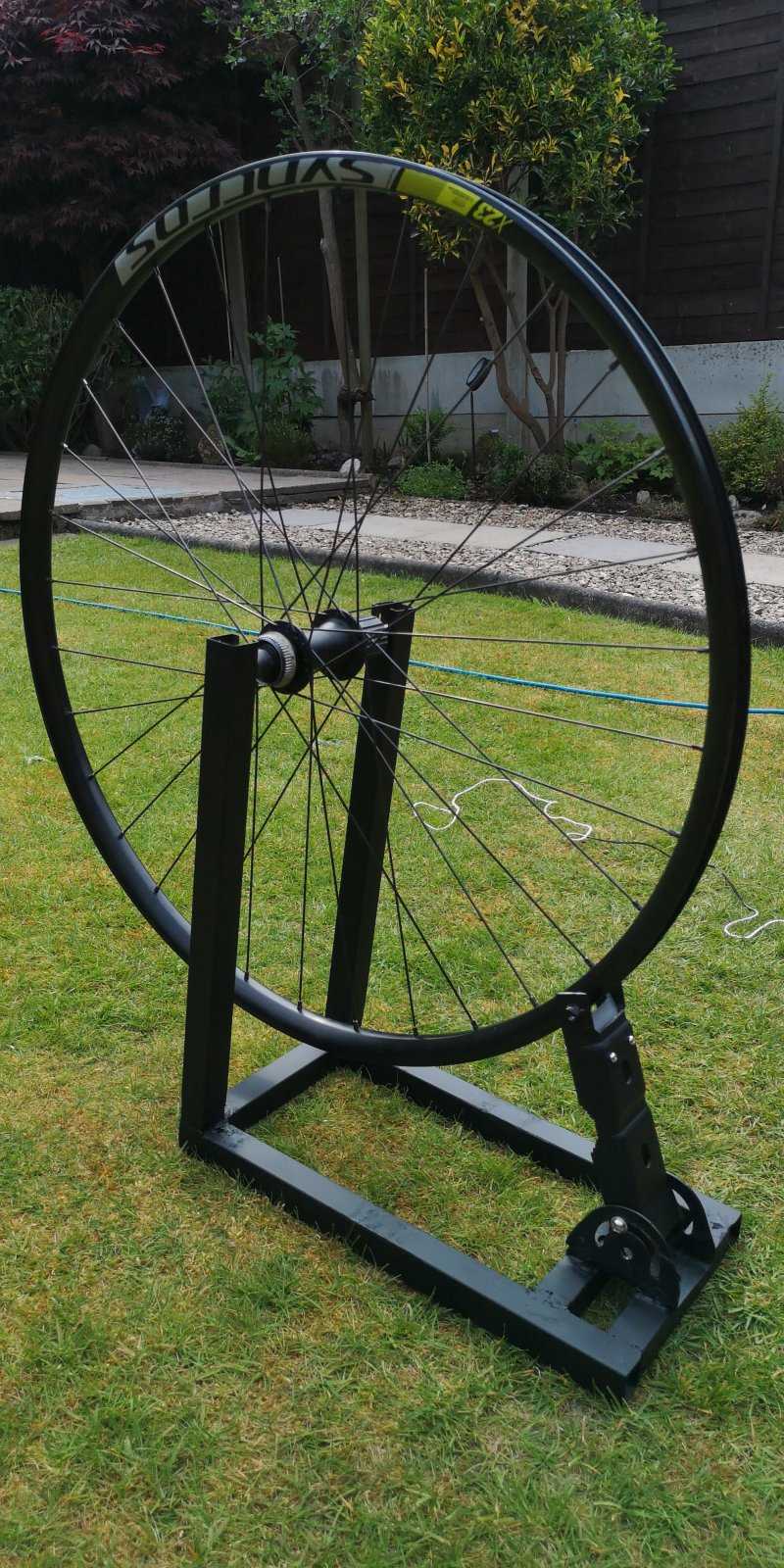

Definitely go for it. Possibly because I'm tight but I did a DIY alignment jig, serviceable but ugly
Bought in a dishing tool, spoke tension guage & an accurate indicator.
3 successful rebuilds to date.
