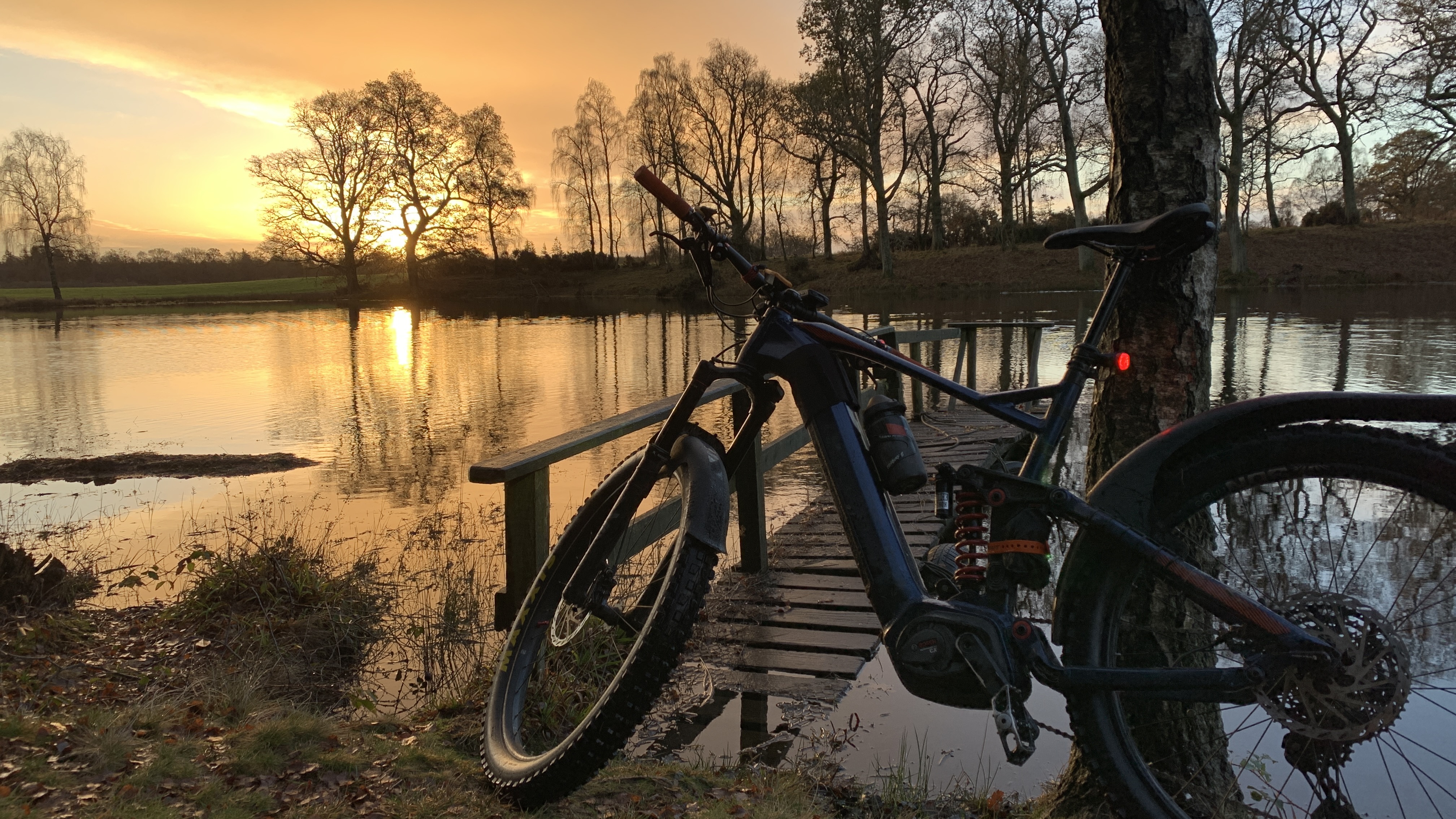

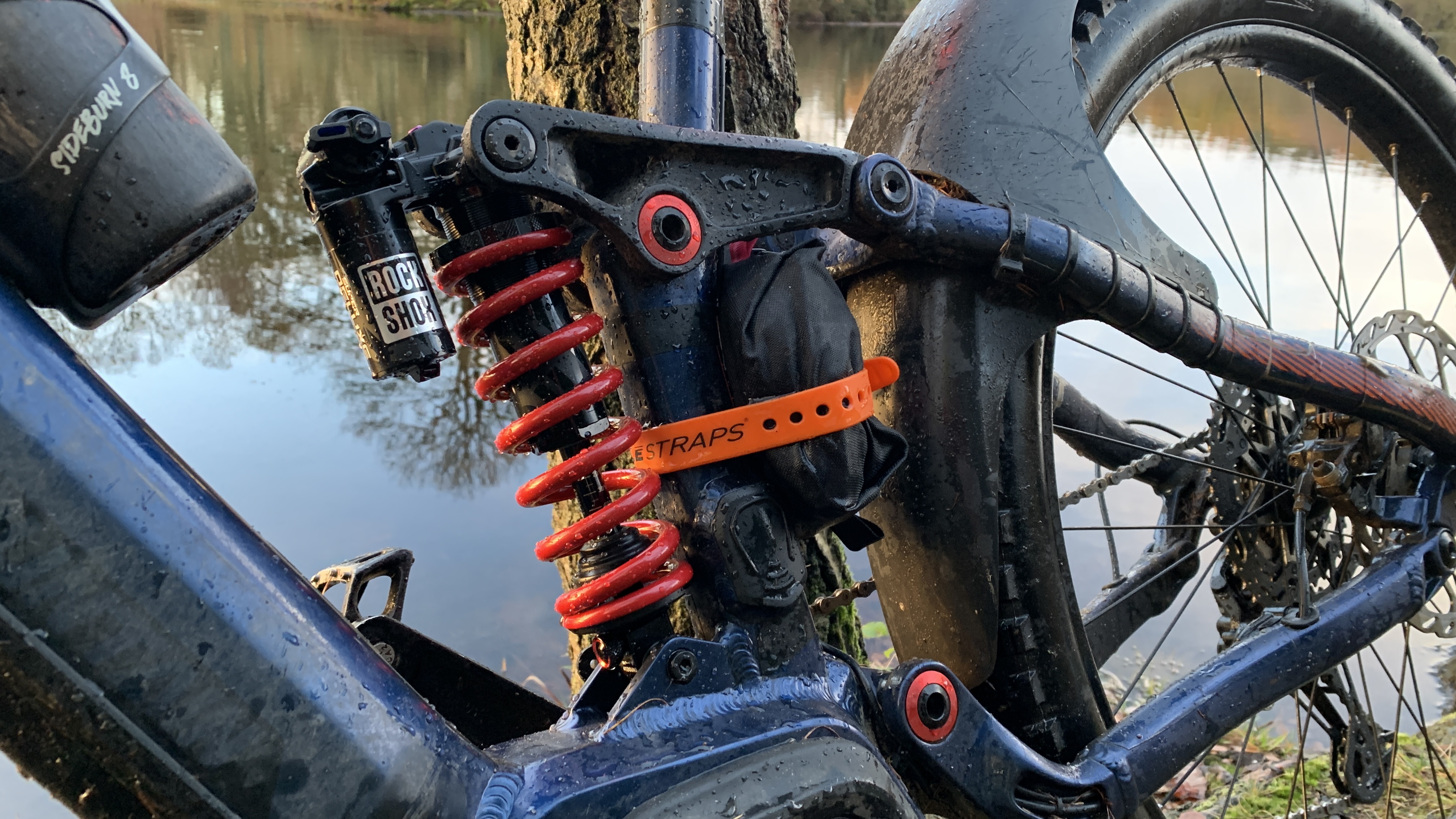

First ride on the 2023 Super Deluxe Ultimate coil - WOW. Over chattery gravel and small roots the bike feels like a hardtail on a newly-tarmac’d road!
Climbing over big rocks, felt utterly planted and grippy like never before.
And the first half of the descent was likewise unreal.
The fact I washed out the front and now have a separated clavicle and two months off the bike isn’t the shock’s fault 😬
So won’t get to play with all the settings for a while - but with everything set in the middle, it beat the pants off the Deluxe air, as you’d expect. It’s a Linear tune.
Fit-wise went on easily, but there’s zero clearance at the bottom between the coil and seat tube. I expect if the coil settles back it might rub the paint a tiny amount, but really don’t care. As the suspension progresses it moves out, so no bother.
