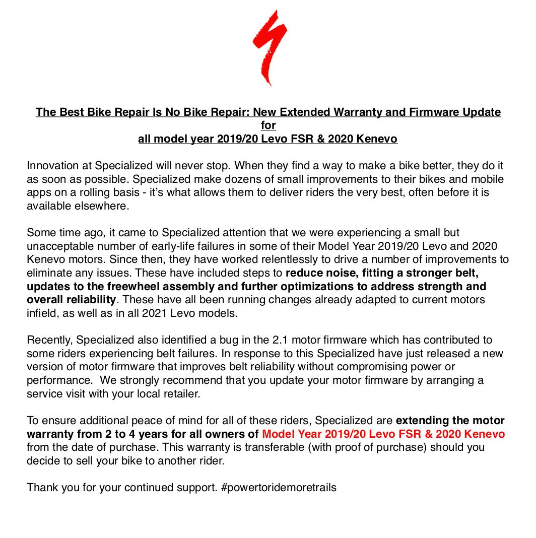

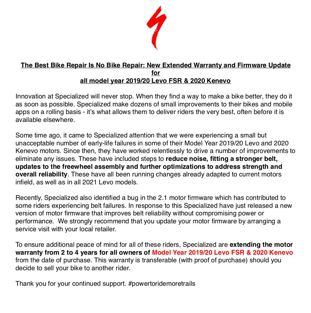

I spoke with my LBS and they tried to tell me that the Specialized warranty was extended to 2 years after your last motor replacement. My reading of the warranty is that the extended warranty is 4 years from the date you purchased the bike no matter how many motors you have to have replaced. Does anyone interpret that any differently?
I could be going on my 3rd replacement.
Bearing Man
Ebike Motor Centre
Sep 29, 2018
981
2,352
Not sure if this is still relevant?
