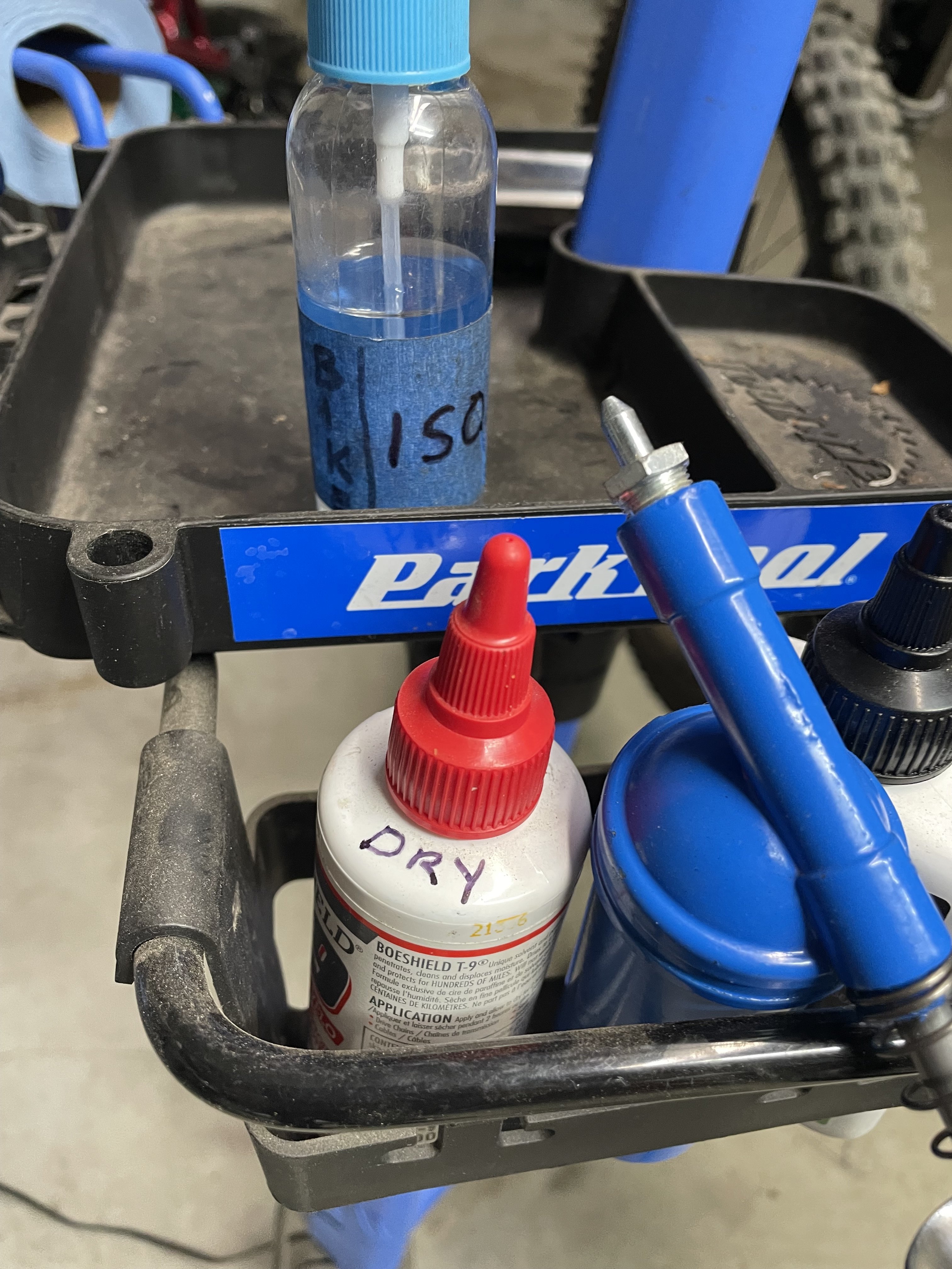

Then to experience...................I regularly clean my discs with IPA and occasionally do the clean caliper pistons and pads routine using IPA and a wipe over of the pads with wet/dry plus IPA clean. I have never found it necessary to repeat the full bedding in process again however after doing that. It merely takes 2 or 3 pulls on the brakes which I know to do at the beginning of a ride to get full power again. ( sintered pads/ SRAM RSC brakes)
That’s a lot of IPA…never knew it could be used for cleaning. 🤔
IPA is almost pure alcohol and evaporates very quickly leaving no residue. Much more efficient than brake cleaner and brilliant for thoroughly cleaning bike parts like dt swiss ratchet freehub components before regreasing and reassembly. For calliper piston cleaning I use a little sprayed into a little pot and dip an ear bud in that to wipe the pistons.
Ah man…another senior’s moment here. I always call it ISO (Isopropyl alcohol).
Don’t want to start an acronym war but I’ll keep calling it ISO. 😜
