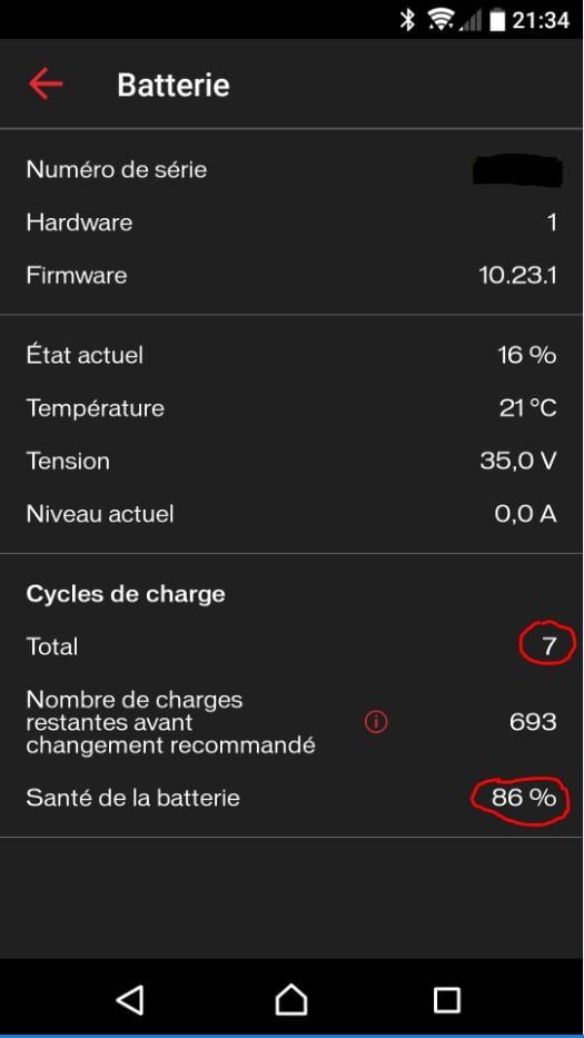

rodoid
Oct 8, 2018
Nice - France
Hi there,
Same issue here... 7 full charges and only 86% battery health (432Wh) on my 2018 Levo... Will bring the bike to the store on saturday and will let you know what they find...
A little bit concerned about that...
pgtips
Jun 3, 2018
312
279
Somerset
An update on mine. I've done multiple discharges to 0% and battery health has not changed. Still sitting on 85% on the app and 81% on the report
Just a matter of interest and I do apologize in advance if you already tried it, but have you tried to delete the MC app and reinstall it? There might be a bug in the app ad it showing the incorect health.
I had this with mine, 2 charges old battery and only 40km covered on the bike it was showing 93% health on my battery. Deleted the app and reinstalled and now is showing the full 100% health on my battery.
Worth a try?
