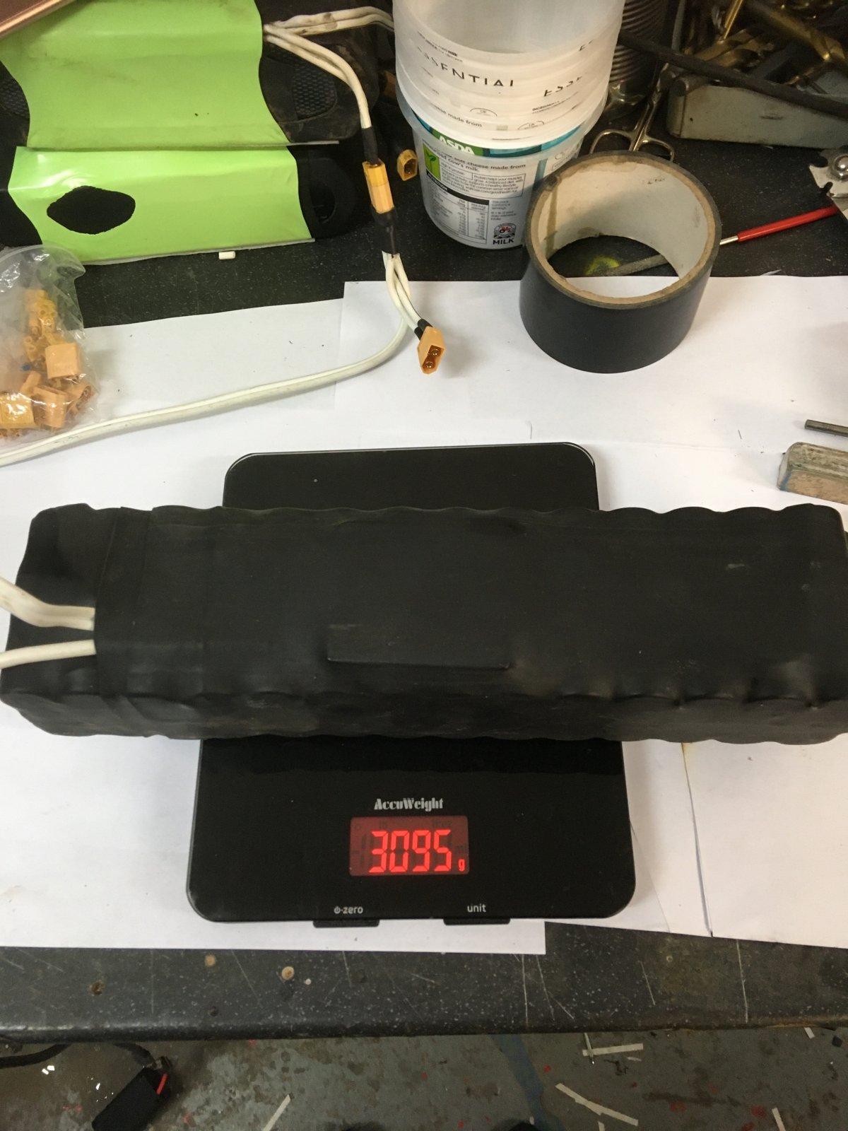

The Bosch 625wh Power Tube from my bike weighs 4.024Kg.........I just weighed it on a very accurate digital scale.
Some of the new technology batteries are begining to get into cool territory. Piccie is of my latest battery using the Samsung 50T cells we have not used before, very impressed so far, smaller package and lighter for more oomp at 780Wh.
