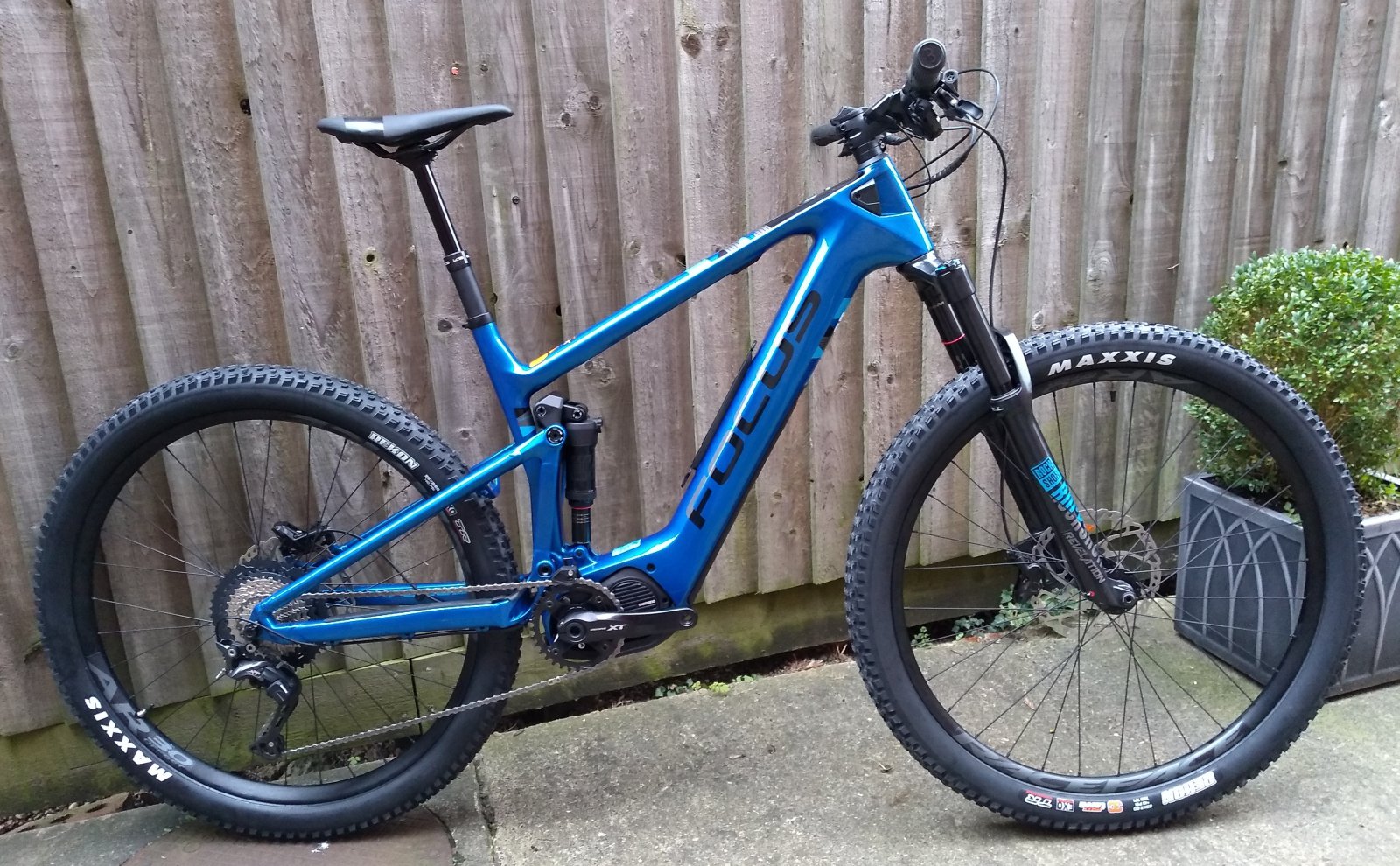

@Bobj183 I agree with @stiv674 I have a size large, carbon-framed Focus Jam2 with its 378Whr battery contained within the downtube. The bike is a thing of beauty and it only weighs 20.4kg. The TEC pack by itself is not bad looking, but placed on the lovely Focus Jam2 it is like adding a wart! However, it only weighs 2.2kg. So even with the TEC pack added the bike still only weighs 22.6kg, and it has 756Whr! Beat that! :)
