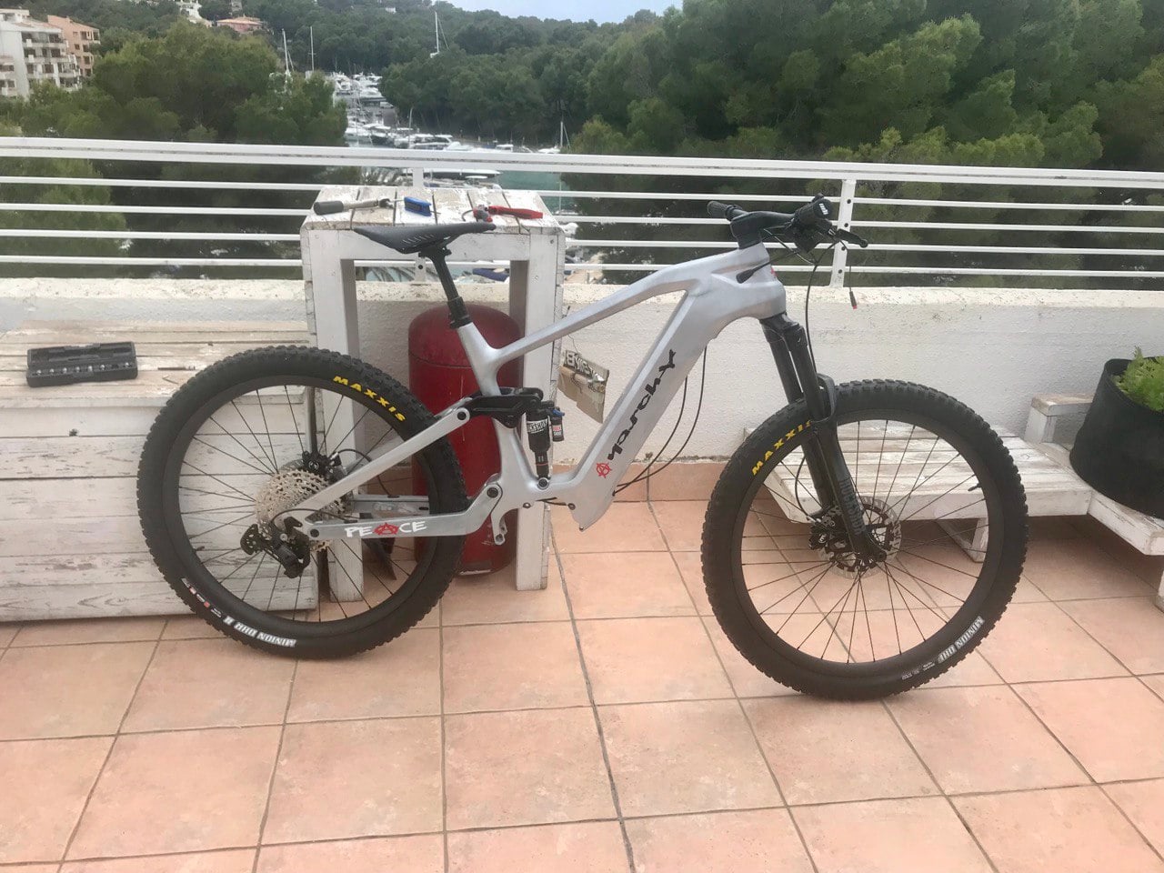

I am looking for some advice on my new DIY eMTB build. I completed the build yesterday on a Chinese carbon frame (from Joybikes) - They did have to re-send me a new frame as the first one was damaged slightly on the headset, It had gotten squashed in transit, I managed to fix it with my Dremel, but I wasn't prepared to accept it.. and they immediately sent me another with no hassles! So, I have ran into a problem that the pedal assist does not go atall, I think I got all the wiring correct, the controller lights up and all works fine.. but there is just no juice to the pedals! I have stripped it and re-checked the wiring.. but it all seems fine (and why would the controller all light up and work if it wasn't?) The only thing was the cable from the controller had a red&black spur off it that had 2 metal female ends on them.. I have no idea if they were to be inserted somewhere? so, this is what it could be? but I couldn't see anywhere these could be inserted.. not on the motor..I have the yellow battery one inserted and like I say, the controller comes on and is totally fine... I am putting up some photos... and hopefully someone can tell me what I'm doing wrong? This is my first eMTB build.... so any help is appreciated.

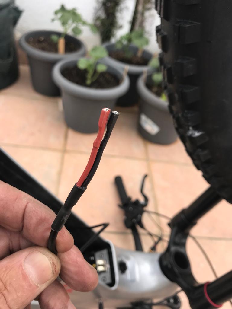

So.... I got the Motor back from Bafang, Poland this morning, I quickly re-assembled the bike.... and here are my findings... which I hope I can maybe get some help again............ I put it together, and then took it for a test ride... and again... nothing... but I did notice they had definitely opened up the motor.. that I could see... as I was about to give up on the test ride... I thought I sensed it give me a kick! like... the torque... I took it further... nothing... then I thought... (I dunno why) I unplugged the Magura MT5e brake sensor cable from the motor (red to yellow - I bought the expensive! adapters from Germany to save me filing off the inside of the red adapter!) low and behold... It jumped into life!! WAS AMAZING POWER!! So, then I fiddled about with it more... The motor won't work atall if I have the MT5hc cable (red) plugged into the Bafang (yellow) one.... but then I started to test it with the walking aid...as I could do this alone... If I depress the MT5hc levers slightly (both) it kicks in!!!! So, in effect, it's like it;s working in reverse!! as I should pull the lever and the motor cuts out... but this is opposite!!!! my only surmise is that they did something when they opened up the motor?? or has anyone else had this problem with MT5hc levers and Bafang M510??????? Loved the bike btw..... awesome!! but I really want the hc's to work correctly!! any ideas anyone??

It seems to me that the switches built-in on your Maguras are Normally Open (NO) and the motor controller is expecting Normally Closed (NC) switches. This means that the motor will deliver power for as long as the NC switches are closed (the levers are not pressed). As soon as the levers are pressed, the switches cut the circuit and the motor stops delivering power. Instead, your NO levers' switches cut the circuit when not pressed, so the motor does not deliver power until the circuit closes when you press the levers.
Perhaps you can contact Bafang, or somebody here like Neeko, to learn what the pins of the brake sensor at the controller are. I'm referrencing CNC's limit switches here, so take this with a grain of salt, although I'm pretty sure the exact same principles are at play. In that context, switches with 3 pins had the ability to be wired either in NO or NC. One is ground, the other is NC, and the other is NO. So, if you want the switch to behave as NC, you will wire the GND and NC pins to the controller.
So in your case, you would have to cut the existing cable somewhat close to the connector on your maguras to change the pin order of connector by bridging the right wires. Normally brake sensors are NC
I hope this all makes sense
Hi, thanks for replying… yeah, I’ve now found out that is the problem and I found a YouTube video on how to rectify it… but of a fiddly job… but will do it in morning… thanks again

well... I kinda agree with you now.. but seeing as I bought the MT5 higo levers... may aswell try and get them to do as they do...it's either I strip out the cables or try this easy fix to reverse them... so will go with the easy fix first.. and if I feck it up.. then i'll just pull all cables out....

Normally brake switches need to be open for motor functioning. You need only to stay the connectors unplugged

yeah... well.. I did try and do as the video said to reverse the switches to closed instead of open... but after doing one side (i thought really well) it didn't work...(tried it with other side unplugged and then did walk mode..... ) So.... I just cut the cables!! and ALL IS GOOD!! Now i can go out and test this bike on proper trail..... thanks to all

Hi again, so I took your advice and I just cut the brake sensor cables off... and it works great.. but it can be a bit sketchy when your on a technical area and the motor takes a few to cut off..... is this normal? is this the same as other bikes without the breaking sensors? I mean, I'm already used to it.. but I sometimes get caught out when on a really tricky technical part..

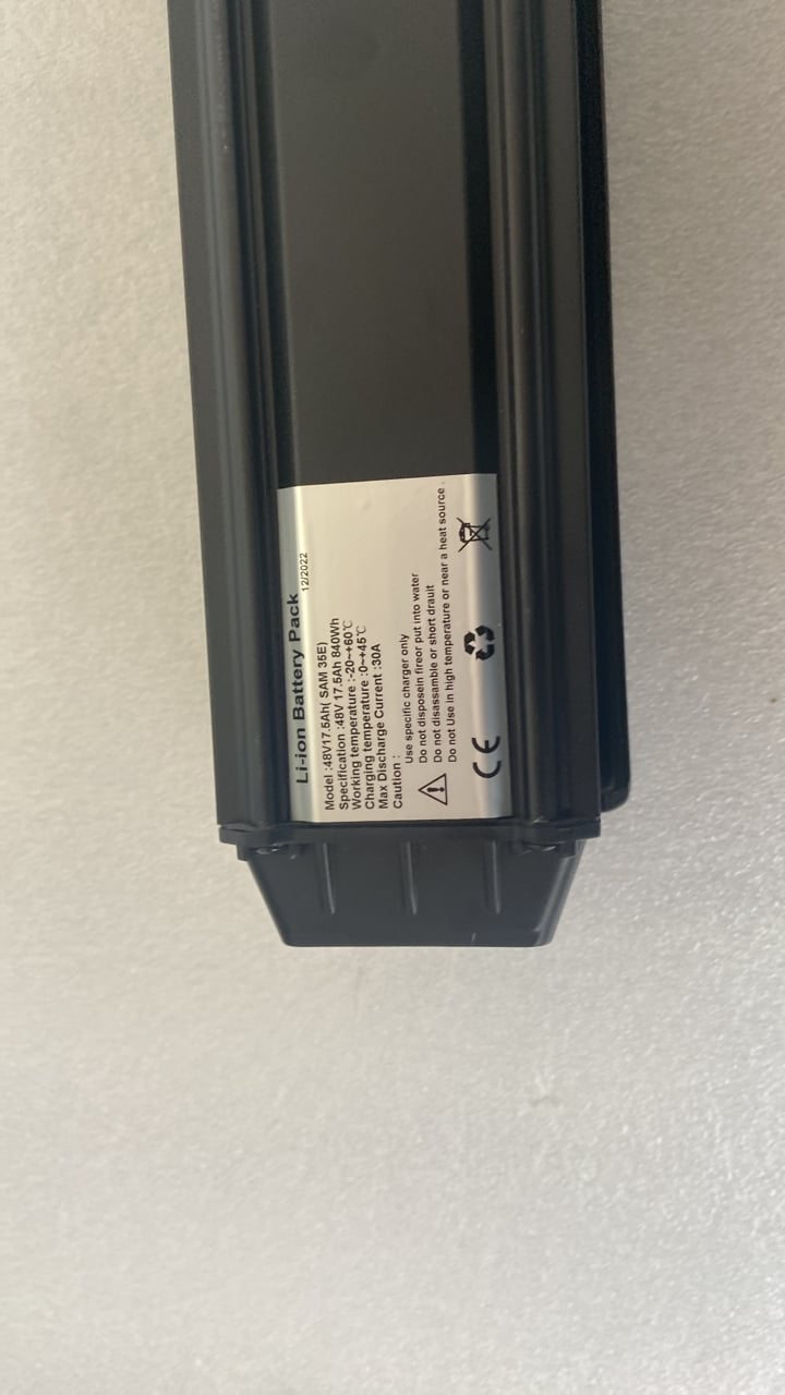

So, it's not even a year since my DIY self build eMTB and things were going great... but all of a sudden when I was out on a ride my battery stopped, whilst still showing 82% on the controller! I stripped it down, checked all terminals etc etc.. but then I noticed the battery itself has a button on it with a little light window to check power..>I pressed this and nothing lit up! (lights up green when it has life!) I got this bike build from Joye Bikes, which was a it that had the frame and the motor and the battery. Customized Lithium battery, Customized Lithium battery direct from Changzhou Joyebikes Co., Ltd. in CN
If u have read my build threads, u can see I did have some teething problems but everything has been fine until now!
So, I got the eMTB home (bloody hard ride home with no battery!!) and I took the battery out and stuck it in the charger. I left it for a few mins then unplugged and did the pressing of the button thing on the battery again, and it lit up solid green!!! I put it back in the bike and switched on the controller and low and behold.. It showed 83% power left!! So, I took it out on another ride and this time it stopped at the start (after 5 mins) The battery was fully charged and it showed up as 100% on the controller until it stopped! I took battery out and again , the light would't come on when I depressed the button on battery to check! I took it back and totally stripped the bike down and cleaned all connectors etc etc.. I did everything!! I plugged the battery into the charger for a min. then removed and pressed the button on the battery and it lit up green again!! Put it back into bike and again, it all lit up again and showed 100% charge. So, everything was good again for 4 rides... all running perfect, then yesterday.. 1 hour into a ride, it did it again!! Same scenario, I removed battery, and no light came on when I depressed the button on the battery to check it....but it was showing up as 60% on the controller before it stopped! I'm thinking faulty battery from these guys at Joye Bikes!! I have notified them, but I had nothing but hassles from them when I first got his kit and the Bafang motor was faulty and had to be sent to Poland to be fixed etc.. and I have no idea if they shall send me a new battery.. as they are in China... But I did pay them by Paypal.. so I do have that to fall back on, as it is not even 1 year!! Has anyone else had a problem like this? It isn't the temrinals etc etc.. can only be the battery.. as I have checked everything else, and well, It has to be faulty as the green light doesn't light up... when it should! I left a link to JoyeBikes site to show u the type of battery it is... (48v 17.5) - any info or advice would bemost welcome...
