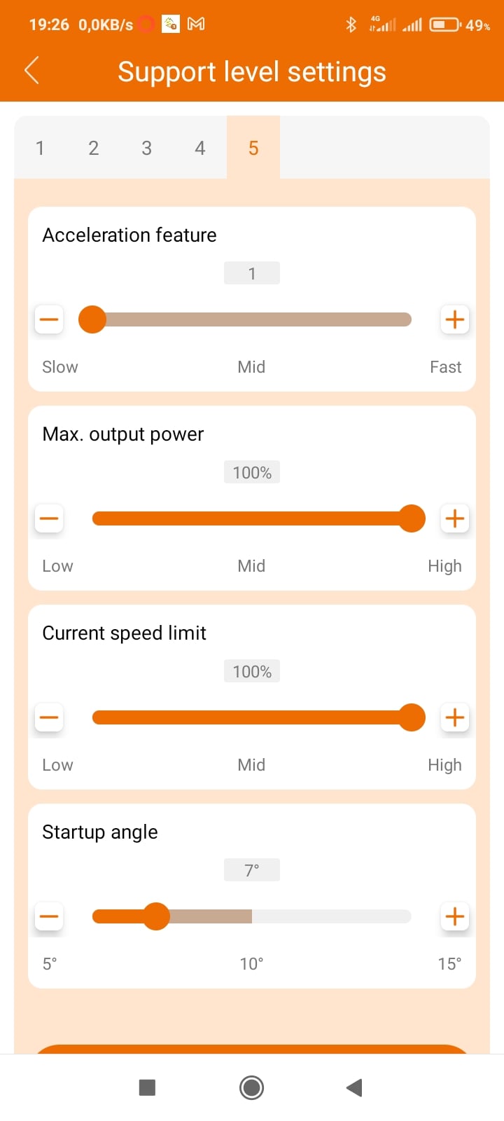

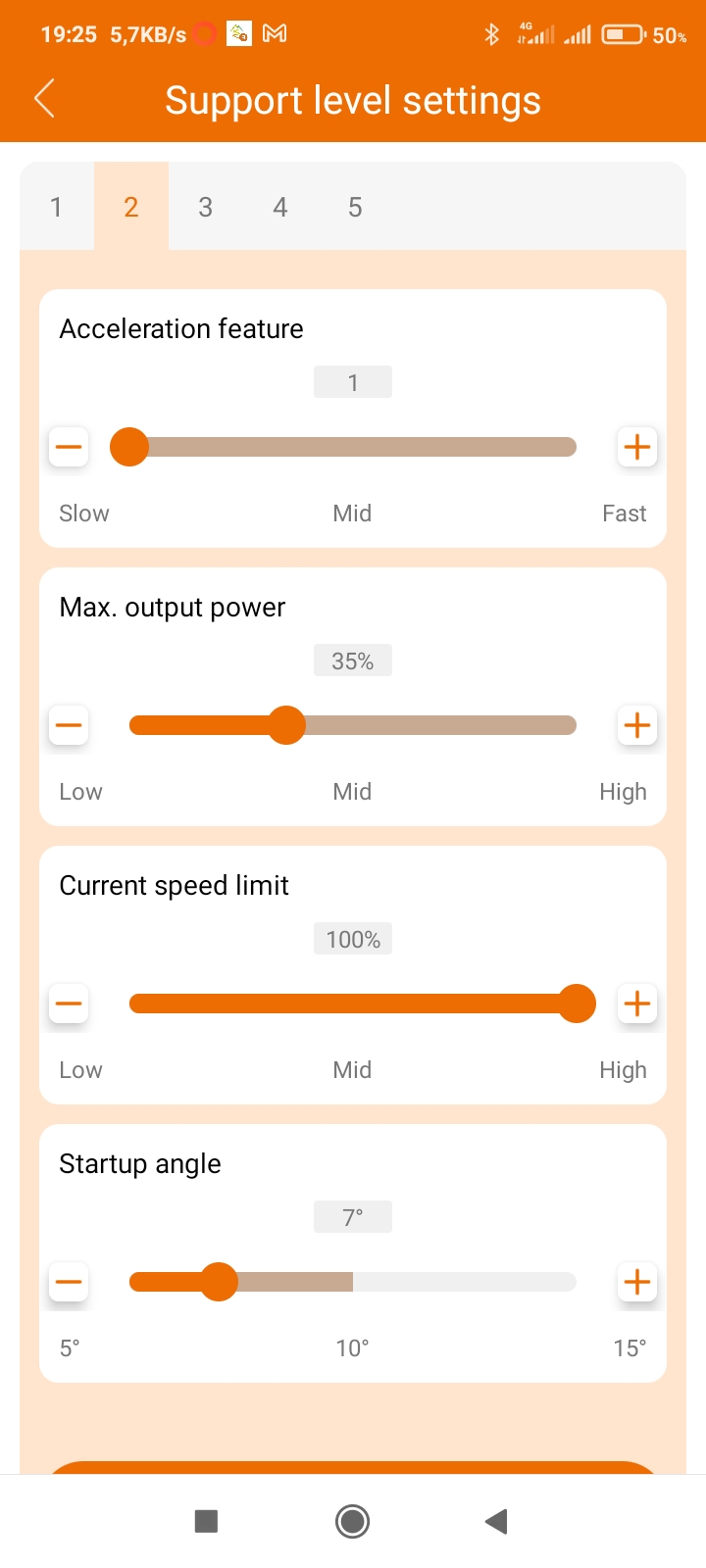

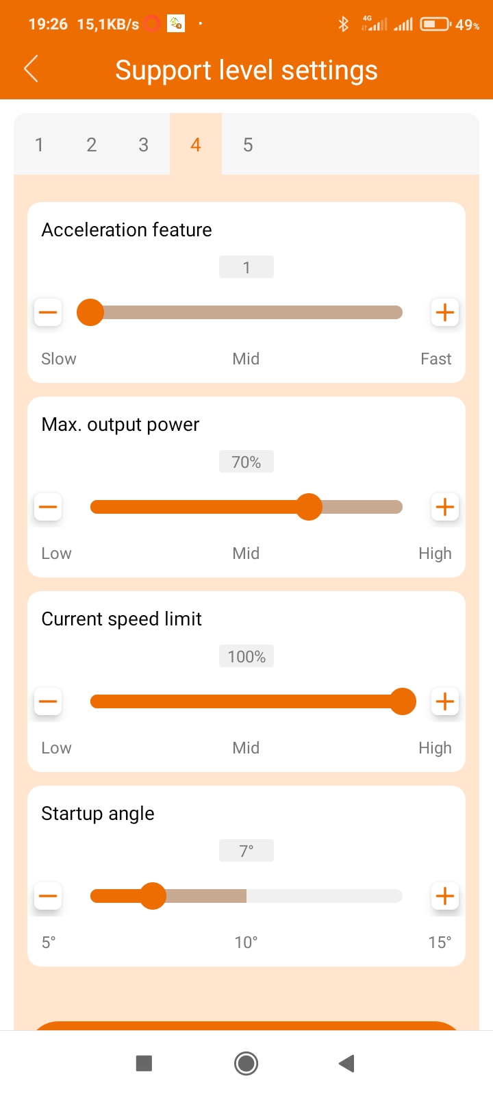

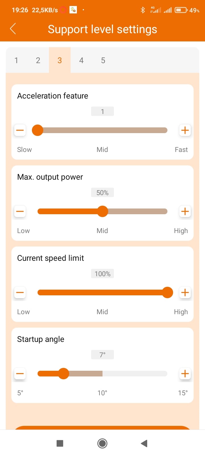

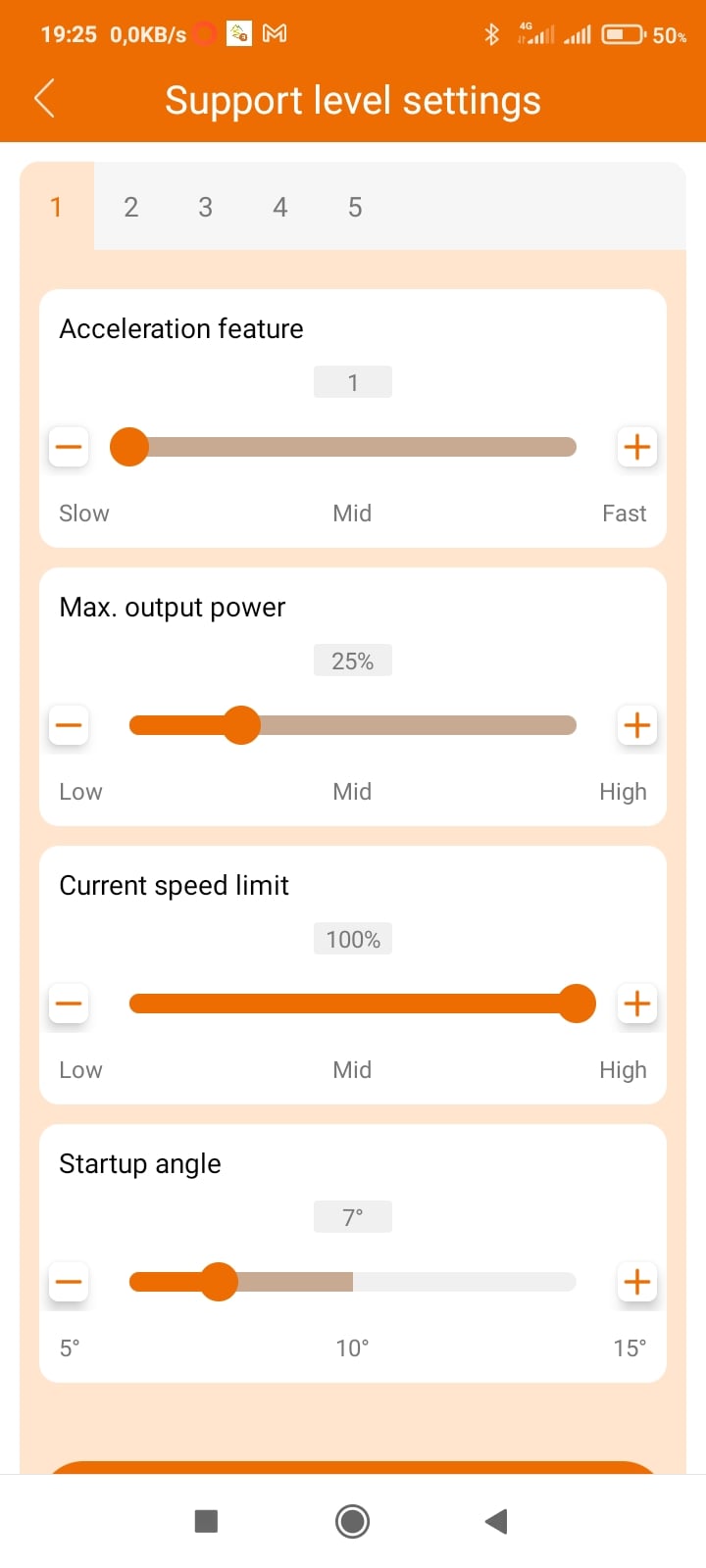

Hello
I have connected the Bafang GO+
application to my bike and I get what is seen in the following photos in the configuration of the different levels.
As you can see how it is configured (I haven't set it that way, it's how it appears when you connect it). Would you change something?
