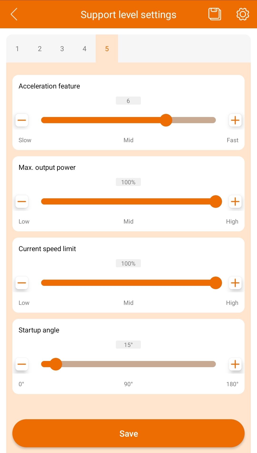

What does the setting "current speed limit" actually do? Could someone explain it?
I can try. It is again wrong translation from Bafang. ;) This parameter is max rotor RPMs.
So if your motor is reaching lets say 120RPM cadence max and you would set to 50% then your motor will end at 60RPM.
It does not have anything with your actual speed (due to rear shifter).
This RPM speed was also with UART motors and NO Torque sensor motors. I did understand it this way and can be tricky to explain:
Each rider has his own favourite cadence.
So you should set to start current decay (lowering power of motor) to this cadence (green dotted line in a graph - it is not exactly correct in a graph - that green dotted going over "Yes" means you pedalling over your set cadence ). Motor is then starting to ramp down power (with set slope - red dotted line) as you raising cadence by pedalling. Somewhere total power (motor+legs) equals to drag and you wont be accelerating any more. But must be properly set - Max rpm, Current decay slope and Keep current.
If you set to 100% motor will be pushing you to go over your cadence (just with turning the pedals) and you are forced to shift to harder gear and you again accelerating.
Hope makes sense a little.
With direct drive motors (single speed) you can control max speed of vehicle with max rpm settings in a controller.
With Torque sensor motors, this parameter somehow loosing meaning and all people do set to 100%.
So also curious, what is the meaning of this setting with Torque sensing motors.

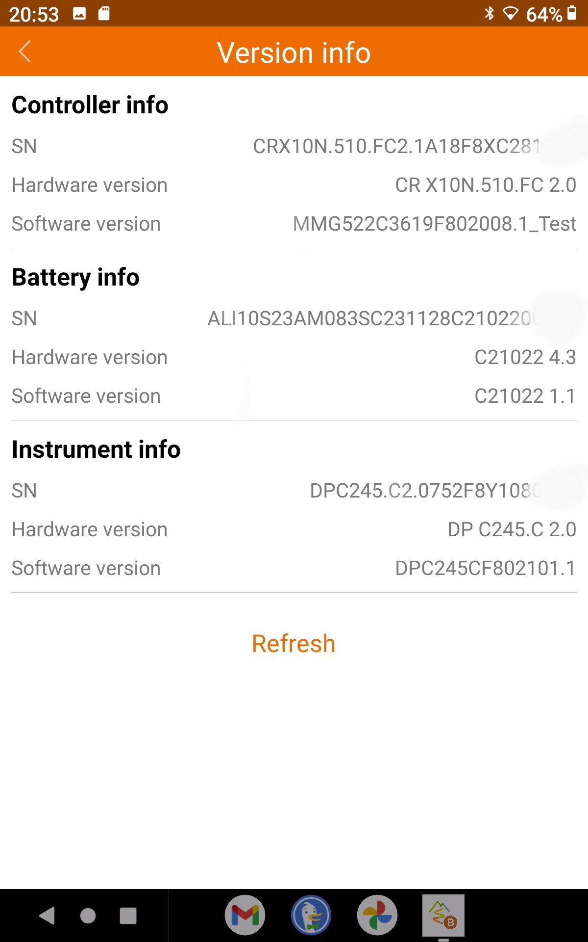

Hi all, I don't know if is just me but Bafang Go and Bafang Go+ works with my DP C245. C 2.0 software version 1.1 on Android 10 tablet. It allows me to set personalised ride too.
Has any of you successfully flashed controller or HMI using Bafang Go app with option "update firmware local" ? Thanks
sandokan
Aug 4, 2024
Slovakia
I asked Linda to check with Bafang.
Answer
Dear Mike,
Yes, DPC245 is 2.0 version, it only fit go, can not fit go+, version 3.0 is better. We keep asking bafang to offer the 3.0 version, but bafang do not start mass production for 3.0 version, and in the marker, there just only some version 3.0 samples, we can get version around Aug, thank you very much.
Best Regards
Strange my DPC245 2.0 SW 1.1 works with both Go and Go+ on android

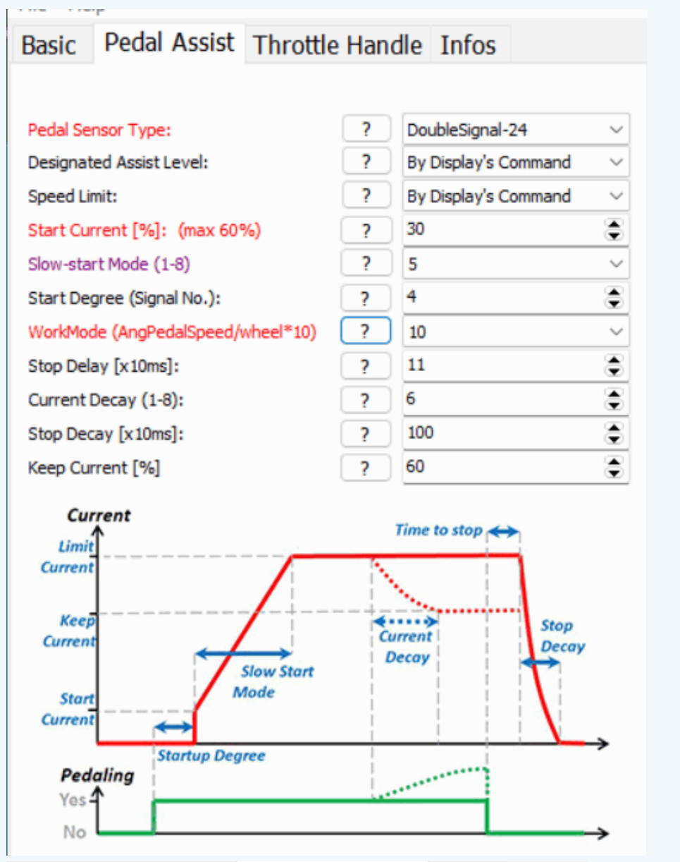

Is speed limit in besst tool = current speed limit in bafang app ?
Can you also explain acceleration and startup angle features (what are the pros and cons of setting it to 0% startup angle) ?
Hello.
Speed limit in Besst is real speed limit (just with basic password it wont allow you to set over 25kmh). In Go+ it is wrong translated, it is max rotor RPMs.
Startup angle, how much u need to turn cranks to start motor assist. if you set 0 degree, it will bee too sensitive and would kick even when you put leg on pedals. I have 12 Degree set.
Acceleration - how quick power will raise to needed value - ramp up time. At Acceleration 8 it should be 250ms according Besst graph. At level 1 it is over 2.5s

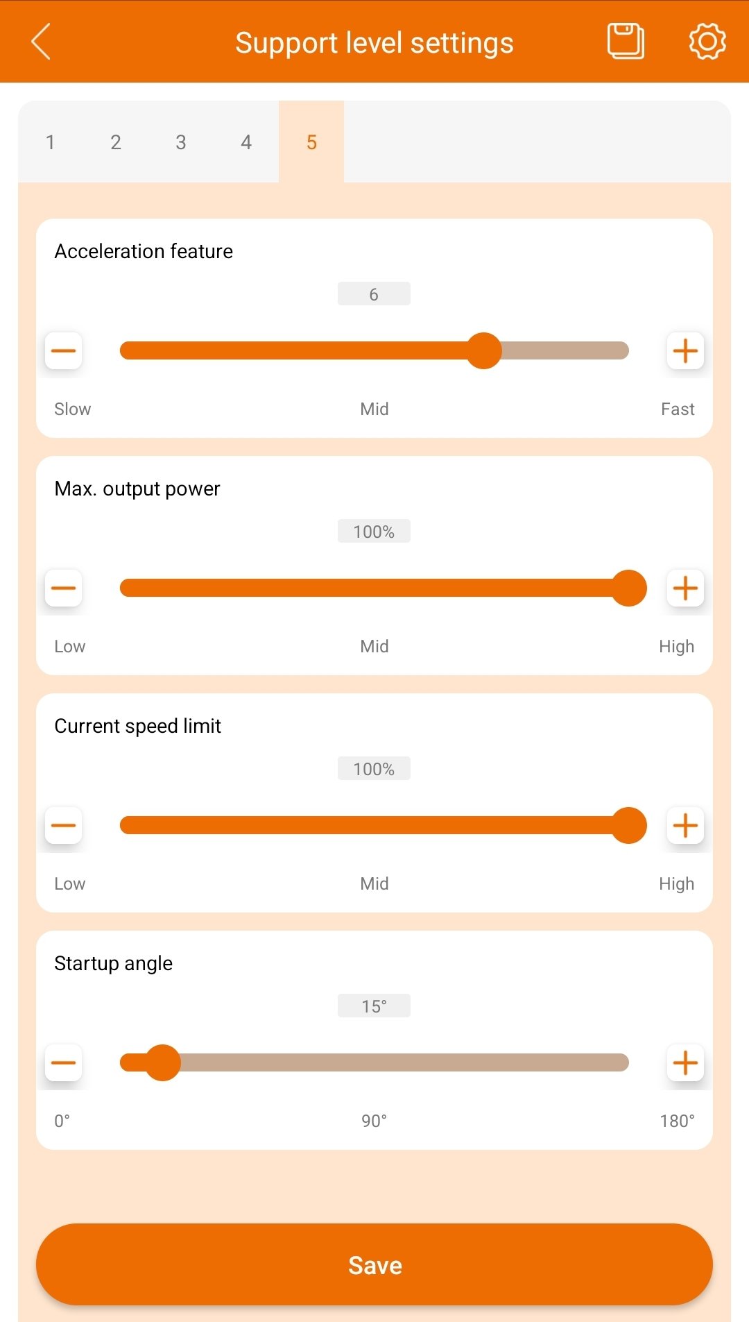

Just changed the startup angle. Won't save parameters. You have to go back to 2.2.0.
3.1.0 didn't work for me either but neither did 2.2.0, I had to revert to 2.1.0 to get it to "work".
"Work" is in quotes because:
TL;DR
While Go+ 2.1.0 appears to allow me to set ride parameters they are actually not working. They are saved and when I reload the ride parameters the last values I saved shows up but they don't actually make a difference. I was able to validate this with the @Dado K1 flash tool (awesome tool).
The rest of the story:
I purchased the K1 flash tool from @Dado and attempted to set the wheel size, circumference, speed, assist power levels, and startup angle. According to Go+ the only settings that were set were the wheel size and circumference. After emailing back and forth (thanks Dado for the excellent service) Dado suggested that I try setting the Eco assist level to 0 and see what happens.
First I tried setting it in Go+ which appeared to work and when I reloaded the app and restarted the display it showed 0, great works, right? Wrong, I still had assist, the same amount I had before I set it to 0.
Finally, I set Eco to 0 using the K1 flash tool and lo and behold there was no assist. I repeated this experiment 3 times and then set all of the assist levels to the values that I thought I had set using Go+ and wow, what a power difference. I had to tune them down a bit. I am confident that I will be riding in Tour mode rather than Sport mode for the majority of my rides.
I then proceeded to flash the 13A (43V) firmware (I had the 10A) and it went without a hitch. I am very pleased with my decision to purchase the K1 flash tool. I would have never known that Go+ is fake news.
Thanks @Dado!
P.S. I suspect that Go+ is saving the values but to the wrong parameters so they are persisted across restarts but ignored by the firmware. They must have corrected this in the newer firmware versions. If you are in doubt I would suggest setting Eco power to 0 and see if assist is gone. If not, you might need Besst or a K1.

Hello mate.
Many thanks for a review.
Yes, with Go+ are still some issues. Important is also to have fw 1.2. (Some users experience proper connectivity also over different firmware versions)
So you set to 0% and assistance is gone? Truth say, I have never tried this. In Besst there is lowest value 1%.
Good to know.
