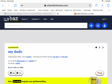

WTF does " my dude" mean?
Pdoz
Feb 16, 2019
1,112
1,206
Maffra Victoria Australia
Ahhh....it only takes a bit of research...
" my dude" has something to do with good wattevers?
