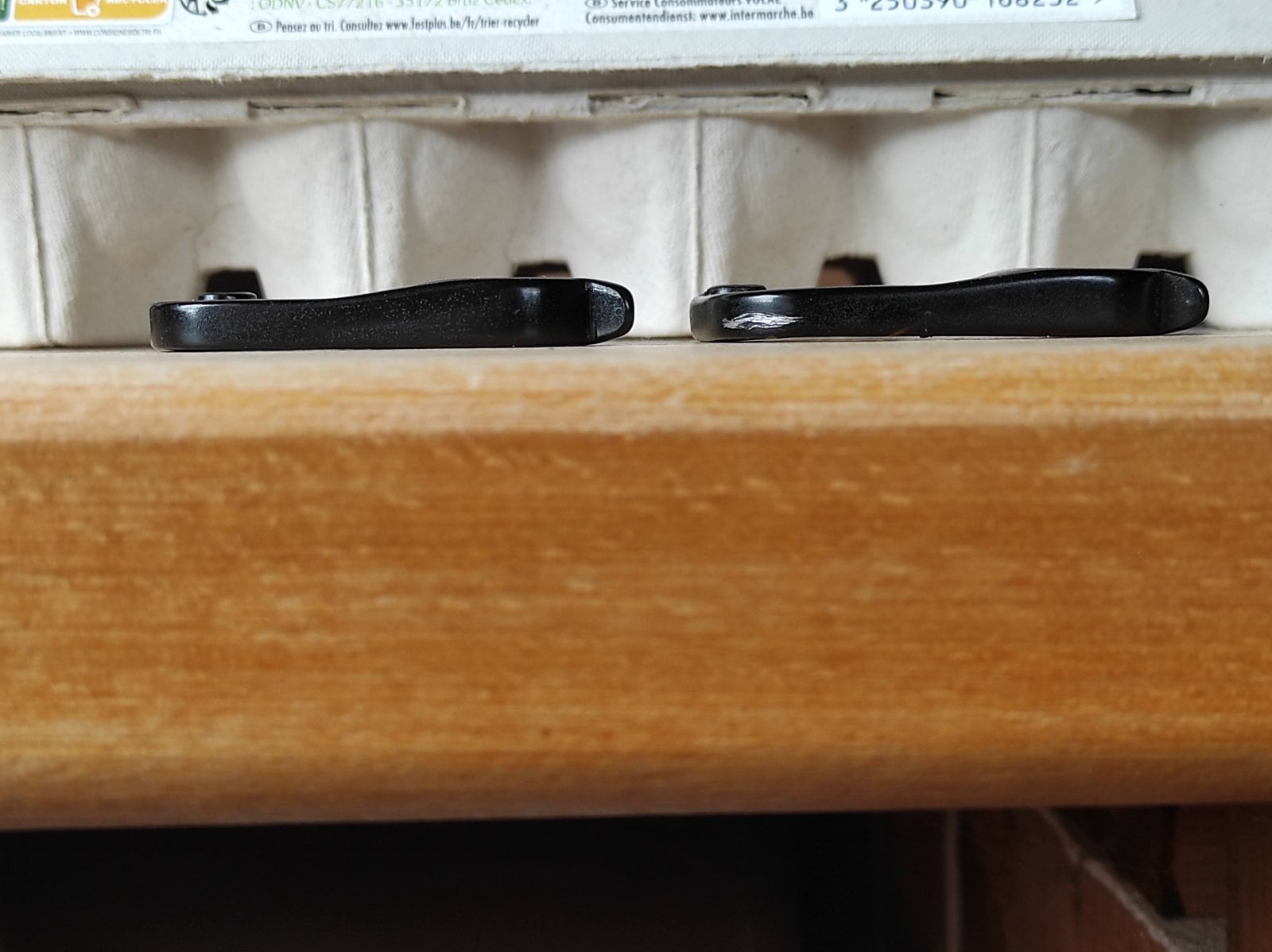

@Butane You might be experiencing Over Run. Several motors have this on purpose, Levo's/SL's and others. The idea is that the motor continues to spin for a fraction of a second when you stop pedalling to help you over a rock for instance. It might be a combination of that and how you're reducing your power that means you're still giving the sensors enough input that they're presuming you still want x amount of assistance.
There's all the other factors too which have been suggested, but also chain/cassette wear, Indexing, SRAM/Shimano technique bias.
As suggested I'd change the hanger for the tiny cost. I had something similar the other week, fine on the flat, only on hills. I was convinced it was fine - it wasn't.
