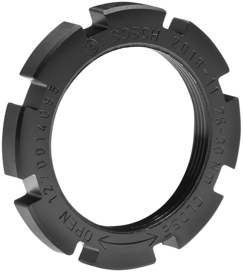

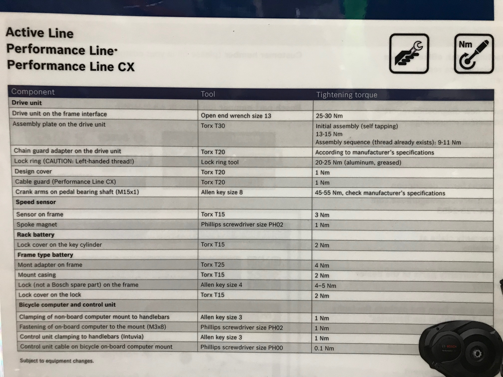

I'm a bit confused there. Do you normally check the torque on fasteners by undoing them? The Bosch spider locknut ring is a reverse (left hand) thread, so you tested it by undoing it.
It's only torqued to 25Nm against a rubber O-ring, so it's easy to undo (mine are Locktited in place).

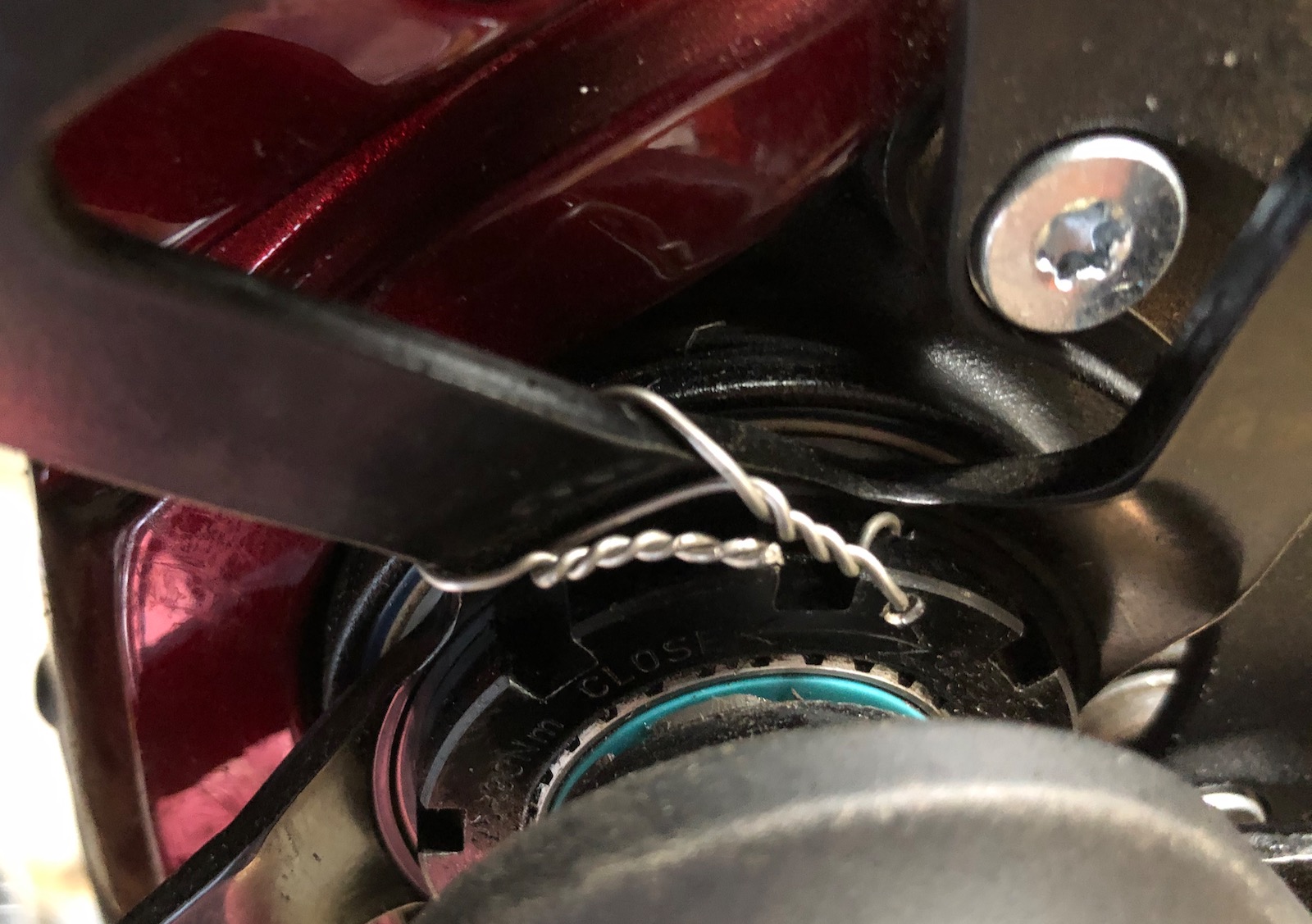

I wasn't checking it; it came loose on the second ride.
Now come the tools, safety wire and the fix.

25-30 Nm is stamped on my lockring, (2021 Rail 7)

Corrected: I had everything but the 36mm crow foot to go on the Park BBT-18 (it's on order), so I used about 2 US gallons of water pulling down on a wrench 1 foot from the spindle :)

So 30ftlbs. Not sure what a g/ft is.
32 ft lbs, which gives a torque of 44Nm. Which is around 50% above the maximum quoted torque. I understand that this directly tightens the motor bearings, which is why Bosch quote a low maximum value...
Thank you - I did the conversion backward - more work tonight. I'm glad I didn't ride it.

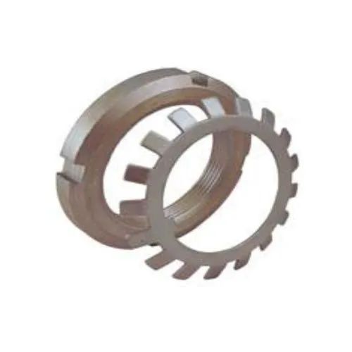

In other applications, I saw this lock washer to secure a toothed lock ring.
Could this be a solution ?

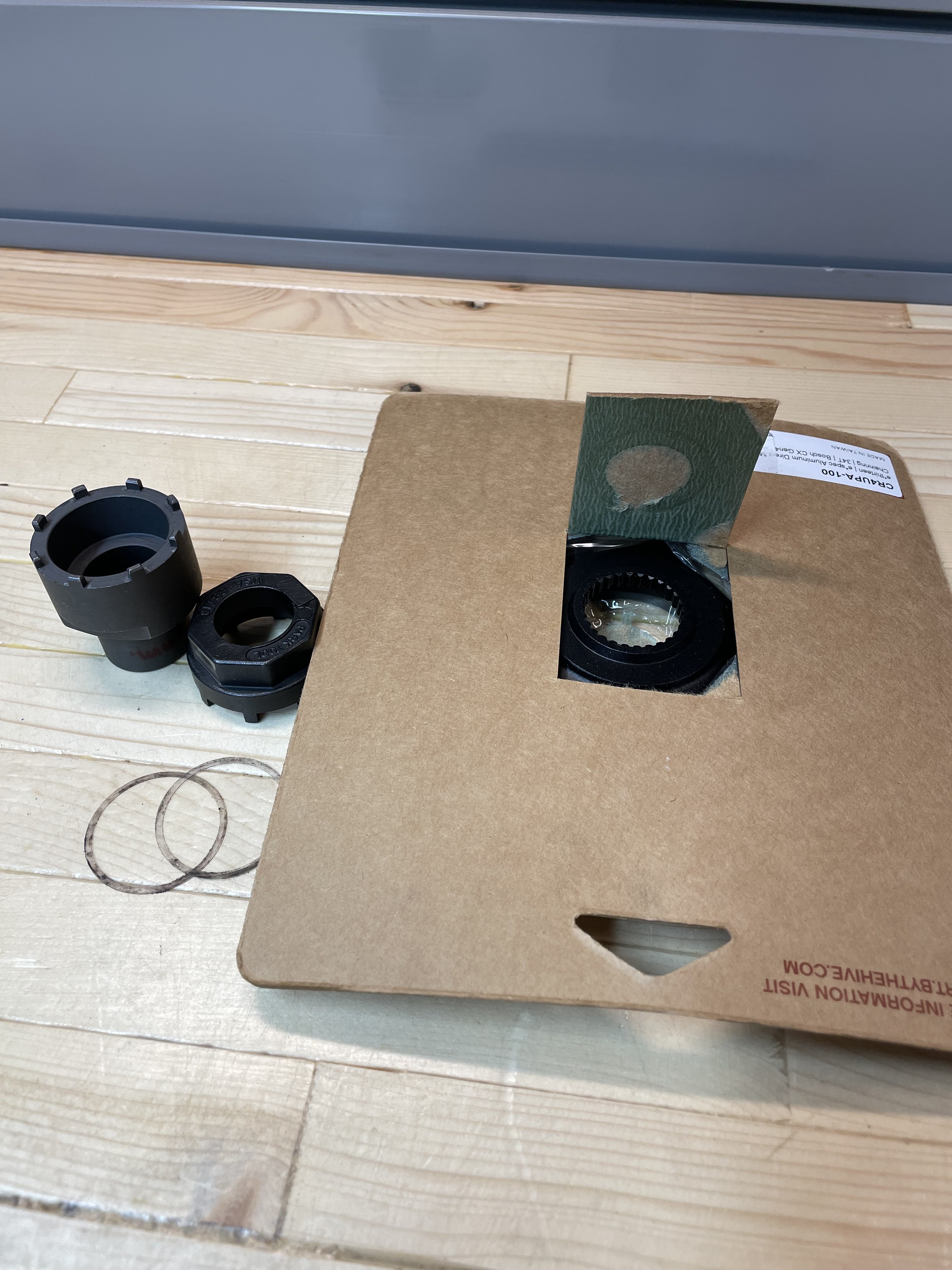

I replaced the original chainring with an ethirteen 34t. However on the back of the new ethirteen chainring an area extends out seemingly to replace a metal o ring. If I left the metal o ring in place the new ethirteen chainring would extend too far out and chain alignment would be wrong.
So I made a decision to reassemble everything without the metal o ring. I could have used blue lock tight on the castle nut but if needed. I torqued the nut to spec and I’ve had no loosening issues in the past year.
I had no reassemble manual for the ethirteen chainring, but without the original o ring(metal/brass ?) the chain alignment and castle nut fit was perfect.
Note how the new ethirteen chainring protrudes slightly on the backside. (I keep a spare).
Also pictured are two types of castle nut sockets. One works fine with a 1/2” torque wrench and the other needs an adjustable wrench or a specific sized socket or crow-foot. However, most of my maintenance/work is done while the bike is in the work stand and since the bike wobbles around the castle nut socket can slip off. Not to big a deal …but?
My point is. I’ve once seen a picture of a castle nut socket that has an alignment bolt which secures and holds the socket in place. But I can’t find it again, and no one knows what I’m talking about. Any ideas?
Anyways, a little blue lock tight around the threads of this nut won’t hurt …but fortunately I haven’t needed any.

Ok, now I remember. The o ring on mine was more like a metal spacer. With the new ethirteen chainring the metal o ring wasn’t needed or possible for correct alignment. There was however a blue rubber o ring which I left in place.
The entire assembly seemed kinda strange to me but it’s been working just fine for a long time. In the pic you can see two plastic o rings (very thin) that I didn’t install. Maybe these needed to go between the blue rubber o ring and new ethirteen chainring. Hmmm 🤔. I might have screwed up.…but the nut doesn’t come loose.
