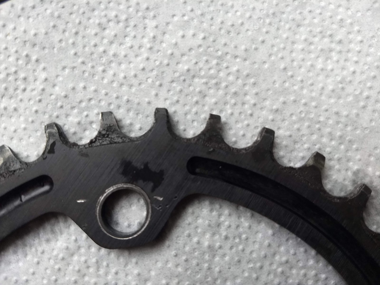

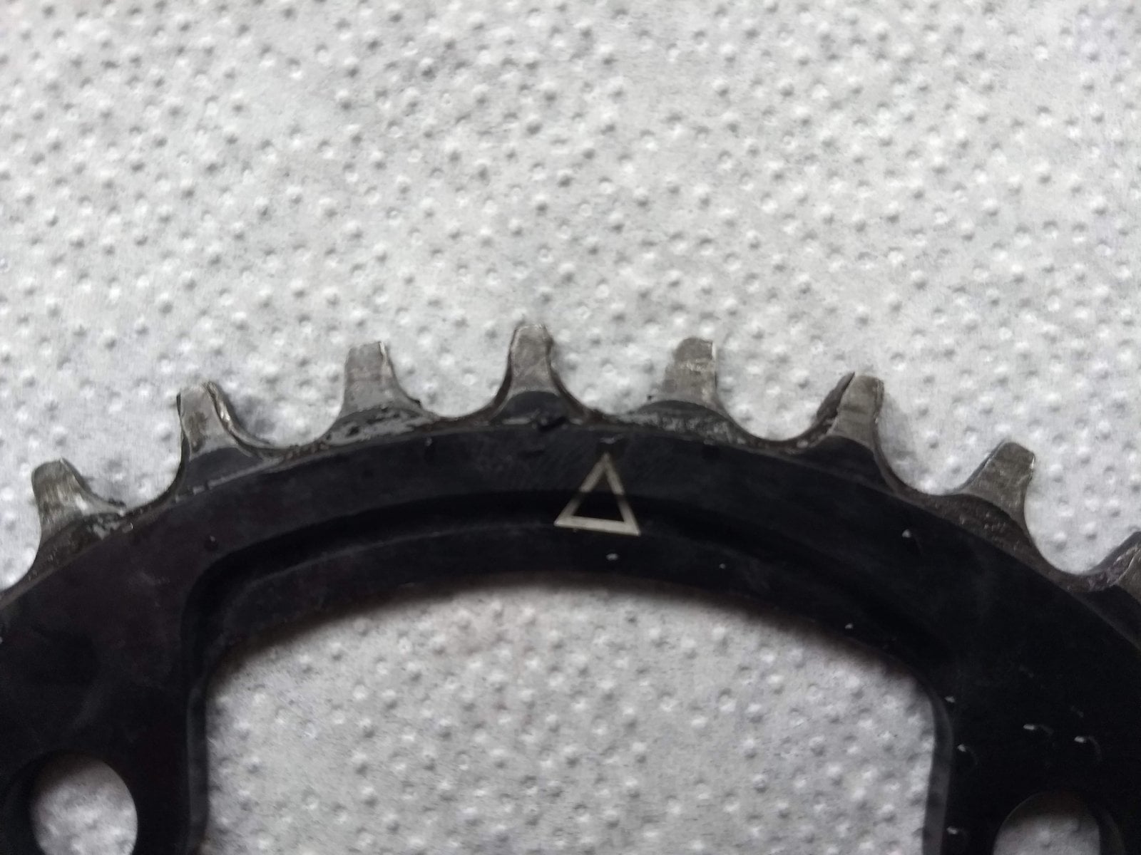

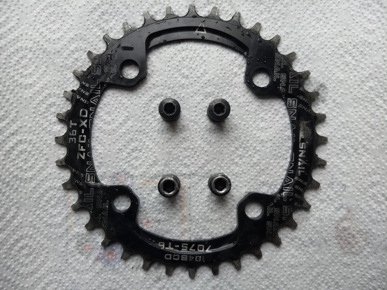

Got the ally one off ... I was going to spin it over and have it inside out temporarily, but it was such a pig to get off, I cant be bothered putting it back on.
The "nuts" don't have any slots and as I did it on the bike, it was impossible to stop them spinning.. grrrrrr ...
Anyway, excuse the photo quality, they're doing a shoot for next years bikini line in the studio and when I popped in to ask if I could just take a quick photo of my nuts and dirty ring I got shooed out and told I was disgusting, I guess some people just don't like bikes.
LE ring and bolts/nuts .. top two are the outside, bottom two are the inside - now looking less than pristine ..
Close up outside of ring :
Close up inside of ring :
I'm guessing that's about 600ish km's on that, with the chain being about 200km's ish old when it was installed .
Lube was Muc off dry, in the dry .. and Muc off wet in .... the wet ... though I think I used too much of the wet lub and didn't clean it off enough either .... MUPPET ! .. Lube was applied after every clean/ride.
I think @steve_sordy's favourite hobbie is tooth analysis .. and I'm sure @Gary can tell me bluntly where I went wrong :)

I'm guessing that's about 600ish km's on that, with the chain being about 200km's ish old when it was installed.
It's been a while since I've seen shark fin teeth... from just 600ish kayz, ouch!
Anyway, excuse the photo quality... LE ring and bolts/nuts .. top two are the outside, bottom two are the inside - now looking less than pristine...
Top two and bottom two makes FOUR pics, Zimmy.

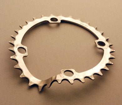

So what do you do?... you attach three pics!
Anyway, here's your missing photo... studio cleaned it up for free...
I get the "no clarity" award of the day there .... The two top and two bottom, referred to the 4 bolts inside the ring in the first photo :) ... it's either that or I was doing a special 25% off on photo's.....
