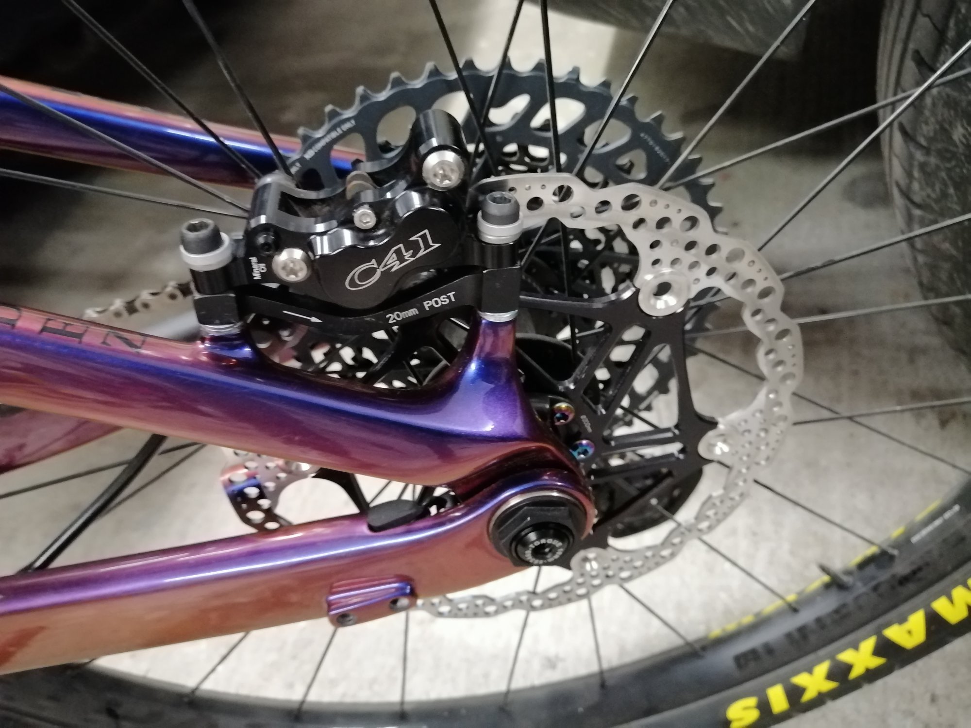

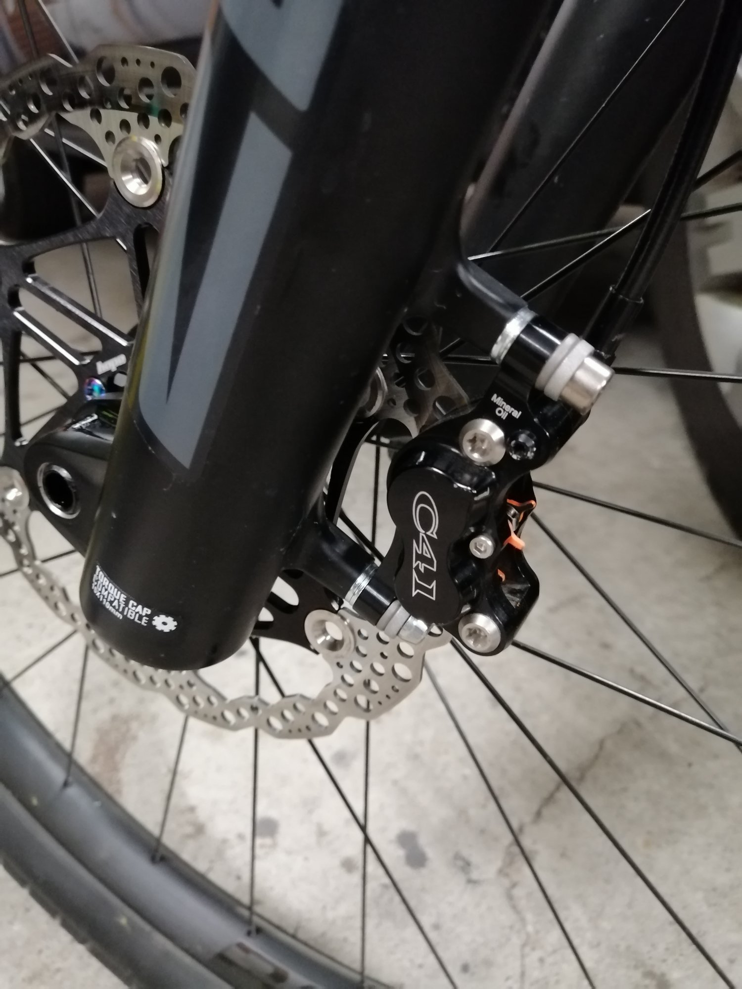

m4rmot
Mar 10, 2021
7
France
nice Trickstuff setup! How do you like them?
I placed an order last month for some of their Maxima brakes.
will you wait for 12 months for Maxima ??
They are really nice. I ever had Shimano / Hope / Sram / Formula brakes (never tried Magura)
In my opinion they are the best brakes I ever had

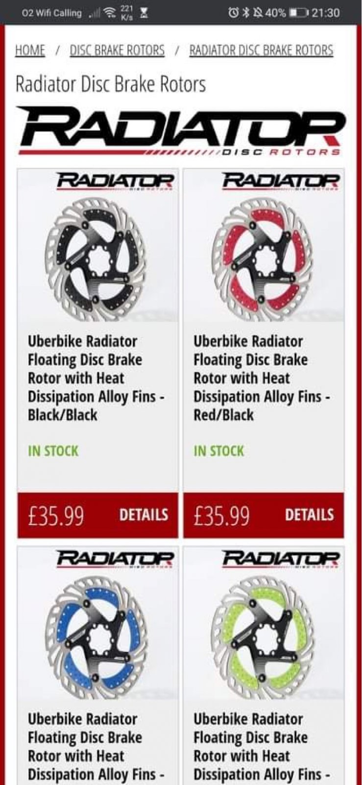

cheers they also do finned discs too but didn’t seem to look quite as high build quality, I’ll check those pads

these were ones I’d notice from Uberbike, 6 bolt but should I end up with a Rise then I’m thinking of trying this kind of thing out.

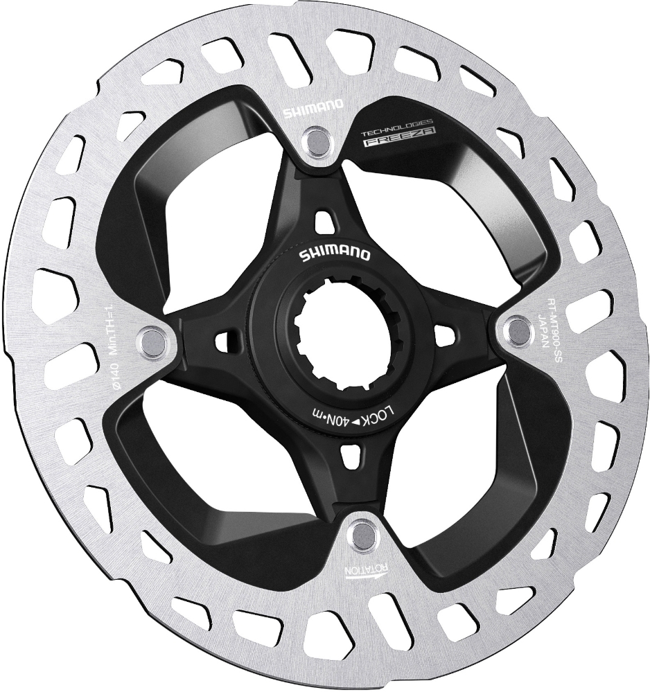

Shimano version claims to have upto 150 degree cooler than a typical stainless steel only disc….maybe just marketing blurb but I kinda like the look of them too ?
Mteam
Aug 3, 2020
1,919
1,855
gone
On the first set of finned pads I had (came with the bike), the backing plate and the fins were all one piece. No rattling!
yeah, the official shimano finned pads are one piece - the after market ones that I have tried have all been two piece.
