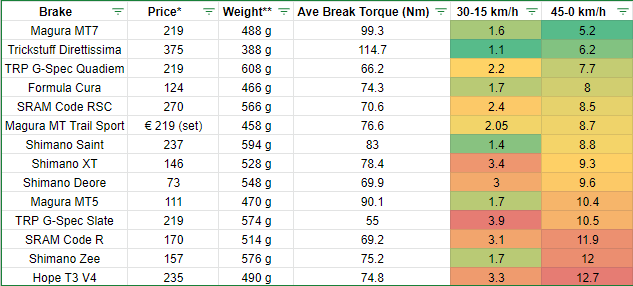

I've been trying to find out what brakes are the best performing and like anything else it's about subjective but here is black and white data. I bought some Zees but I'll be selling this on now and buying the Maguru MT7's after doing this exercise, maybe its useful for some of you guys or will bring about some useful feedback....
They also recommend fitting Trickstuff Power+ brake pads which on their tests offered 20% more performance and were quieter.
Overview
BrakePrice*Weight**Average Breaking Torque30-15 km/h45-0 km/h
Formula Cura€ 124466 g74.3 Nm1.7 s8.0 s
Hope T3 V4€ 235490 g74.8 Nm3.3 s12.7 s
Magura MT5€ 111470 g90.1 Nm1.7 s10.4 s
Magura MT7€ 219488 g99.3 Nm1.6 s5.2
Magura MT Trail Sport€ 219 (set)458 g85.1/68.1 Nm1.8/2.3 s7.6/9.8 s
Shimano Deore€ 73548 g69.9 Nm3.0 s9.6 s
Shimano Saint€ 237594 g83 Nm1.4 s8.8 s
Shimano XT€ 146528 g78.4 Nm3.4 s9.3 s
Shimano Zee€ 157576 g75.2 Nm1.7 s12.0 s
SRAM Code R€ 170514 g69.2 Nm3.1 s11.9 s
SRAM Code RSC€ 270566 g70.6 Nm2.4 s8.5
Trickstuff Direttissima€ 375388 g114.7 Nm1.1 s6.2
TRP G-Spec Quadiem€ 219608 g66.2 Nm2.2 s7.7 s
TRP G-Spec Slate€ 219574 g55.0 Nm3.9 s10.5 s
Tree - Hardwood€ FREE7000000gNot rated0.0 s0.0 s
Quite interesting, I was close to buying some hope brakes and looking to sell my Zees until I played around with the table a little and added a little colour scoring and filtered the fasted to stop dead from 45 km/h:
I know there's more to just raw data, but its a nice starting point! If this study is accurate then I should be avoiding the hope brakes and aiming towards MT7 (the new levers are meant to be nice) Those Forumla Cura look good bang for buck although they recommend the Zees for the most cost effective option if your on a budget!

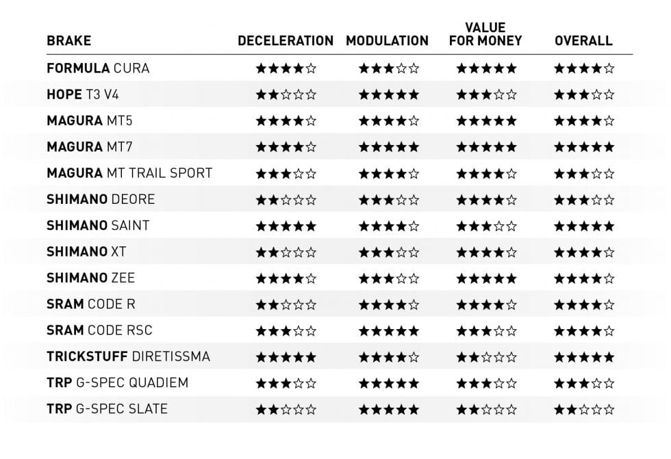

Finally here is their summary

How often do you brake to a stop from 45km/h on your mountain bike?
Are you finding the Zees wanting when braking?
I've not tried them, sending back I think or selling.

I did wonder why they did the mix, there will be a reason I imagine, maybe it's to dampen the brutal breaking power of these brakes?
Zees were £200 plus the adaptor, MT7 are 1/3 more but clearly very good, all positive regarding mt7 here and some negative about the zees.....comments here of just a select few aren't the be all ofc, useful but you still need to check sources like this report (or others) too.
