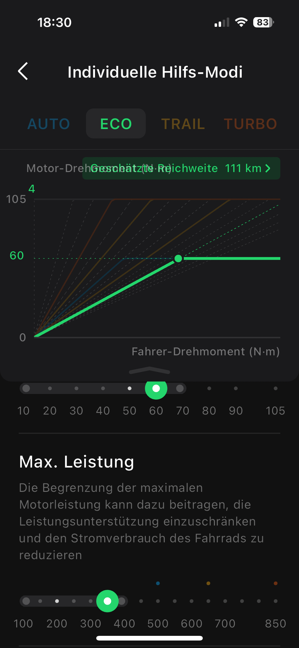

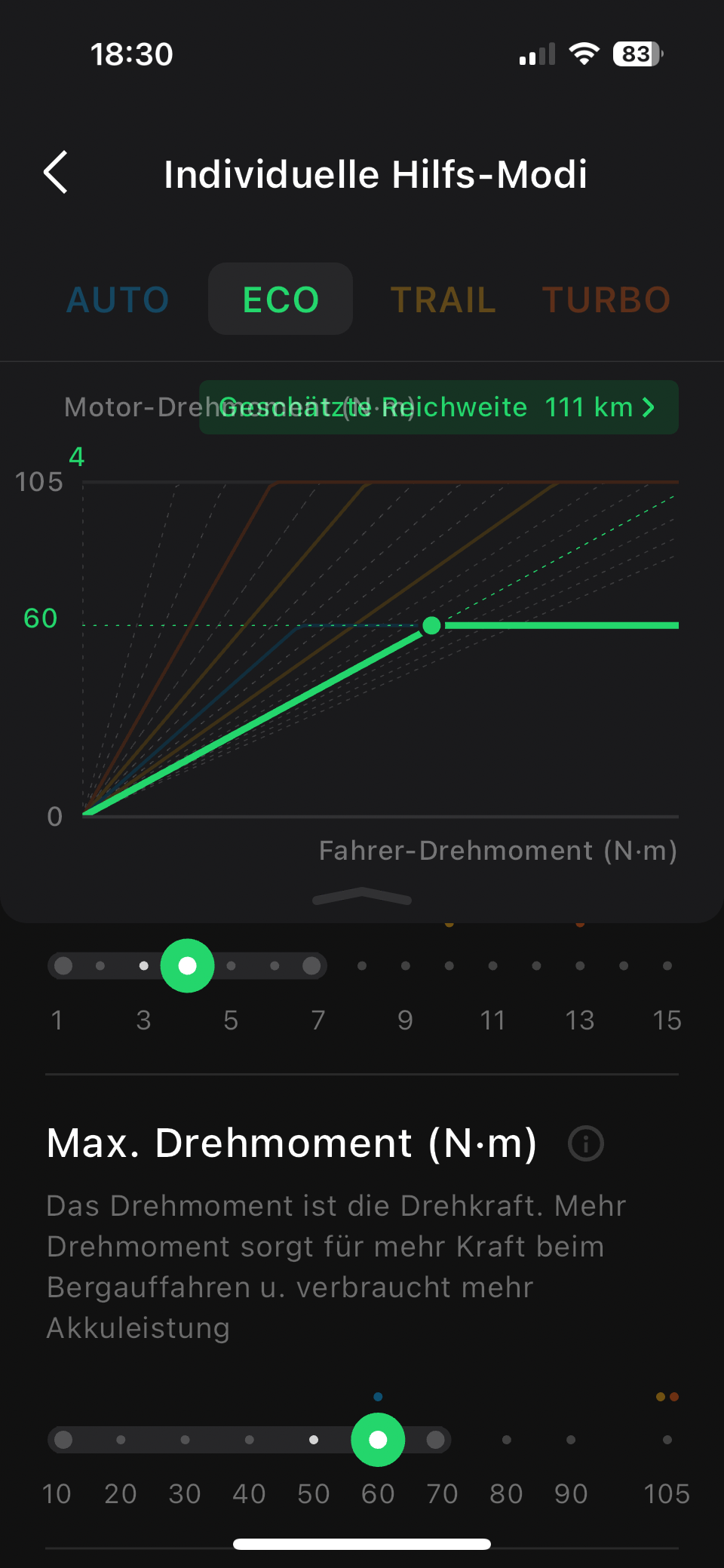

Yeah it's a bit odd. But back to my original issue of eco to trail being a massive jump. So is editing the nm the wrong way to go and it should be the assistance ratio that needs tweaking to bring them closer together?

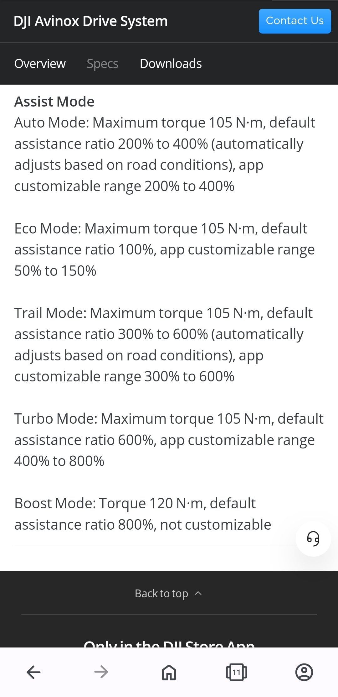

Yes the assistance ratio is the one to tweak for noticeable power changes but it only has limited ranges.
I have mine set with eco as high as possible AR5 nm70, auto at minimum AR7-8 nm70, trail reduced slightly to AR9-10 nm80, turbo AR12 nm105.

Thanks. I think that's where I've been going wrong then. I've come from an Orbea Rise which just had a simple nm setting in the app. Eco 20, Trail 40 and turbo 60 were my settings. So when I've seen the Amflows eco set at 50nm it didn't seem that powerful after knowing what 40nm felt like on the Rise. I'll have to have a play with those assistance ratios and see what happens. Thanks for your help 👊🏼
