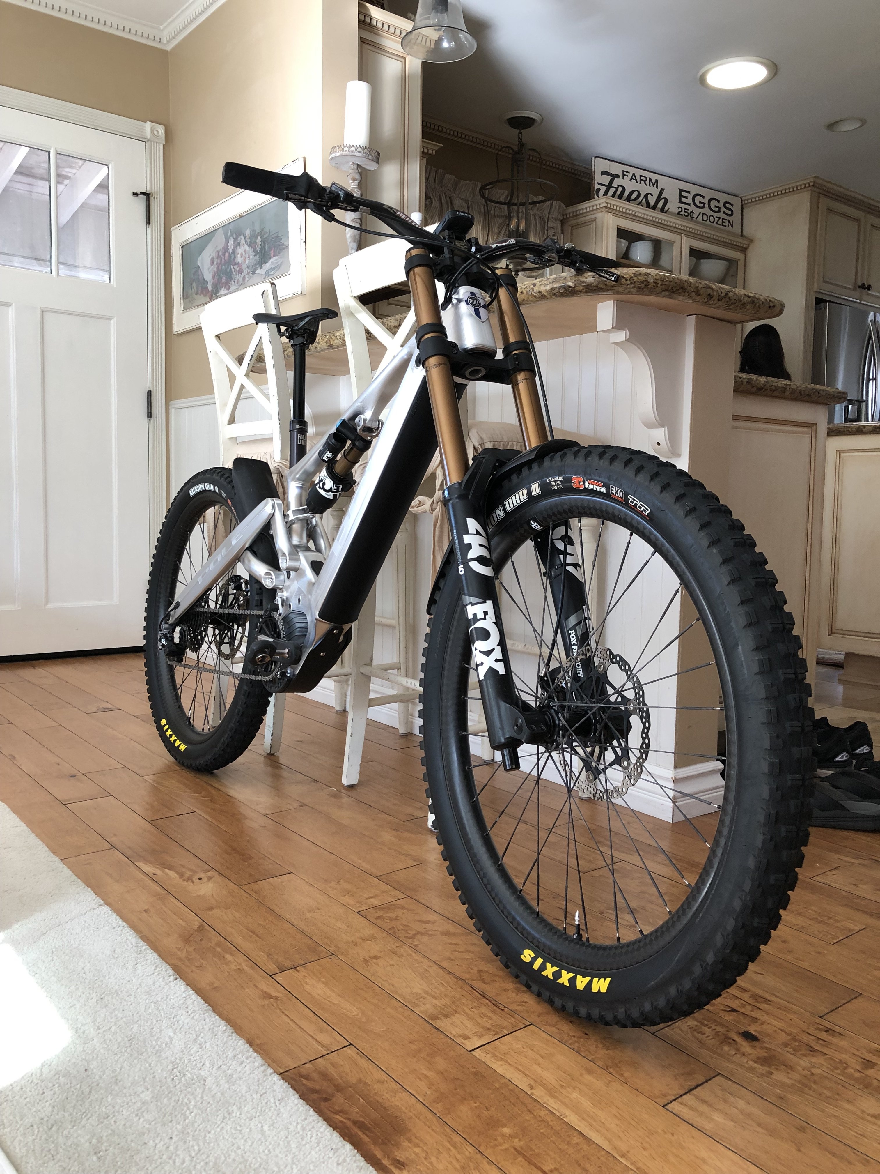

It’s all in the build. Every single part was picked to be as light as possible, while still being durable for me. Link to build below. 🍻
2023 Pole⚡️Voima⚡️Race Pack
I love your light weight build. But it doesn't suit my style so I can't get to the same weight bike as you.
The 10-42 cassette is to small, I climb super steep stuff and need a 50T. I'd smash the LB40! to bits (i've already smash my meat bike LB wheelset twice, E needed something stronger), I need a dh casing in the rear, want 29er front, berd would be too flexible, I run flats, 150 dropper is too small.
Every one of those things adds up to more weight... I wish i had your weight bike though. It would be awesome until I smashing something.
Different strokes for different folks! I guess I’m pretty lucky in that I seem to be able to get away with light stuff that most people can’t. I’ve also had no problems climbing up super steep stuff with my 11 speed 10-42 x 32 and the 27.5 x 2.8’s. The Bosch race motor makes easy work of that. But I also had no climbing problems with my previous Voima with the regular motor either. I think the steep 80* STA and 40 helps keep the front end down too. And I’ve also not had any issues breaking anything riding the blacks or double blacks at bike parks or my local trails at speed, (old man speed). But I’m pretty competitive when it comes to DH, so I’m always pushing the limits as soon as I get to the DH. I’m like Ricky Bobby, I like to go fast. 😂 IDK if it’s line choice or my MX background or whatever, but luckily I’ve always been pretty easy on my wheels, (ps, the Berd’s don’t really flex, but they do absorb trail chatter and vibrations nicely). Anyway , keep your shredding action shots coming too. ✌🏻😎

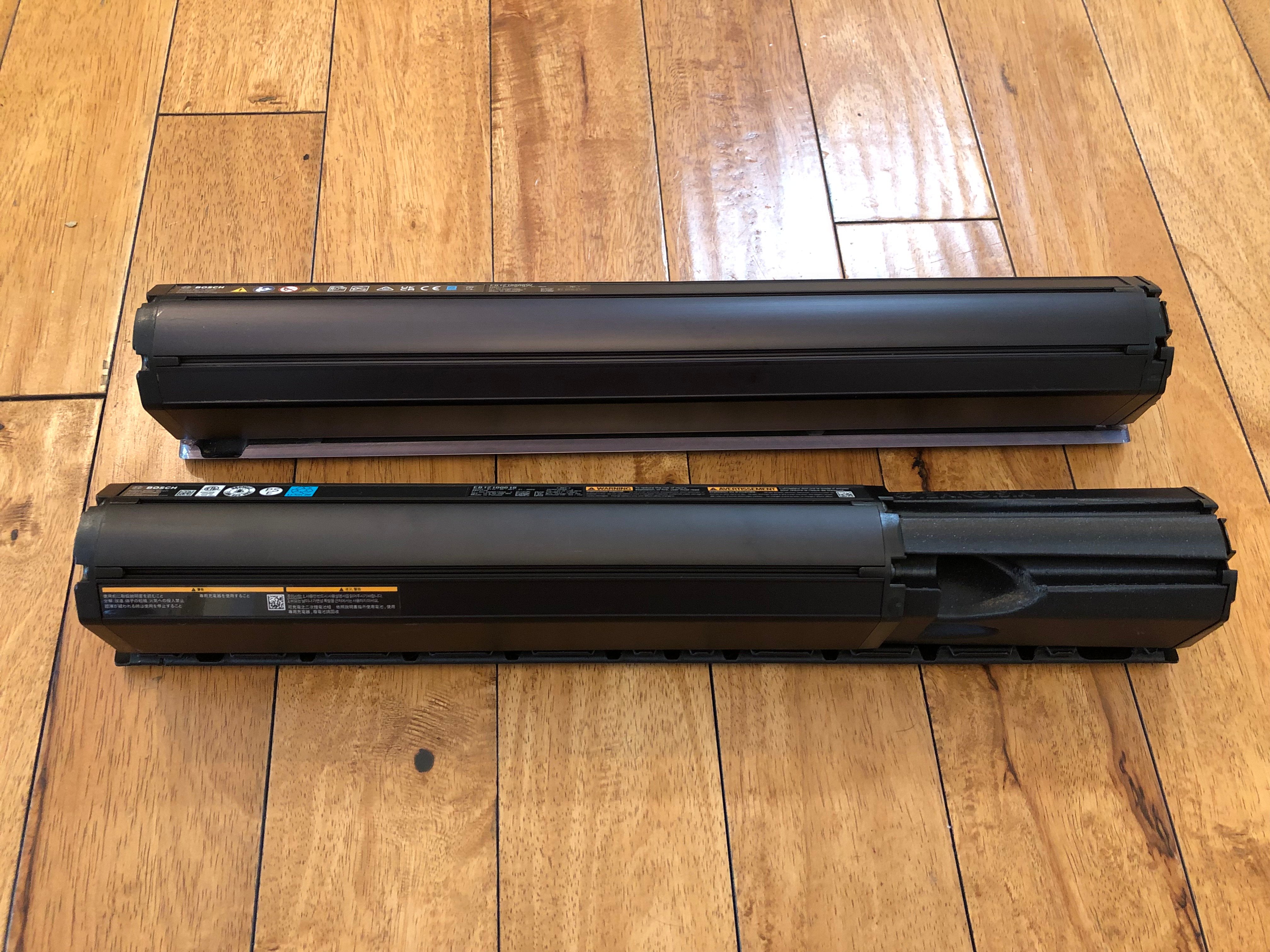

Just to give an update, I decided to get the 500wh battery and tested it out on a couple of trails. It's not a night and day difference by any means, but I do notice that the bike feels more lively and fun, especially on flat-ish technical parts of the trail where you have to work to build speed. It's a bit easier to pop off of stuff and change directions too. Overall, I'm pretty happy.
The battery swap ended up reducing the weight by 2.5lbs, not 3lbs -- so 50lbs 10oz vs. 53lbs. Of course, now I'm trying to figure out how to reduce the weight even more. I think I can save another pound or so by getting a lighter wheelset and maybe another pound by replacing the 1x12 GX AXS with 1x11 XO1, lighter cranks, etc...maybe for Xmas. :p

I actually just picked up my 500w battery last night, so I haven’t ridden or weighed it yet. But I was At 50lbs before the swap, so I should be around 47-48ish lbs since I’m already running lighter wheels, cranks and XO1/XX1 11 speed. I’ll post up pics and scale shots later. 🤘🏻😎

😂👍🏼 Thanks man. When it comes to the wheels and tires, it comes down to rider preference and riding styles. Luckily I’ve always been pretty easy on my wheels so I can get away with lighter wheels and tires. Also my rims are 40i so I get plenty of sidewall support from the wide rim and large volume 2.8’s. I actually did back to back runs years ago with 2 wheelsets, (2.4’s on 32i rims vs 2.8’s on 40i rims) and the 2.8’s on 40i wheels were night and day better, faster and smoother for me. So I’ve been running them ever since.✌🏻😎

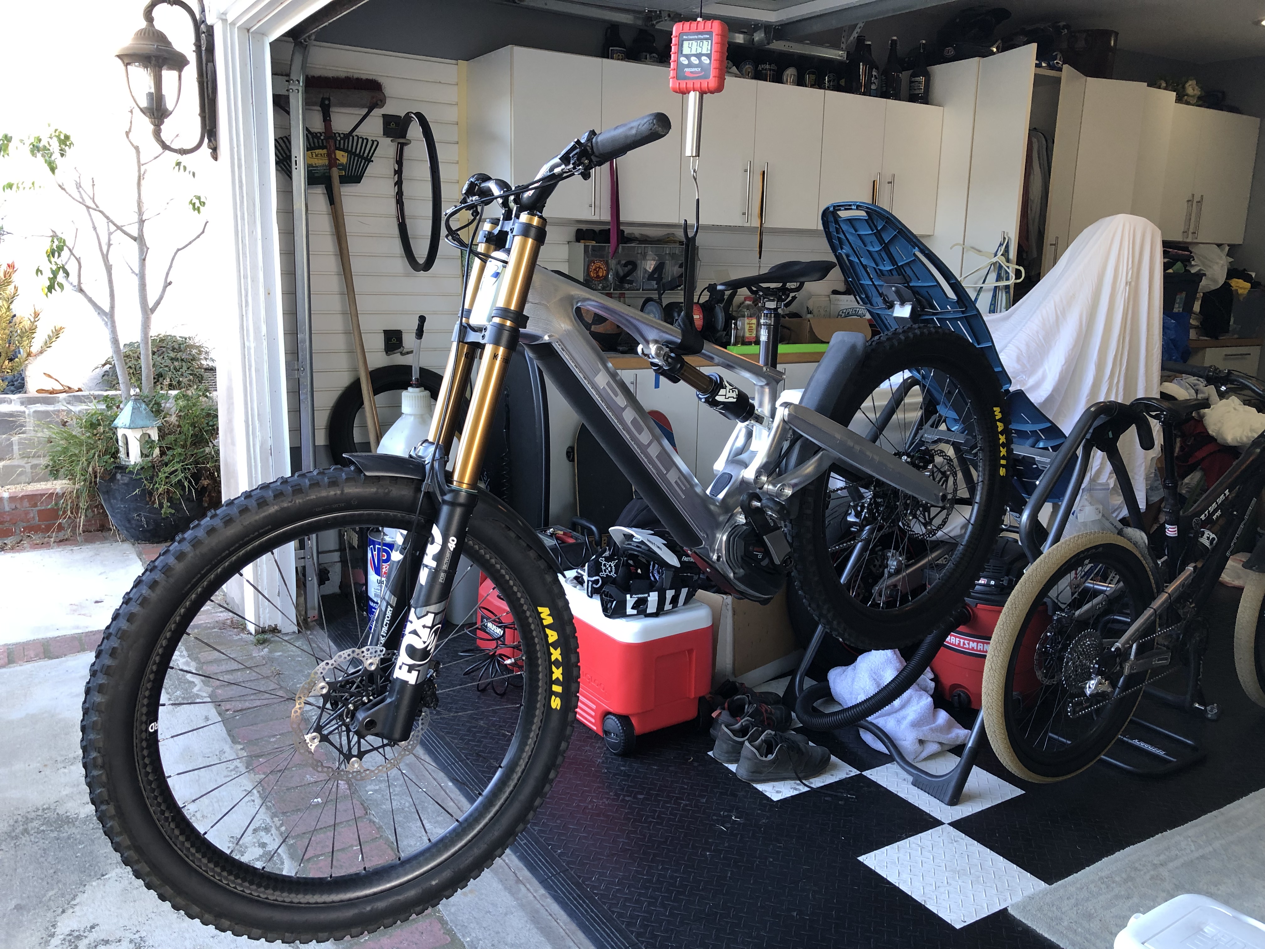

The bike was 50lbs before the swap, with the 750 battery, stock Voima battery cover and no fenders. It’s now 47.97lbs with 500w battery, Vision Velo battery adapter and cover as well as front and rear fenders. A 48lb Voima! Can’t wait to ride it and feel the difference!
