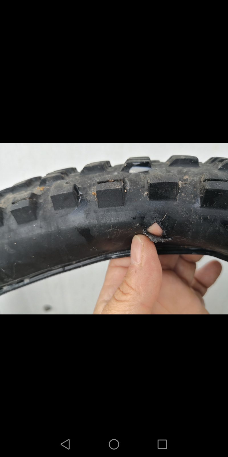

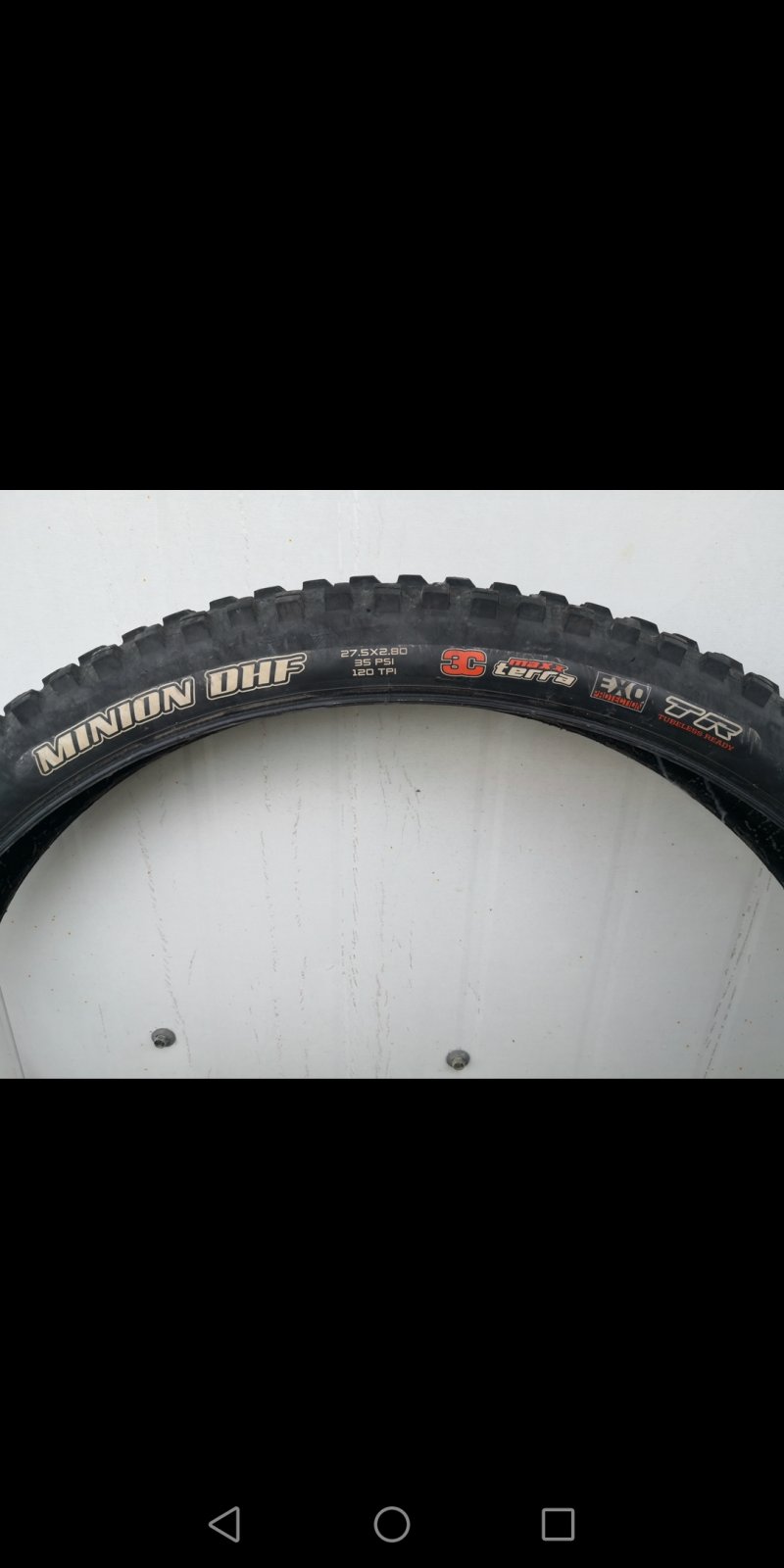

I love minions! They have been my favorite tire for 15 years or more.. so after wearing out my stock butcher on front, went with the loved dhf! Loved the cornering grip and better handling... But then a couple months ago tore a huge hole in the sidewall on a nothing! Of a little rock.. despite running cushcore on front and back! thought it was just bad luck...? So replaced it with a new one.

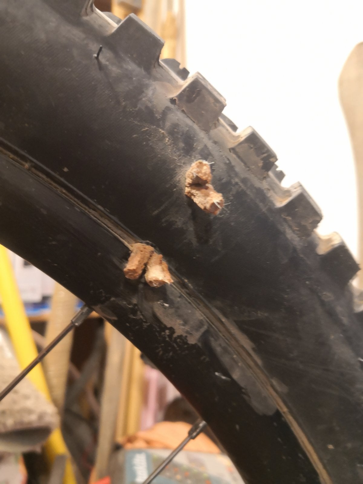

After wearing out my verry! Successful butcher double down on the rear..which for most of it's life did just fine at low pressures with no cushcore.. figured a dhr was called for..(don't know why..) so I put one on the rear, running the same pressures as the butcher, didn't even last a month! Till a few days ago I tore two holes in the sidewall at the same time!
I think Maxxis is trying to make these tires lighter at the expense of the sidewalls.. as they are verry! Vulnerable. Even the standard butchers are better.. and never tore a sidewall, even before a put cushcore on! With even lower pressures!
I'm not getting another Maxxis till they come out with a 2.8 DD!!!
