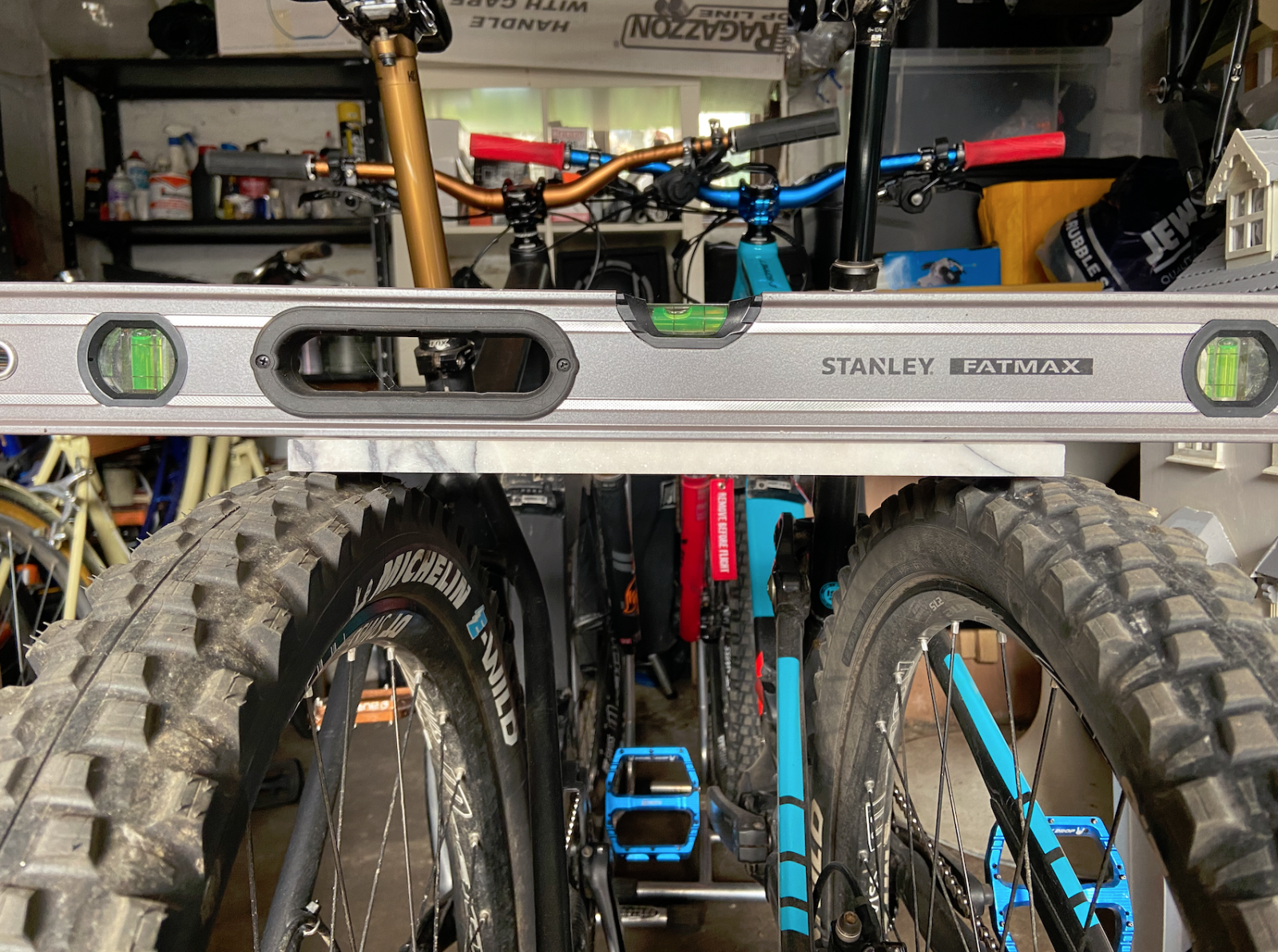

How much difference is there between the 2.8 and a 2.6 e wild in height of the tyre? Anyone care to measure for me please ?

I have 2.8 E-Wilds and 2.6 E-Wilds running the same pressures (22psi) on the back of different bikes, will measure them later for you.

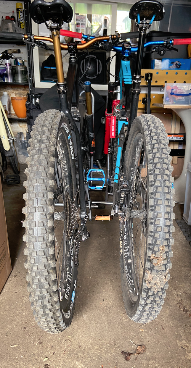

So as best I can work out after several attempts there about 5mm difference between the 2.6 and 2.8 E-Wilds in terms of rolling diameter - They are both fairly new, however my 2.6's are more worn than the 2.8's which where only fitted recently, prob double the miles on the 2.6. Main difference is the width obviously. Also if you are running a 2.8 at a low pressure out back it may actually be less of a diameter than a slightly smaller tyre at a higher pressure.
Both tyres on same 30mm rims and 22psi
Anyway the main benefit of smaller tyre out back is that its going to be less sloppy, more direct handling, and more supportive if railing into corners.

^^^ R120 … love posts like this! (y)(y)(y) Great info. Wish I could thumbs up this one 10 x :cool:
I've got a set of Michelins on order that was supposed to be here last week :)unsure: .. no courier names needed here) .. and this post helps a lot. They are 2.8's but I like the analogy of height vs. air pressure on the 2.8.
I agree that you will get "used to" pedal strikes and compensate with time. I destroyed a brand new set of flats (and ripped out countless pedal pins) after 2 months of riding my decoy but rarely have any pedal strikes now … but it will take time to adjust. A lot of it has to do with finding the proper air pressure and settings in the X2 rear shock.
Great work posting these photos (y)

Nice job.
5mm doesnt sound much but it could cause a few more strikes.
I'll have to give it a go and see what happens.
