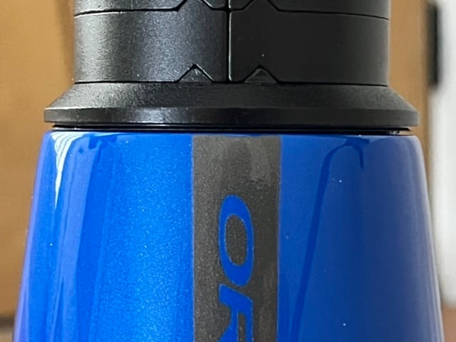

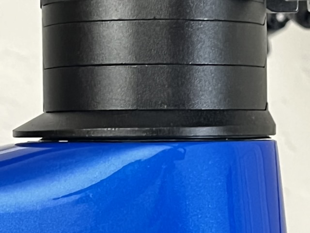

Could you take another picture where it shows the gap in front? It seem like you don’t have so much space between.

What type of headset do those bikes use? Integrated ( IE no separate cups) or some form of separate cup ( either zero stack zs, or external cup ec)?
A lot ( but not all) bikes that use an integrated headset end up with a gap like that,its not ideal but it is normal ( for bike that end up like that) and not indicative of a fault.
Bikes that use zs and ec should have zero gap.
:) ...never sure what the heck is meant by integrated or semi integrated!! All my bikes have the type of headset arrangement where the headtube has built in faces (plus the steerer tube race) for upper and lower bearings to sit on ( so I guess that is what they mean by integrated.........or maybe semi integrated)!! . Worse case scenario is to change a couple of bearings......but I only buy ally bikes and would not buy one with cables going through the headset! Never had to change bearings.........all I do is clean and grease twice a year. My Whyte E160 RSX uses FSA 55/35 Orbit 1.5 ZS (1.8 and 1 1/8 bearings).

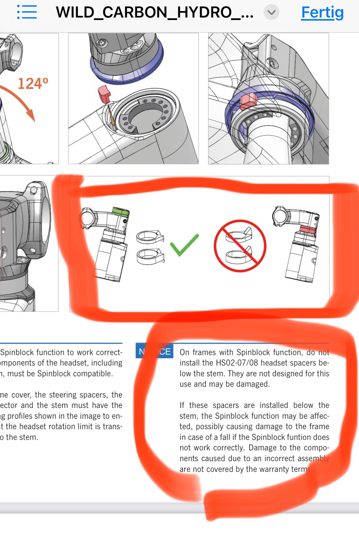

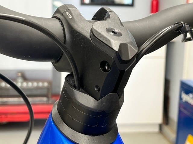

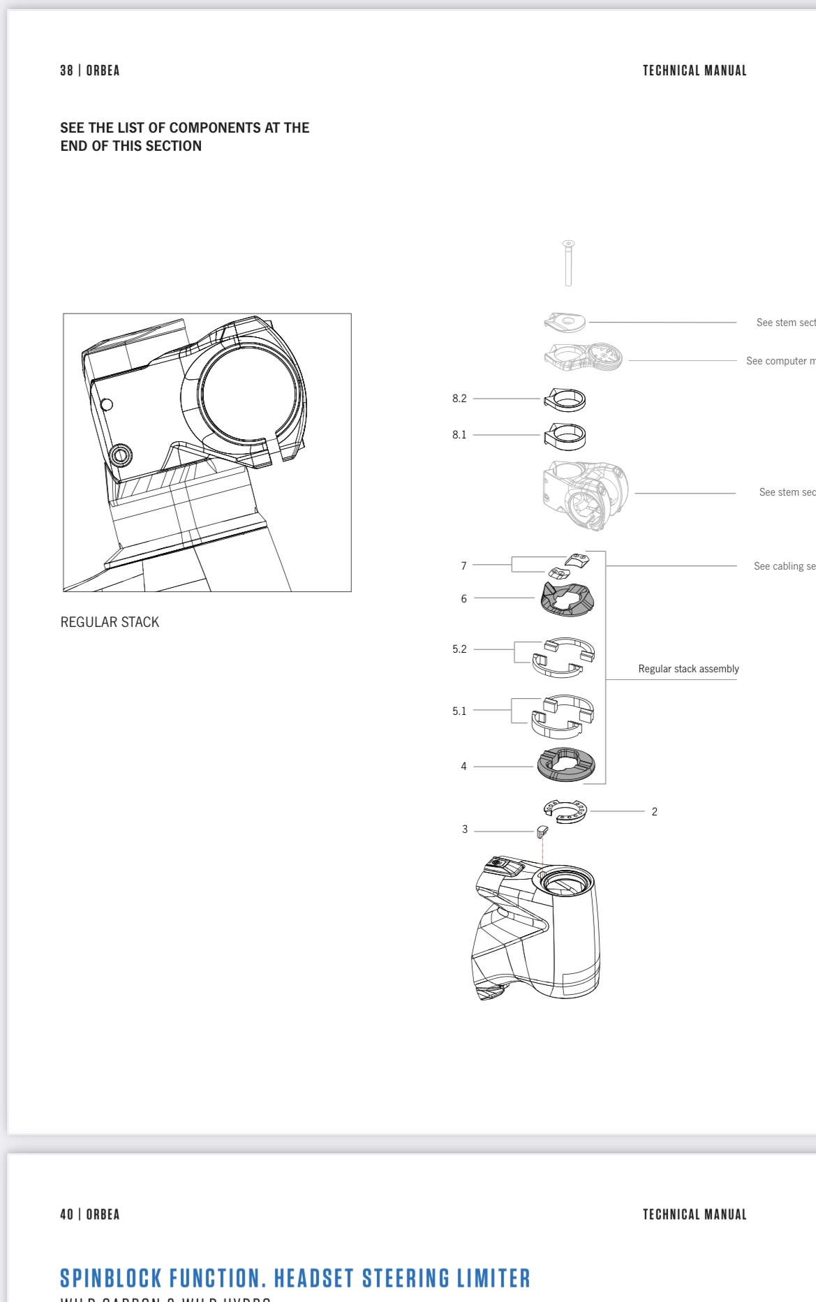

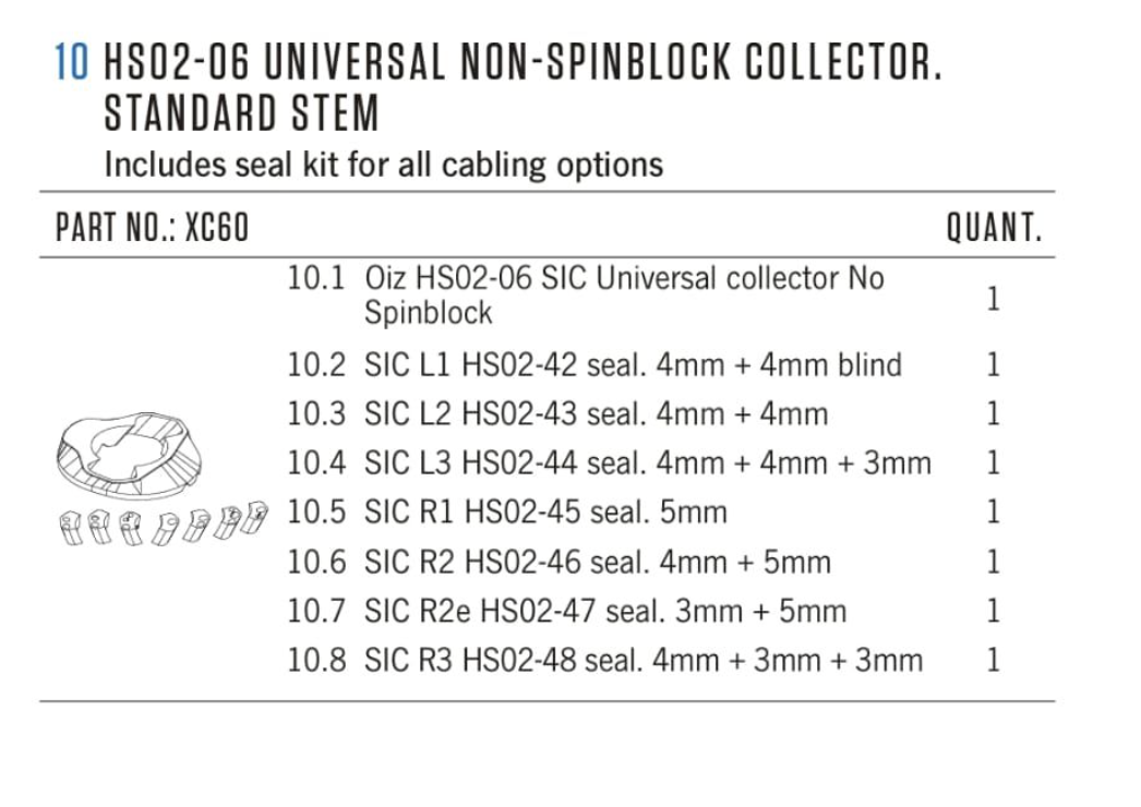

Morning Rob, just wondered if you'd be in a position to find out any further details of a release date from your contacts regarding my email below. ORBEA haven't got back to me yet....
"Our new 2023 Wild models use the new HS02 headset standard. This HS02 system has been created primarily to:
  • House the Spinblock headset lockout system.
  • SIC system for cable routing underneath the stem.
About the option of mounting a standard spacer under the stem, with 2023 Wild's original mounting it would not be possible, as it uses specific spacers that are profiled and serve to transfer the headset lock that the spinblock makes.
We will soon offer a universal SIC adapter (without Spinblock function), to mount standard stems.With this adapter we believe that you can mount a standard spacer and stem.
To mount this adapter, you would have to go to an official Orbea dealer. They will carry out and verify that the installation is correctly done"
Thanks
Asking now
