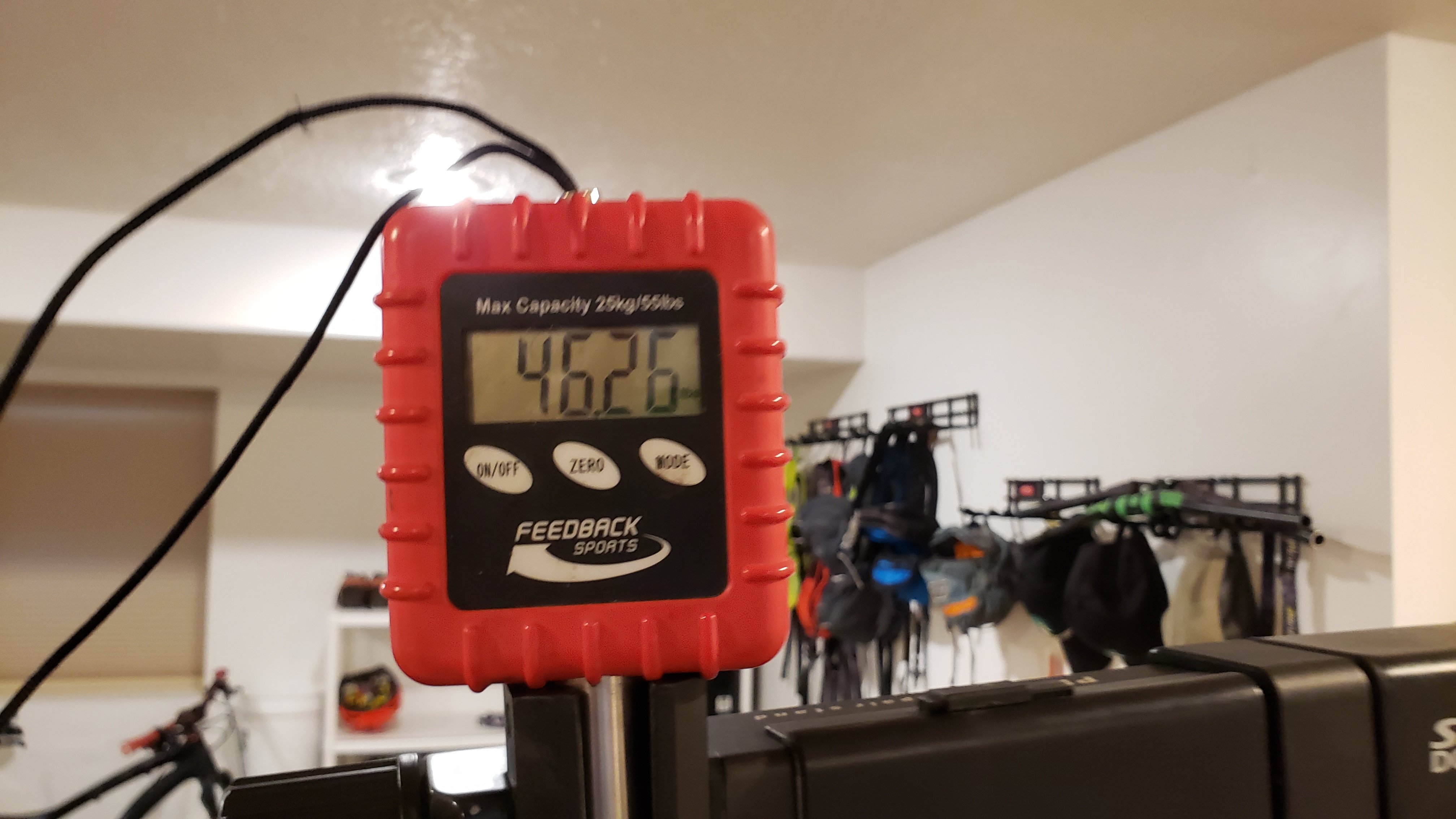

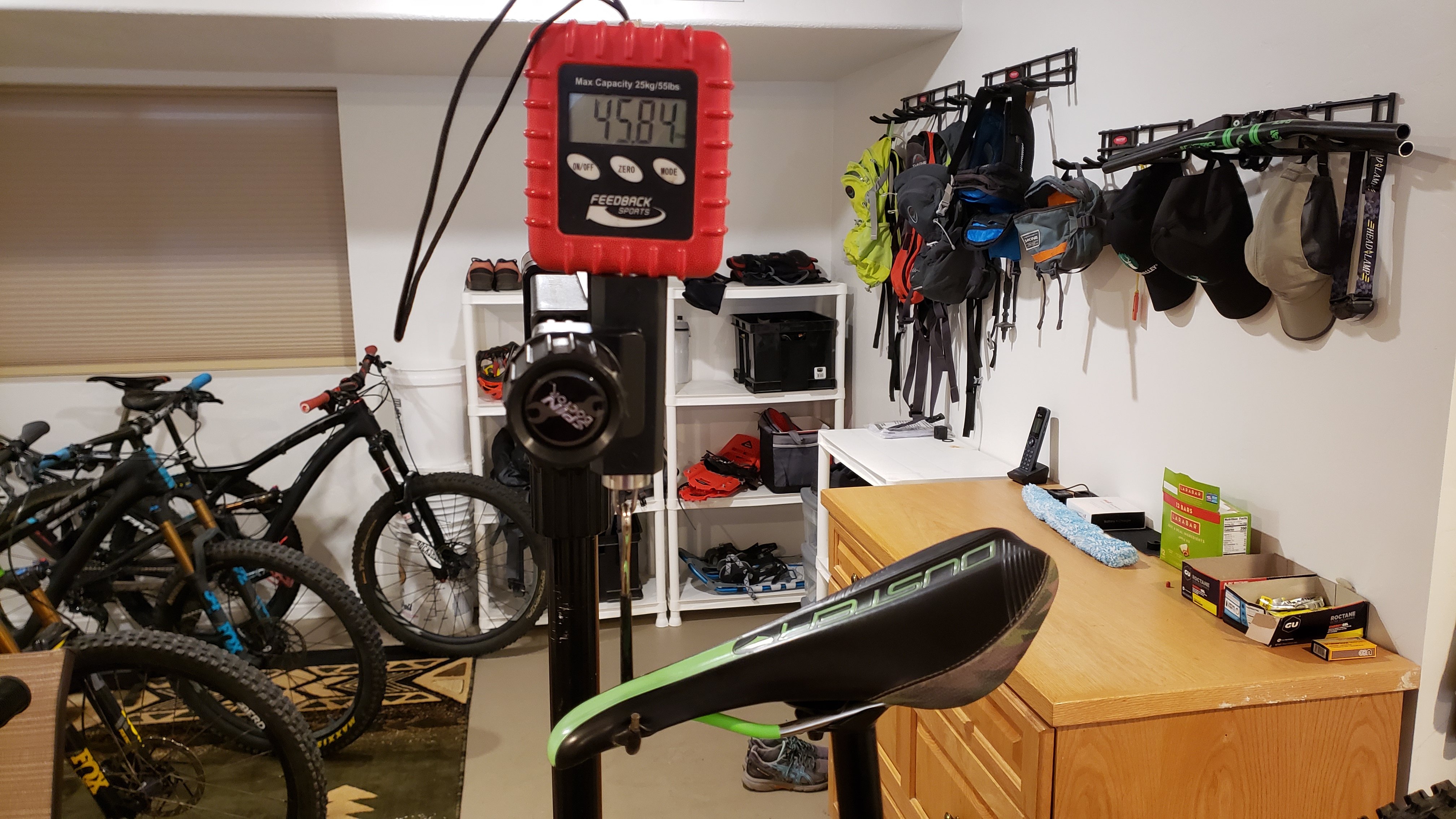

Pulled the trigger on the Elite 3 in a medium. Haven't taken it out yet.
Also, I'm not inclined to weight weenie out a 46 pound bike, but I'm at the height limit for the stock saddle/dropper. With a Duster saddle, I get another 5mm to play with. It also drops about .4 lb. I expect if I were to throw my One Up bars on, it would drop it down quite a bit as well. I doubt I'll do that, but you could drop weight pretty easily, if that's your goal. I'm actually okay with the stock saddle, so that's going back on. (And this is with large Crank Brothers Stamp 1 pedals.)
View attachment 114968 View attachment 114969
Congrats! That’s a reasonably priced model. Thanks for weighing it for us. Looking forward to your ride impressions.

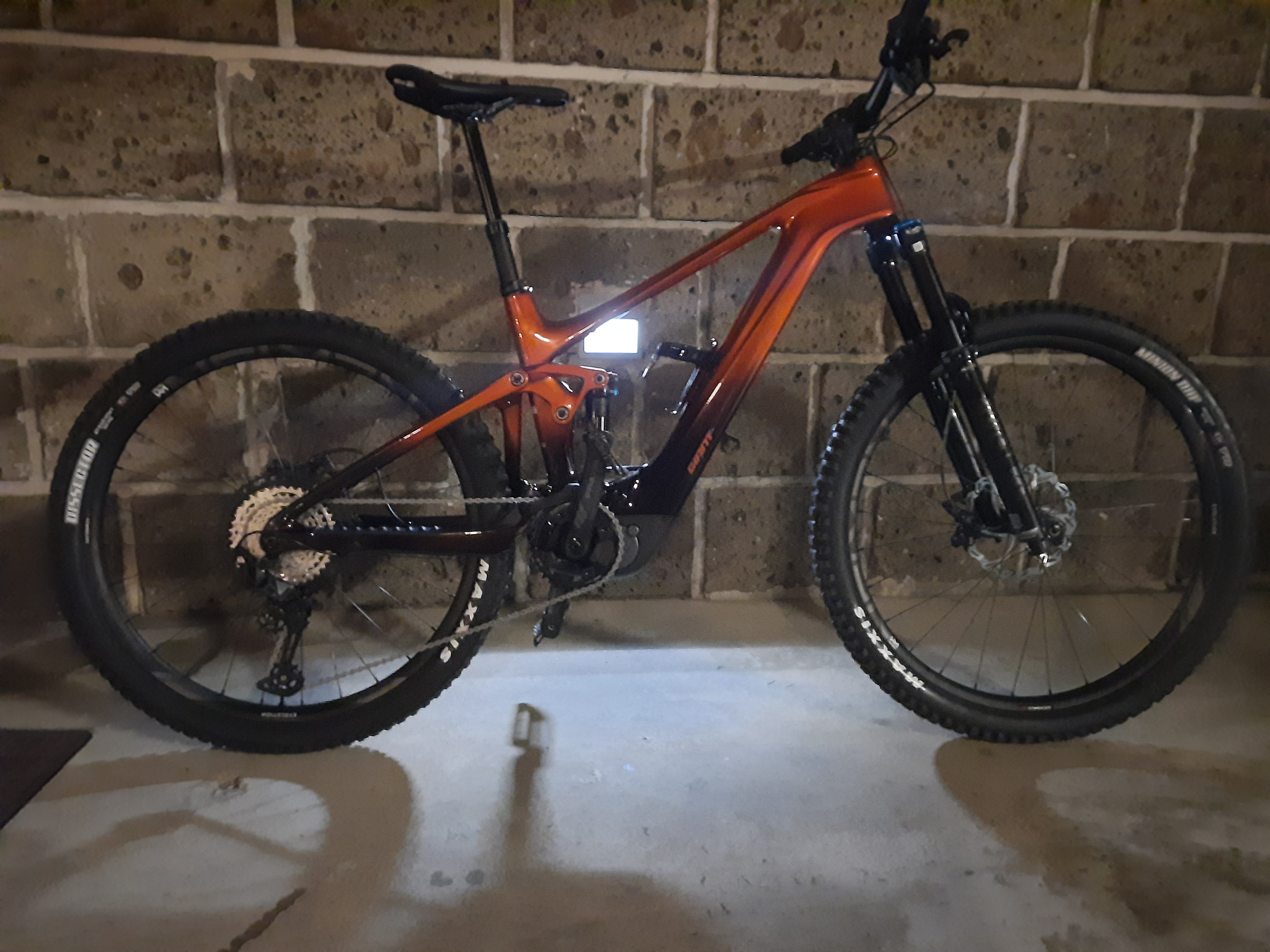

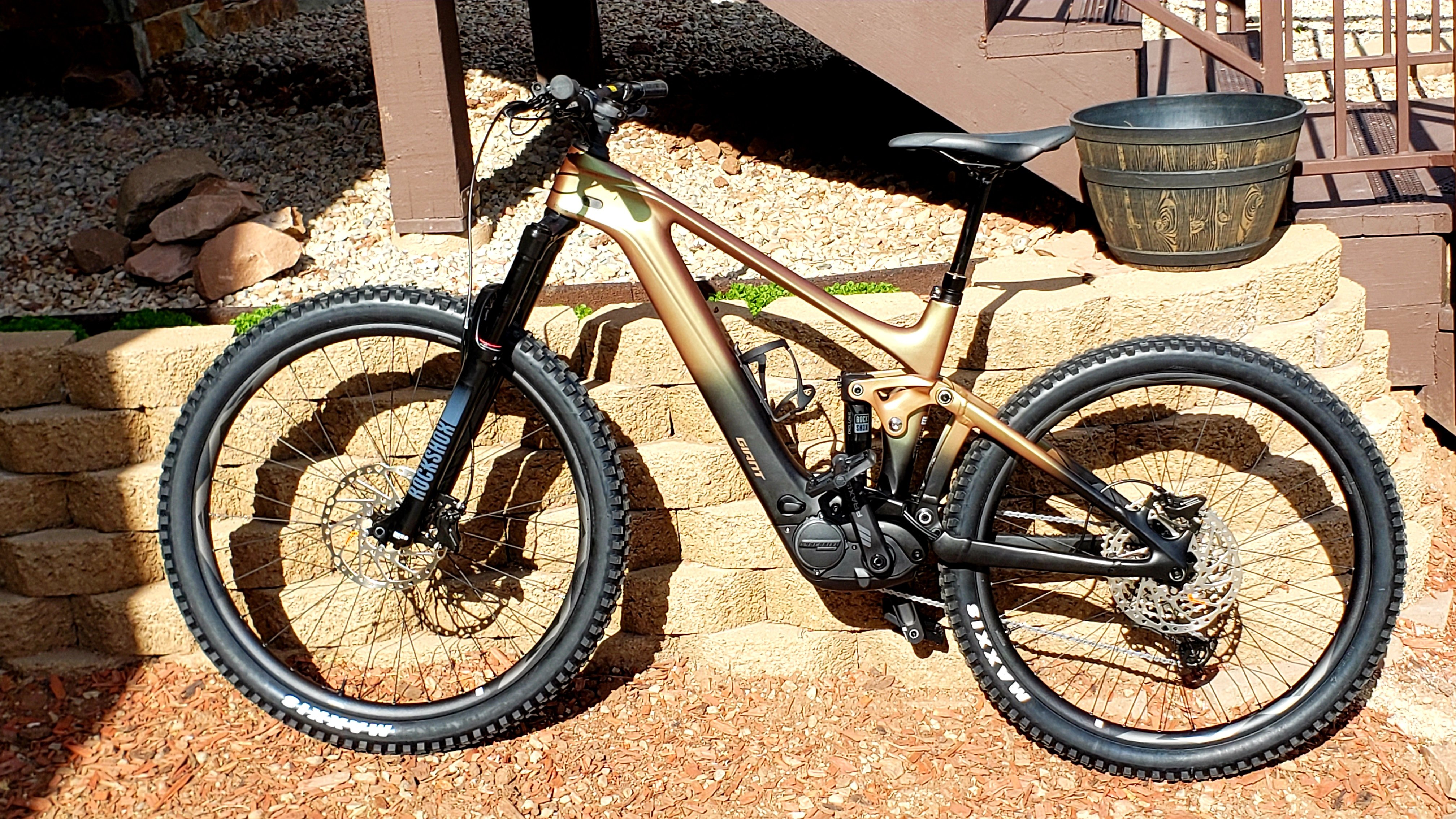

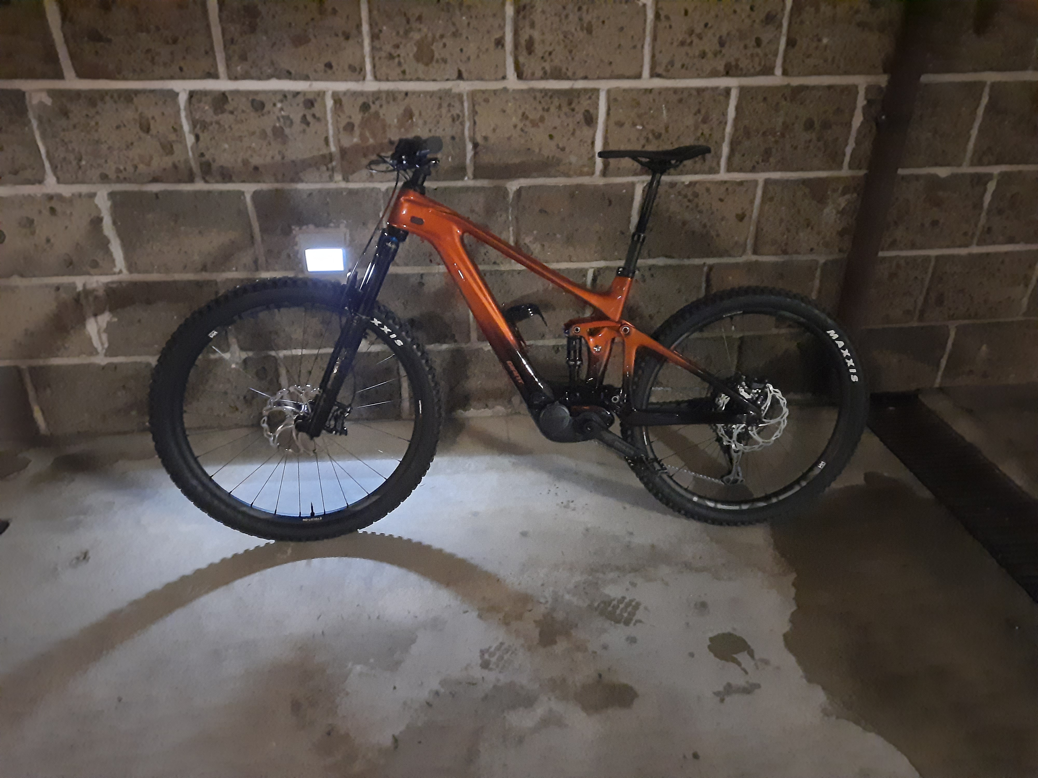

Got the 2, size M yesterday and swapped all the parts I ordered in the last weeks.
The weight in the shop with tubes, bottle cage was 20.76 kg
I like this new toy I had the chance to test only around my house. It's nimble and i like the feeling of the rear suspension. I like the paint and the way the frame has been designed and built. The motor is strong and has a nice robotic mild noise.
In the pics with:
-custom wheel set Newmen Evolution SL E.G 30, DT hybrid 240 30 T , DT comp spokes
-Sixpack Vertic carbon 785 mm, 20 mm rise
-XT cassette
-Braking batfly/ wfix 203 rotors
-Sqlab Ergowave S-tube saddle
-HT nano ANS01 pedals and Pro crank boots
Estimated weight with bottle cage, tubeless, without pedals: 19.4 kg (42.8 lbs), but I will double check it in the next days.

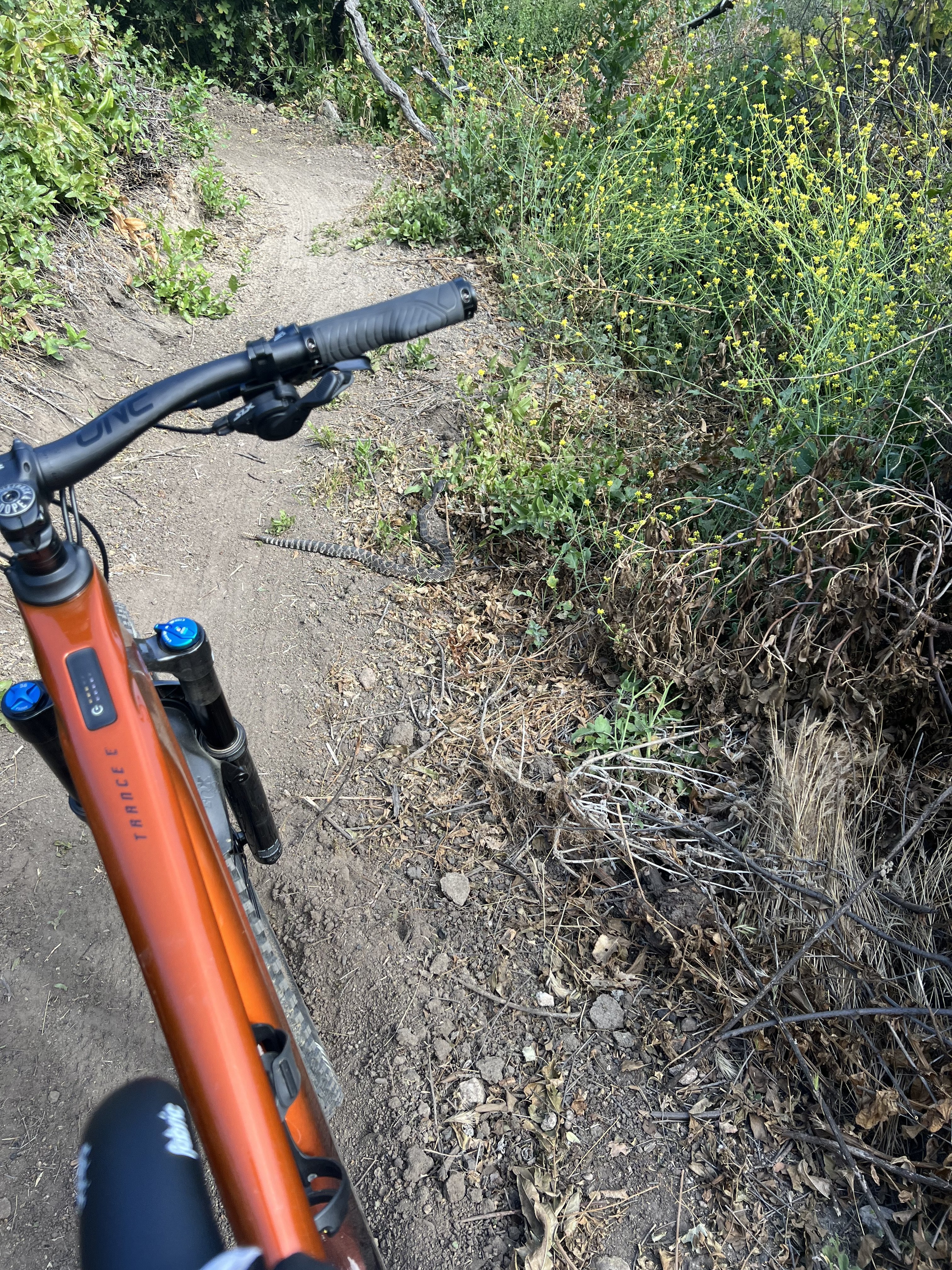

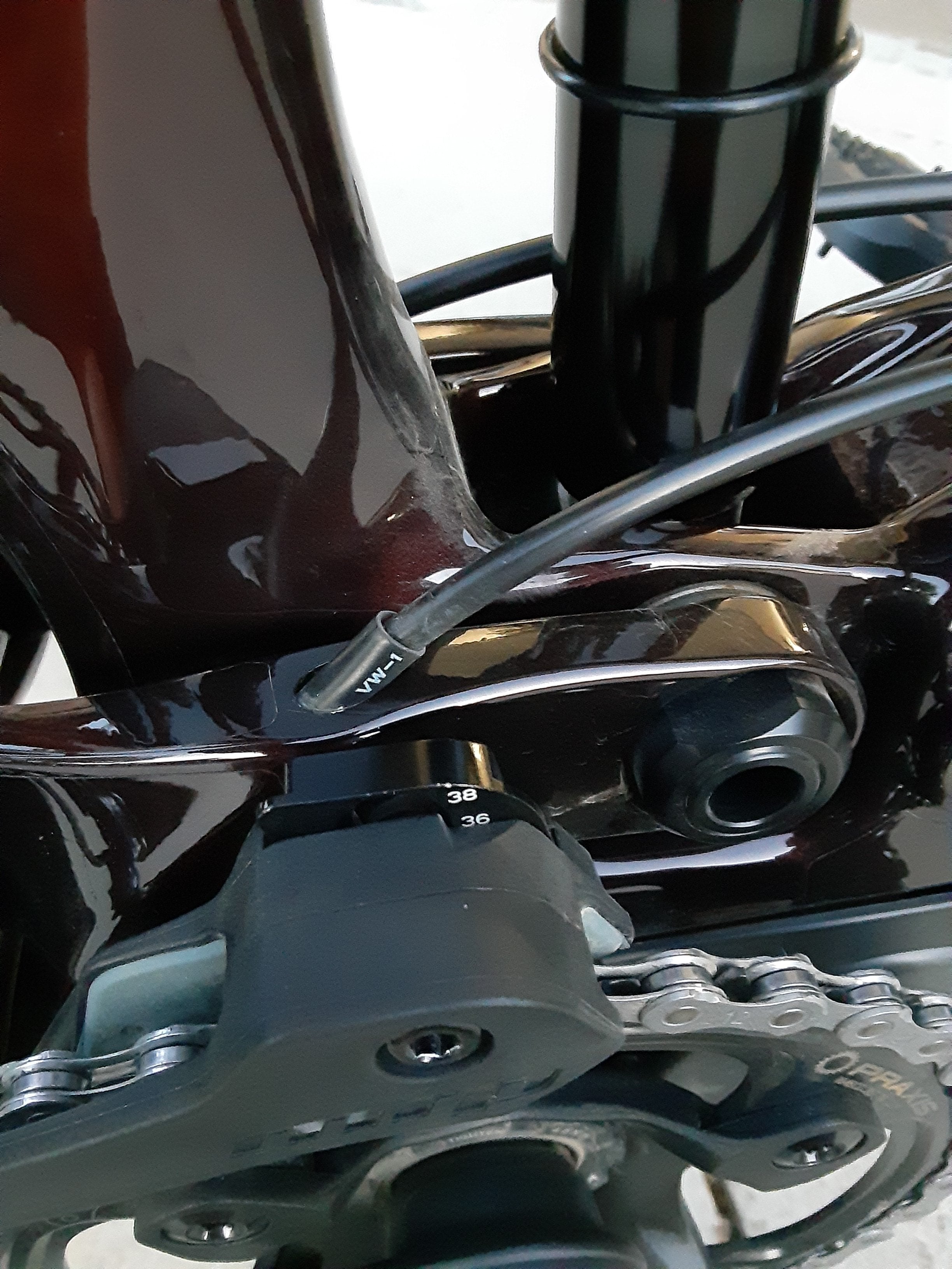

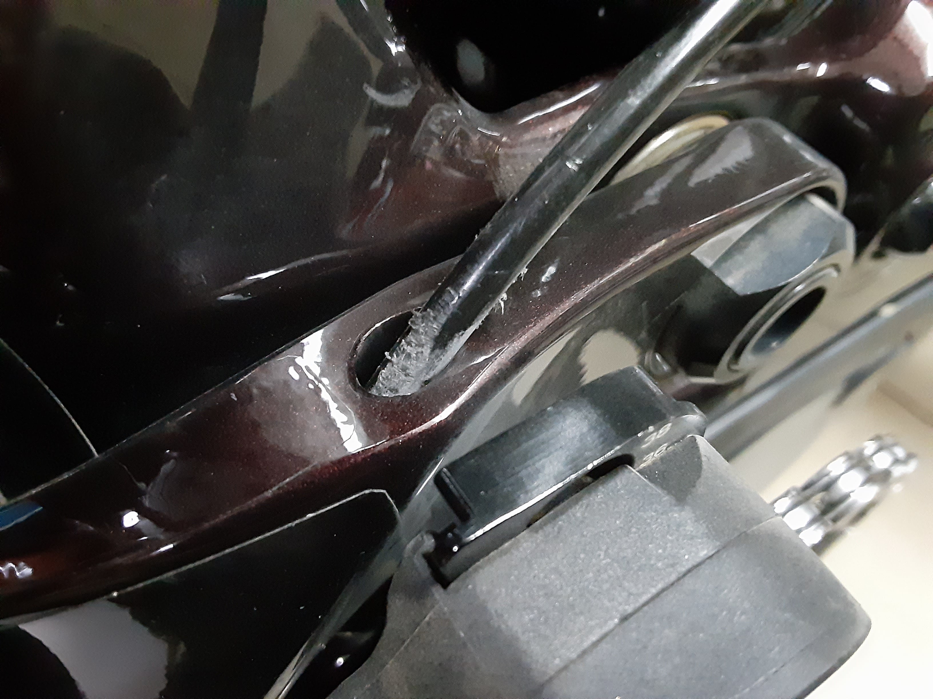

Montana St Alum, could you send a picture of your bike with the OneUp 35 rise bars. Curious to see what they look like..
For EL2 and EL3 owners (EL0 and EL1 are AXS with no derailer cable) it's worth a check to make sure the protective sleeve is slid up through the lower link to protect the cable. It took some coaxing but got mine to slide up a bit..

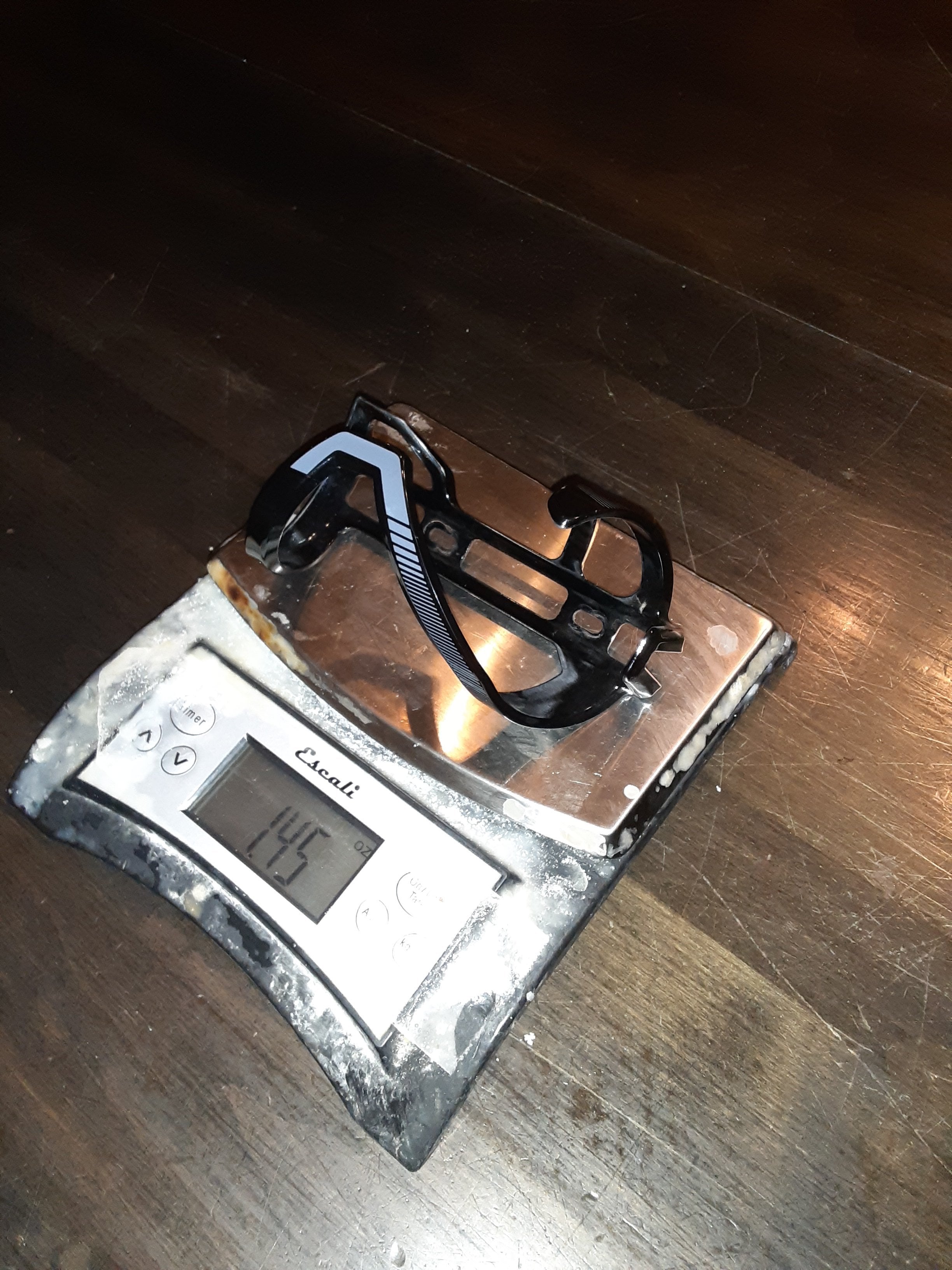

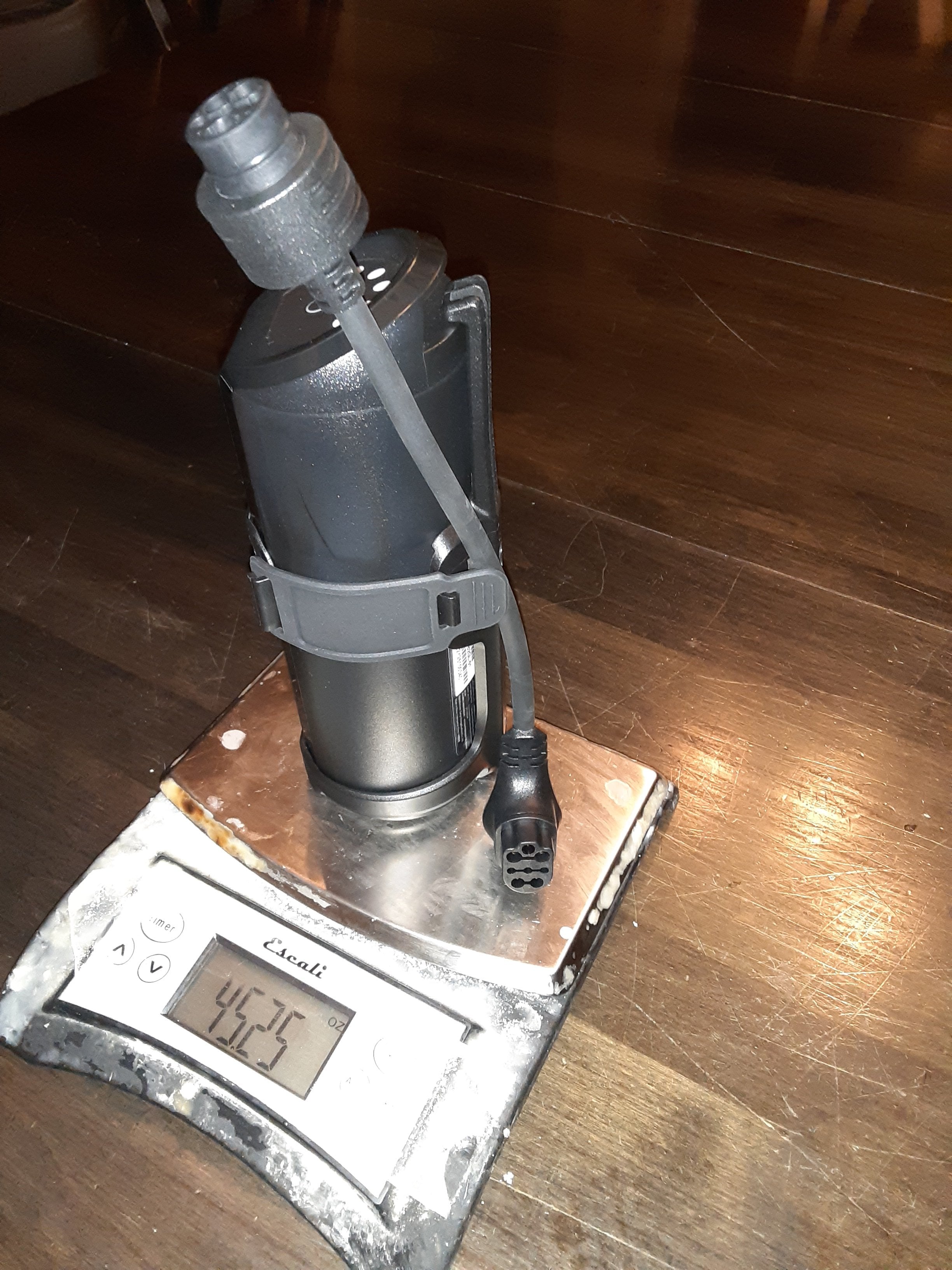

I received my 200WH battery extender and install kit and weighed it for anyone that is interested:
Extender + cage + cage strap + cord = 45.25oz or 2.83 lbs
Removing the 1.45oz Giant bottle cage that I had on the bike results in an increase to the bike of 43.8oz or 2.74 lbs.
Retention with the top catch and strap is excellent and the cord has just enough extra length to curve in a way that doesnt require the provided cable strap (at least on a Large frame)

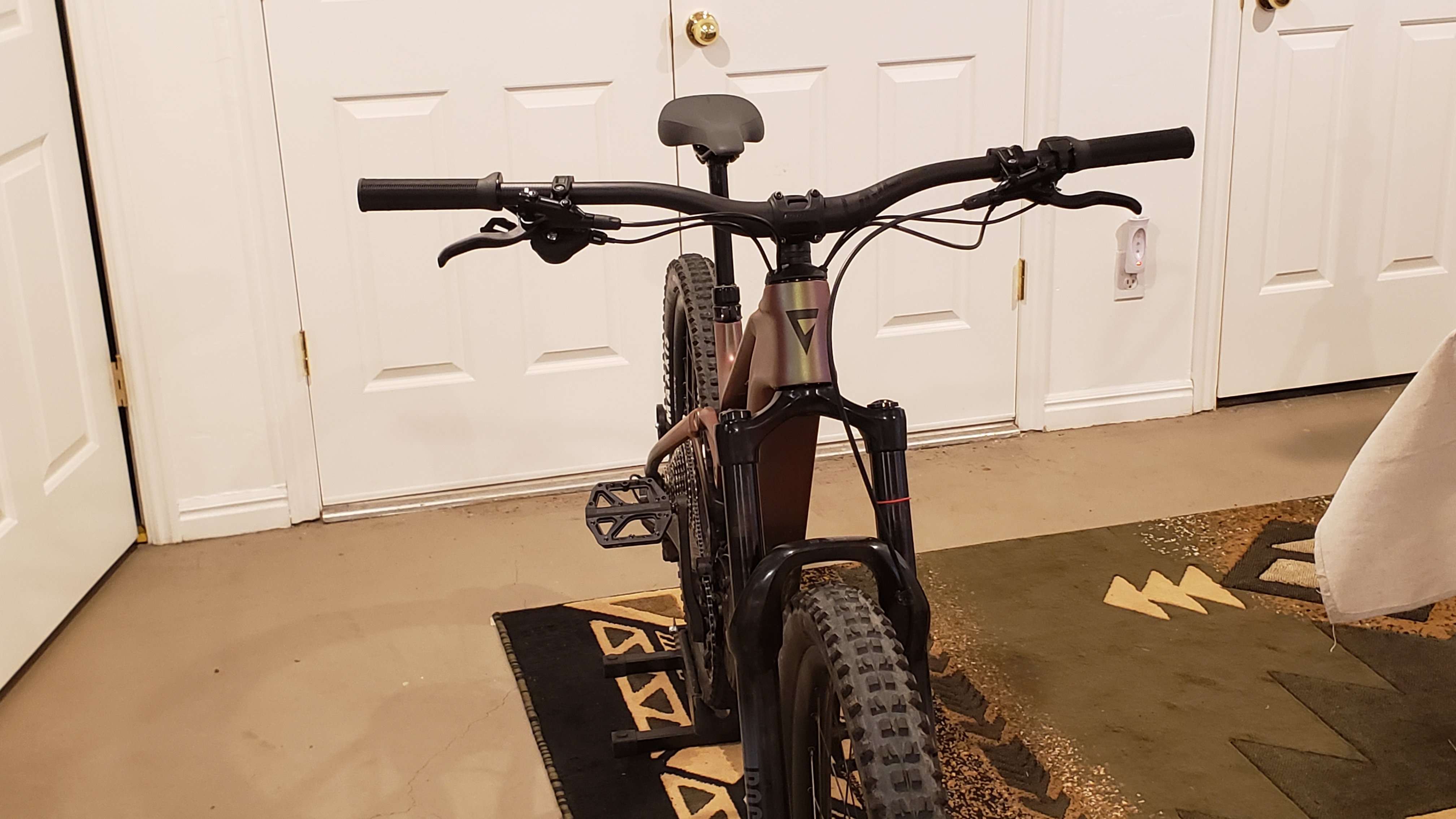

View attachment 115051 View attachment 115052
Sure.
35mm rise, 800mm wide.

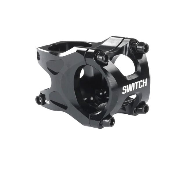

Hi, installed the CNC 35 mm stem I got in the last days. Went for a zero gap installation for top bolts and gap at the bottom ones, as this is the way It's shown in the product pictures. No specific recommendation about this provided by the handlebar manufacturer Sixpack (my PRO tharsis handlebar manual says it has be installed with zero gap).The steering feels a bit different than the Giant 40 mm stem, even not radically. I can feel the differences on sharp cornering and U turns.
I bought at a local bike shop a pair of black, Xpedo Spry and swapped the flat head pins with more aggressive pins set I had available: proper grip and a final weight of 264 g. They look good and, in my opinion, are a better match with the bike vs the HT Ans01 I moved to my Slash.
Weight drop of 135 g, so the bike with pedals and bottle cage is now about 19.65 Kg (43.4 LBS).
Played with the app and went for a gradual ramp from 20 to 85 Nm Max torque over the 5 assistance level, left unaltered the assistance % and decreased the by 1 the launch control at 1 to 3. Left unchanged the level 5.
I'll put on some strategic protections tomorrow and then go out for a ride!
