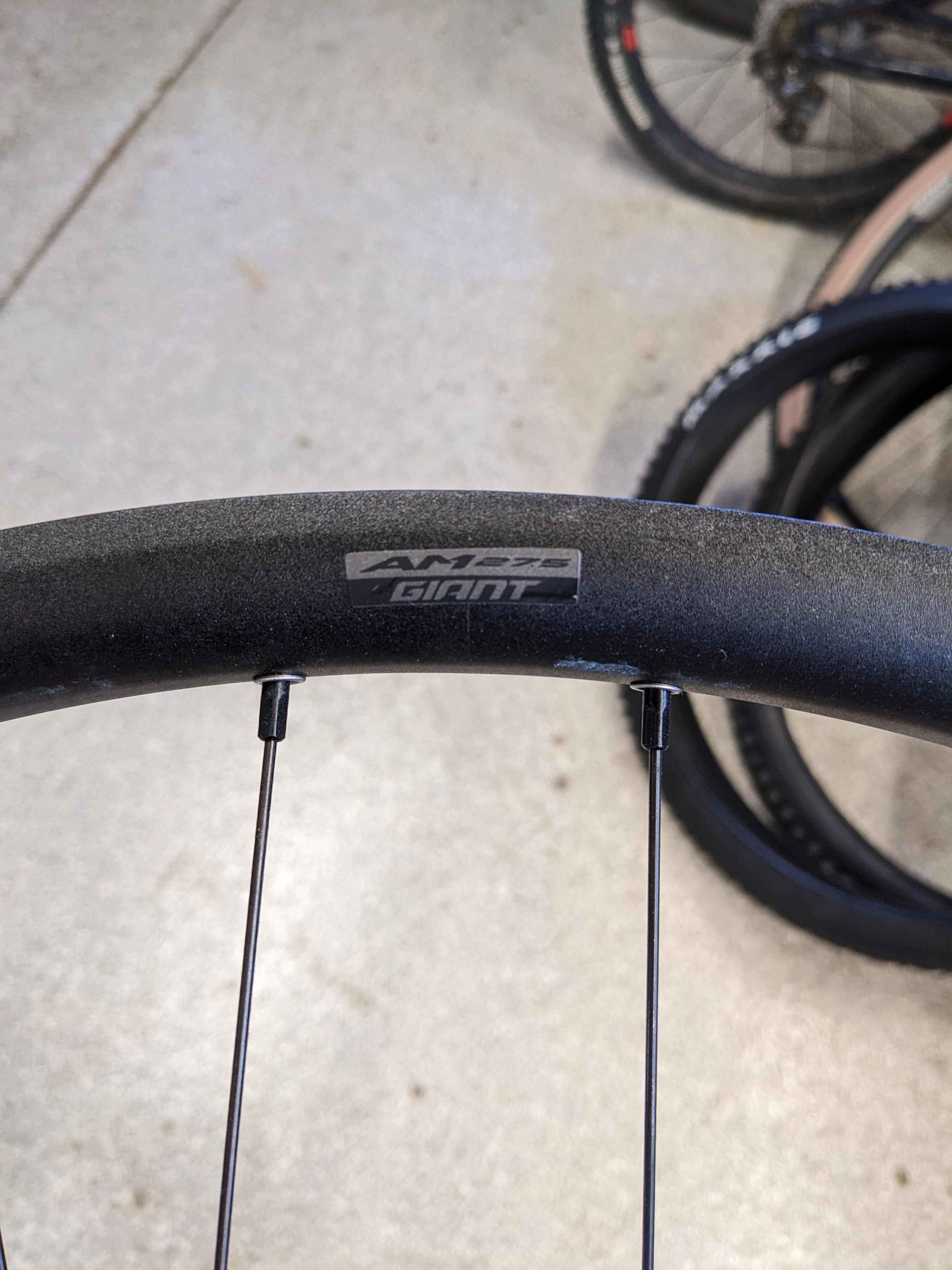

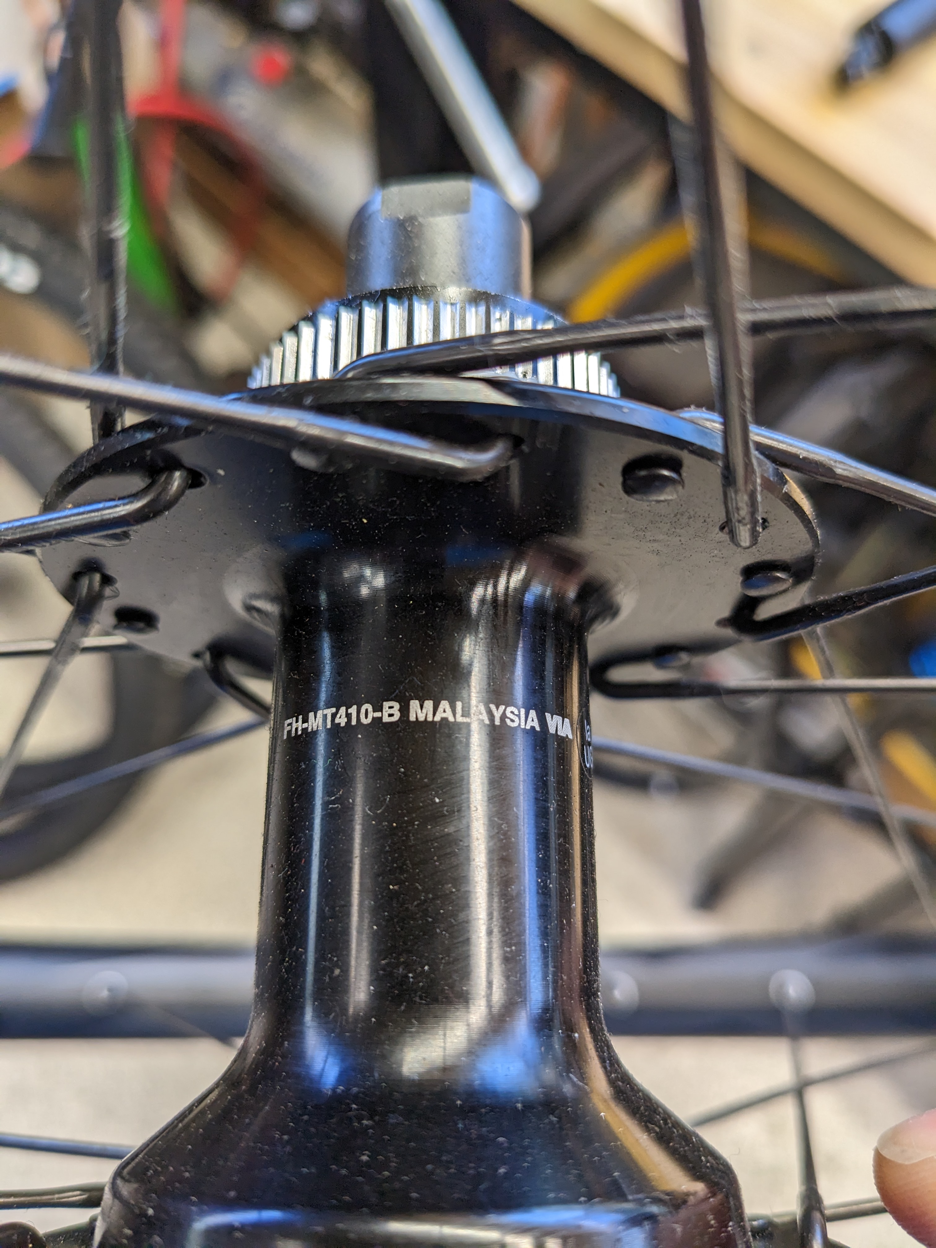

Very undecided about the wheels.
Stock wheels , Giant AM E-bike are mullet, Shimano MT410 CL hubs (shitty for an E-bike?), 32 Sapim "E-lite"and Race spokes and bits . The rims that are shown on Giant website look with eyelets 20ish mm height. The estimated wheelset weight is about 2300 g.
They are 1030.9 g front, 1209.2 g rear.

Thanks. Could you post a picture of the wheels, showing the rims? Are the Sapim race spokes 2-1.8-2 only on the front?
I don't think the spokes are butted at all on my wheels. Hubs are Deore front and rear, rims are house brand.
Here's all the stuff I weighed (and estimates on the others) vs the upgrades I would do; the items in bold I actually weighed.
