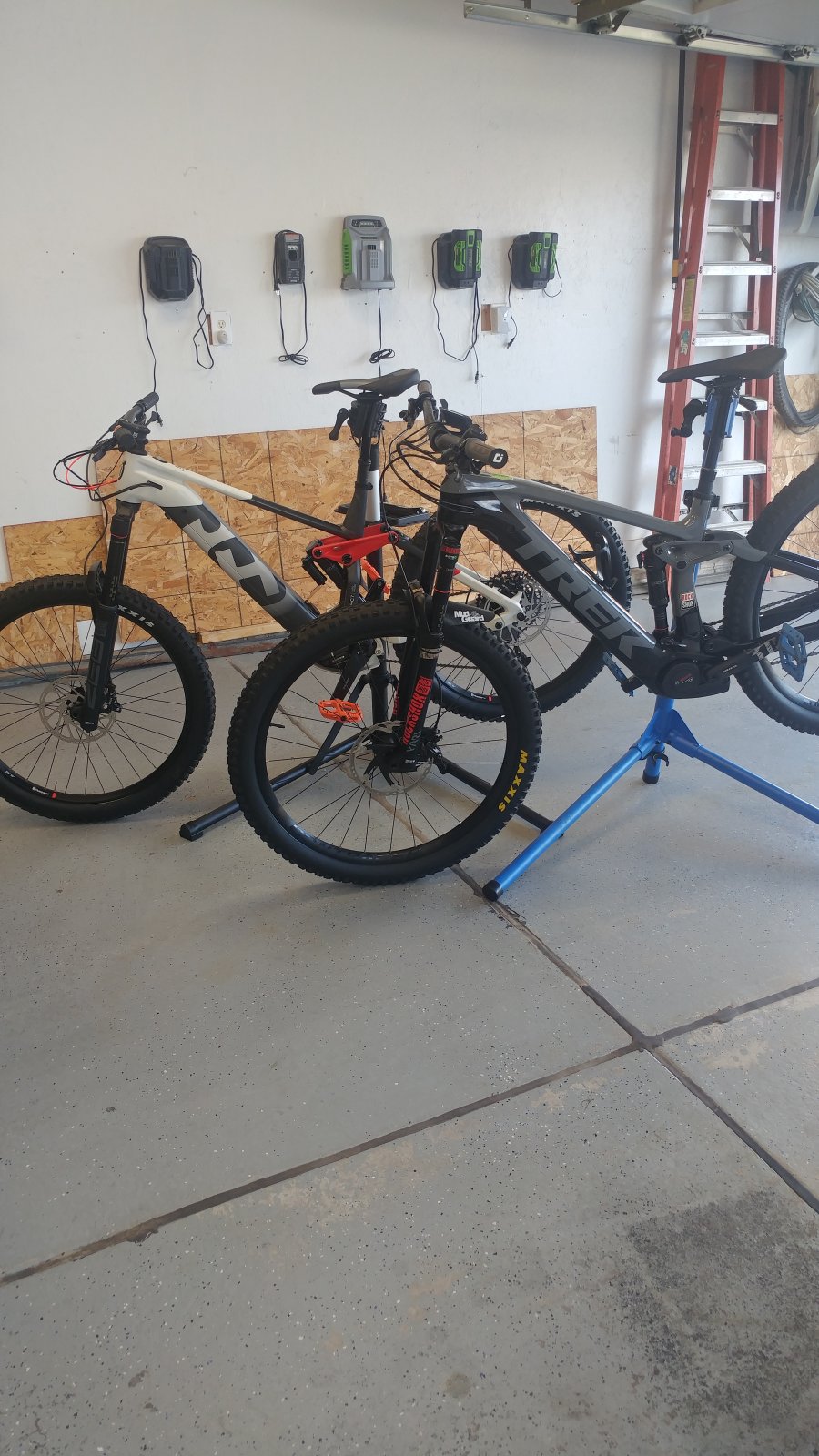

My HC7 arrived on Sunday. I unboxed her, put her together...so far after one ride, it seems like a great choice. I need to upgrade the display to the 8000 so I can blue tooth a better custom motor set up though. The 3 stock motor programs are not good. Suspension is great. Overall, very pleased.

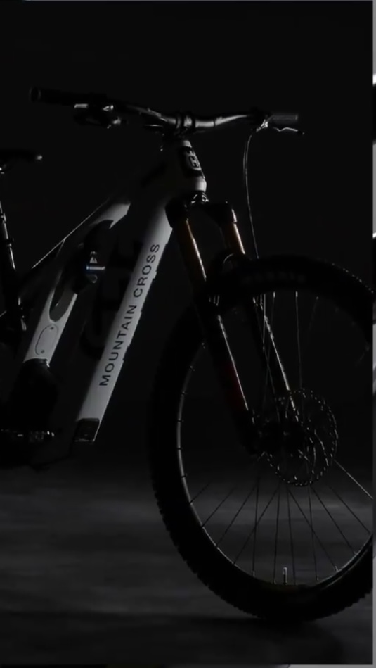

I agree. Based on shock placement etc, it looks to be in line with Trek's Ecaliber line. More of a recreational, shorter travel mtb. Not necessarily an enduro type.
9,190

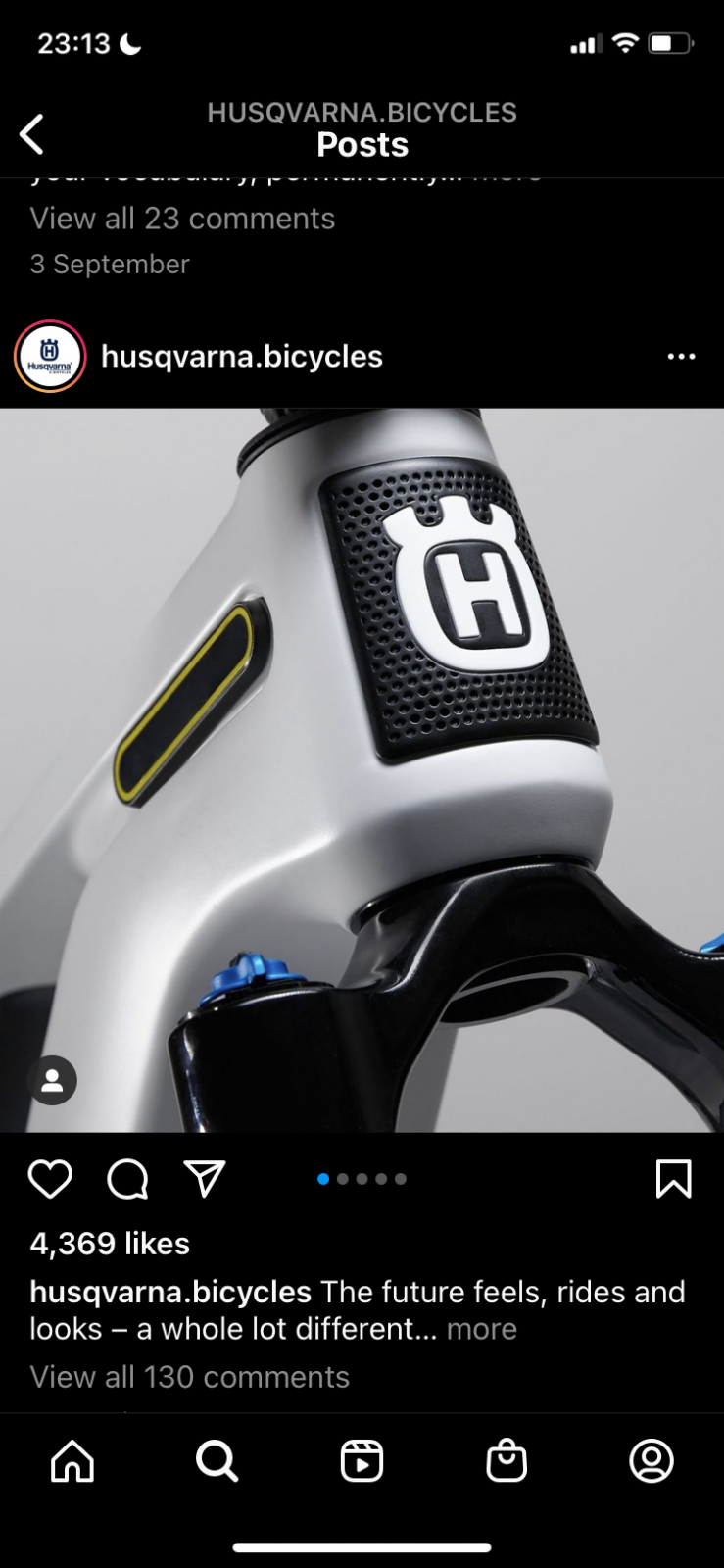

Looks like a full on trail or enduro bike to me, clearly running a fox DPX 2 and 38 - very similar to the Levo and Whye in terms of motor orientation and battery placement- also looks like anothe bike where the designers have decided to shove all the cabling though the headset, which IMO is the worse trend to develop over the last few years.
Aren’t these designed by the same people who do haibike?
I thought it looked like a 150mm to maybe 160mm travel Fox 36, which they currently use on the MC7.
9,190
Yup could be a 36 but I though like it looked like a 38 performance from this pic.
No doubt there will be a trail and an enduro version

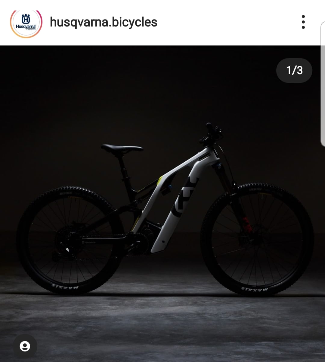

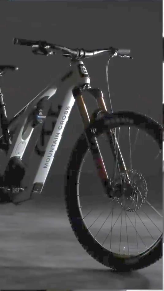

So on Husqvarna’s Instagram page they’ve posted some more pictures. As I thought this bike is the new Mountain Cross. So most likely a 150/150mm travel model.
9,190

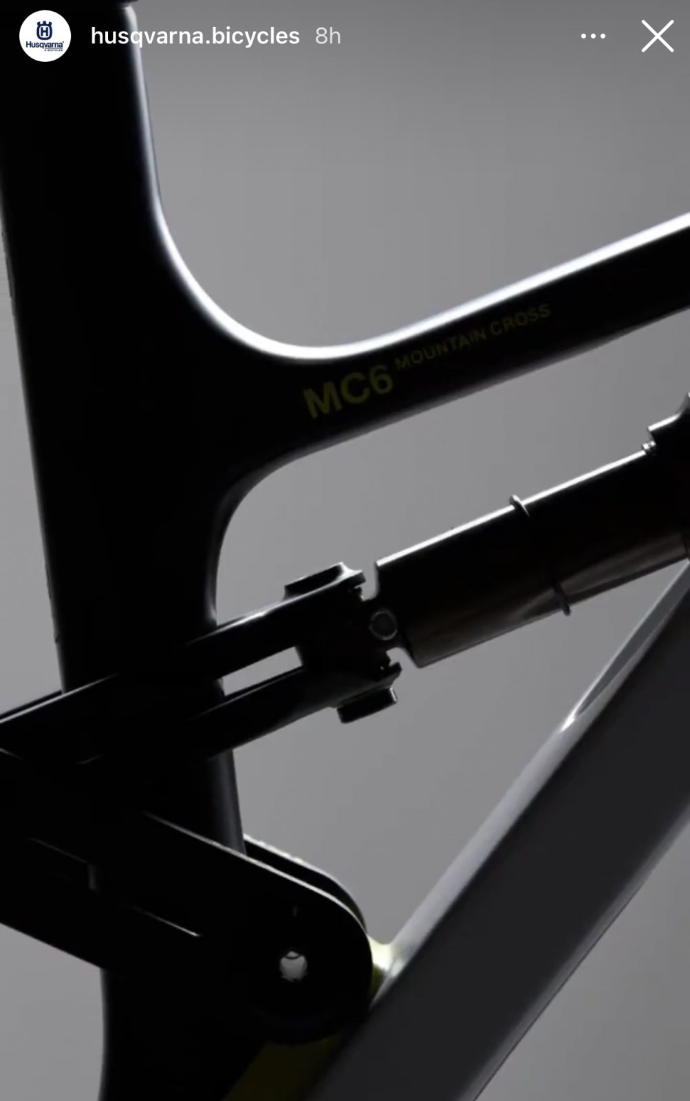

Interesting design with the shock passing though the frame brace. Look like it’s pretty wide at that point, I wonder what knee clearance is like.

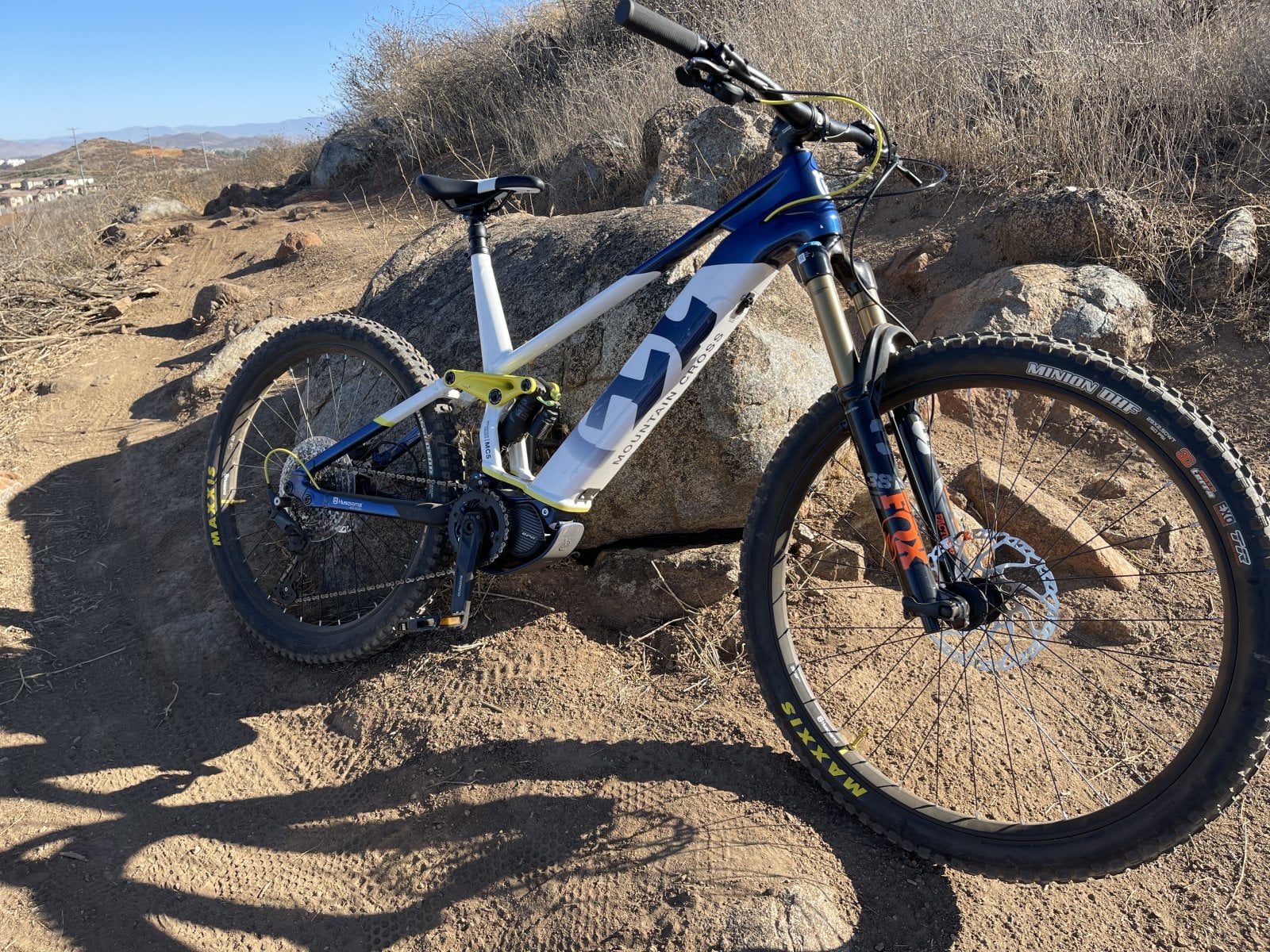

Ok after a few rides I'm really starting to like this bike! I think I have like 25 miles on it only. Of course the upgrades made it much better than stock. So far I've added a DVO Topaz rear shock, Fox 38 factory fork at 160mm travel, Maxxis Minion DHF 2.5 front and Dissector 2.6 in the rear (tubeless set up of course), and some ODI Dread Lock grips. Next up some Spanx bars just trying to figure out what I should cut them down to since they are over 800mm. Then seat and maybe some wheels. Brakes and drive train when it wears out.
Now I just need to ride some more trails and test its high speed feel and some real jumps!

How do you like the DVO Topaz? I have the Mountain Cross 5 as well, and the RockShox shock is pretty terrible, and I've been looking at buying a Topaz to replace it.
MTBMOTOMat
Aug 21, 2021
11
12
California
So I never rode in the dirt with the stock shock. I knew it was low end and wasn’t going to handle medium to aggressive riding so I swapped it immediately.
So far I’m pretty happy with it. I added a couple spacers to have more bottom resistance. It also helps because I can get proper sag easier with a bit less air.
If you can find one you’ll just need the mounting kit so it fits right. I used the rockshox spacer and then just the dvo washers.
