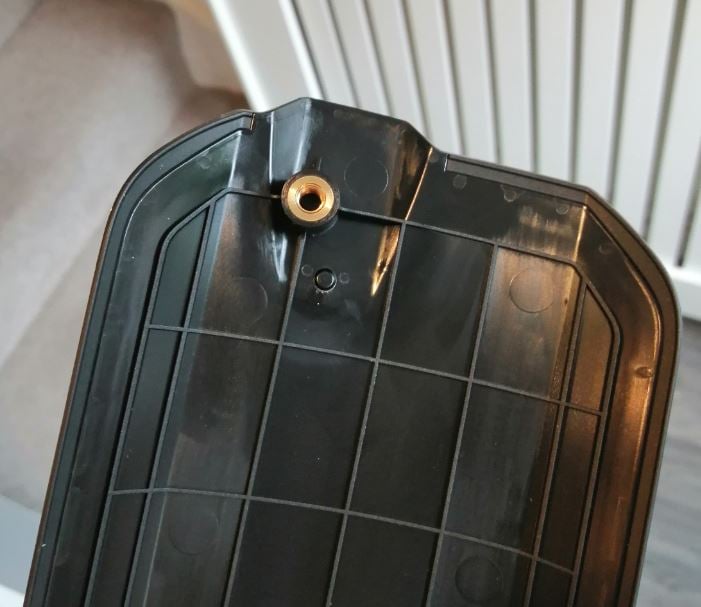

Well I was not expecting them to send me a new one (no correspondence) which makes me feel they know there is an issue with the battery cover coming off. Amazing speed of delivery.. however....
The original battery cover has a black plug that snaps into the frame to hold it in place, the new one they sent me has a thread. Meaning I cannot attach it to the bike anymore. It has a screw thread attached, any ideas? I am not drilling through or altering my frame.. any ideas what this is for?
See attached.

Did they just post it out to you? When you say no correspondence, a new cover just arrived in the post?
I think that is where the push fitting screws into.... I guess thats not in the package also?

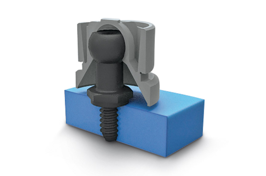

Thats super cool that they got you a cover so quick! The Haibike guys do watch this forum. You are missing one part of the Böllhoff coupling, which would have been in the old skidplate. Was there anything else in the parcel?

No Rob just the cover.
The bike shop (e bikeshop) got in touch with Haibike and they sent me 2! waiting for a follow-up, i think the black grommet screws into that and is a separate part. The bike shop knows the guys at the haibike uk factory think that's why i got it so quick,( they knew i was doing a review on the bike as well ) lol.
