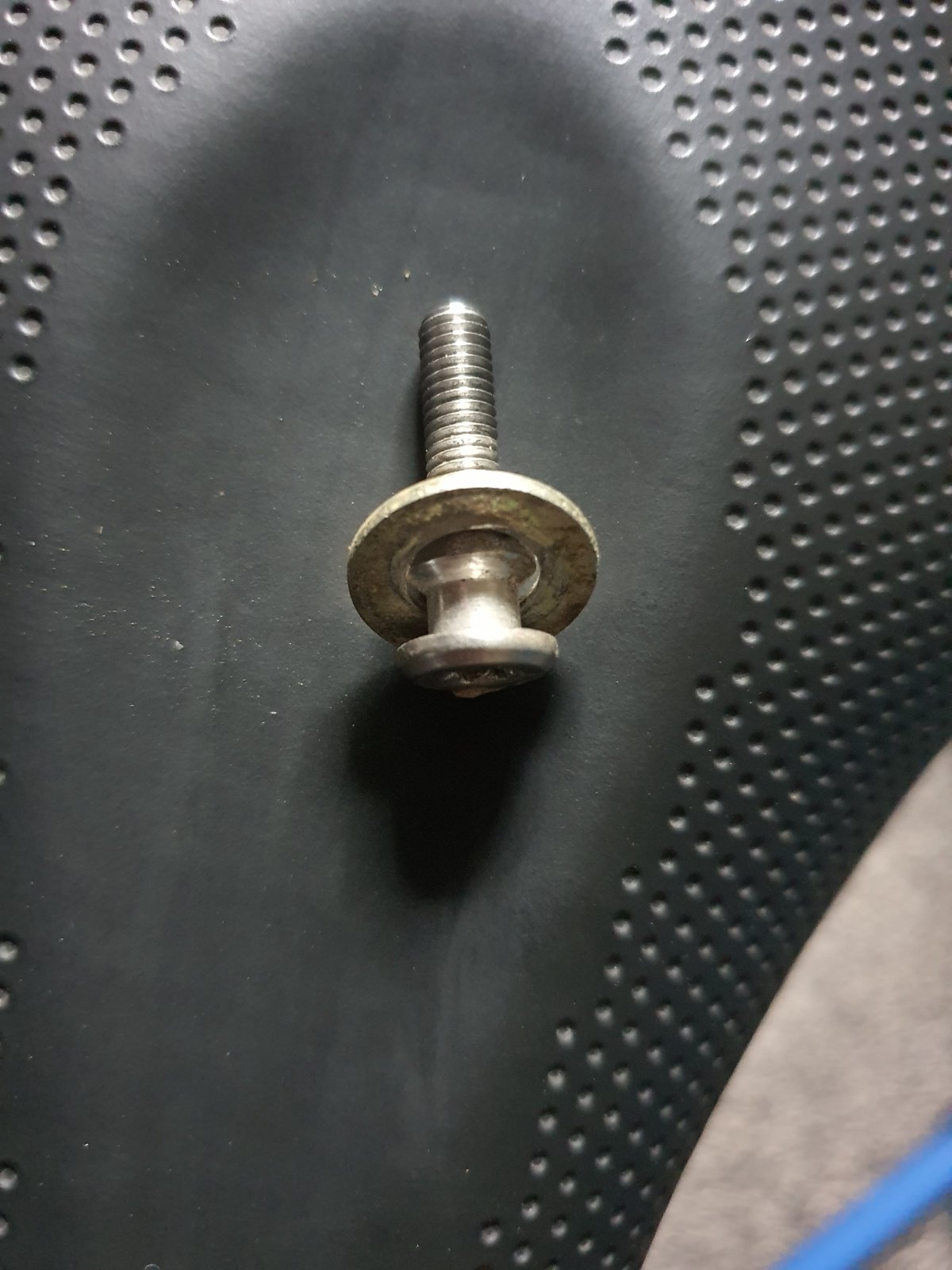

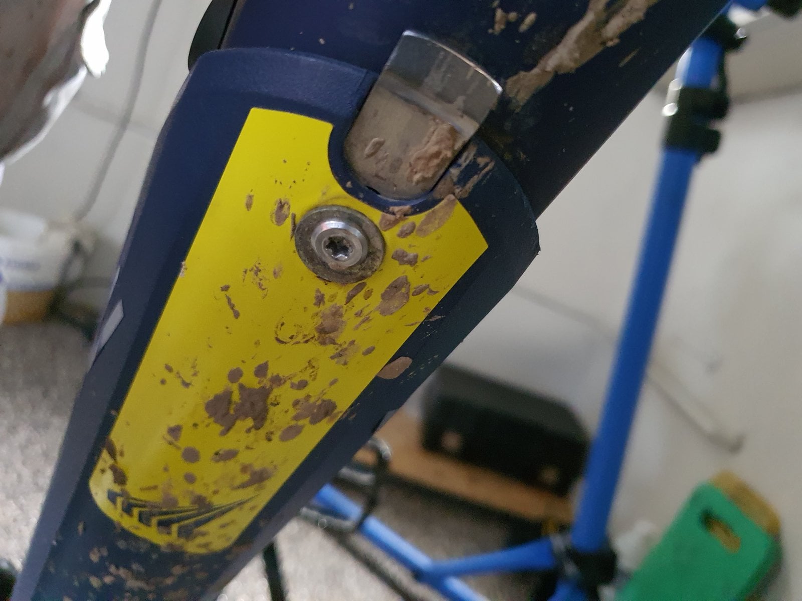

I lost mine a while ago. I noticed it quick and found my cover back on the trail.
I made cover stuck on the frame using the screw that hold the plate.
Only disadvantage is if you remove the battery alot you have to unscrew it every time.
Only disadvantage is if you remove the battery alot you have to unscrew it every time. View attachment 44565
Was that for the haibike or another bike?
Haibike are not responding, ill update when they get in touch to support questions.

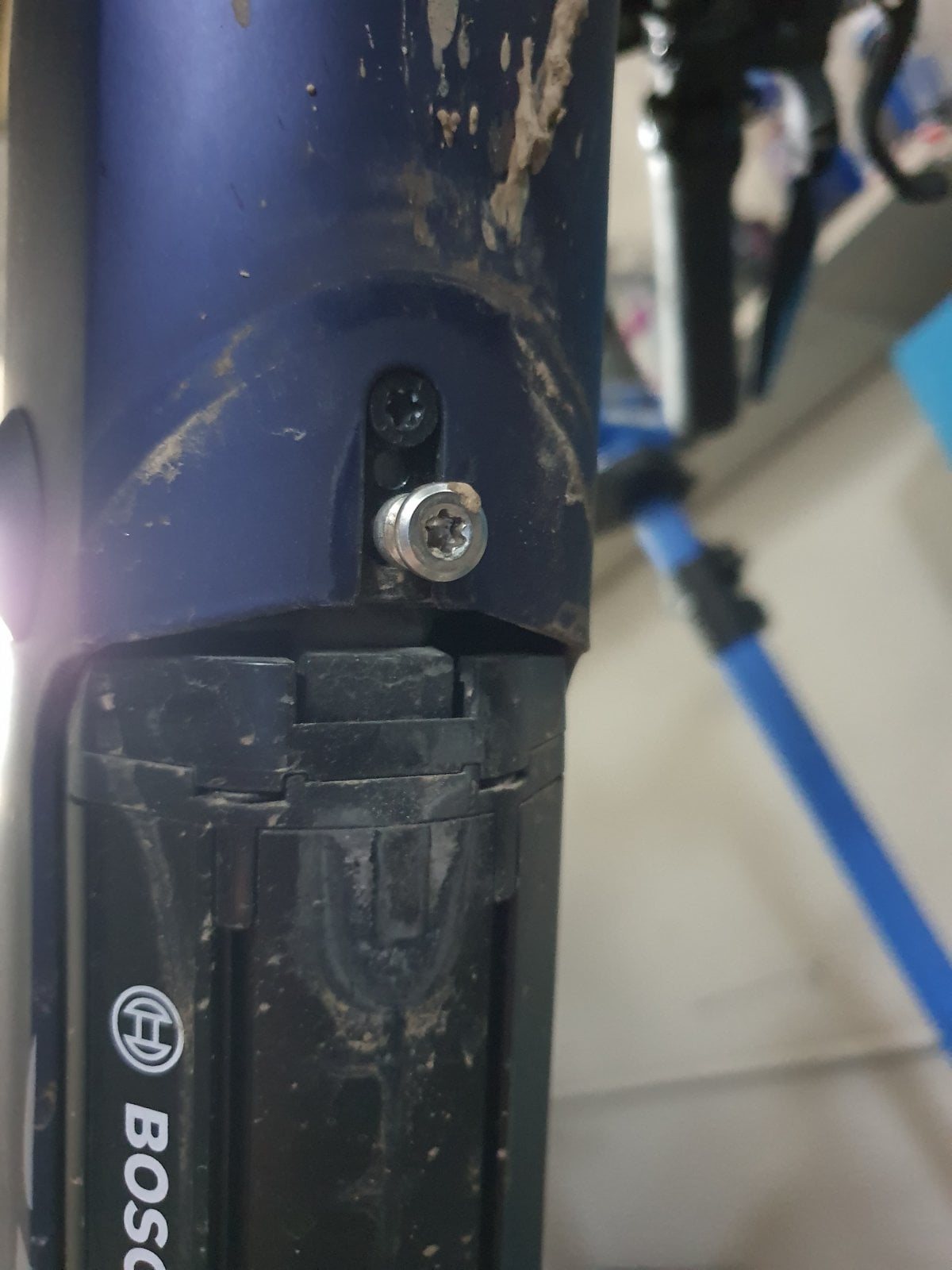

I own a haibike myself. I did that myself I was trying to find a way to make plate permanent as I never remove the battery.
You just unscrew the grey screw behind the skidplate.
You place the skidplate and just use the same screw with an o-ring and screw it trough the skidplate hole.
