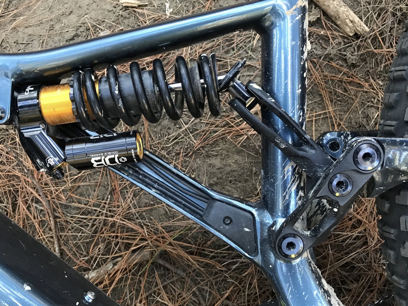

Wow, I havent been on forums in a while and saw that picture. I know they dont recommend the IL version...interesting to see that broken on a CS.
Any other broke on this forum or just that person so far? I have no reason to believe that would happen to me as Im not taking big drops. If it does, hopefully the spill doesnt hurt me! The shock feels too nice compared to air.
Ill find a pic for you bud.

Shit! That's not good.
@Biaferon Id definitely not put that on your bike... Why take the risk?

Are you sure that you want that shock?
Karsten
Was this shock on your actual bike or someone else’s bike?
Cane Creek released a thicker shock shaft for the CC Double Barrel a few years ago. The shaft went from 8mm to 9.5mm as they had had a few failures.
It is obviously hard to see if the failed shock you have pictured has the 8mm or the 9.5mm shaft.
Cane Creek say a big NO to fitting Cane Creeks ‘Inline’ coil shock on a Levo or Stumpy as it has an 8mm shaft. However, I have not seen anything from them saying NO to the Cane Creek ‘Double Barrel’ coil shock. That does not mean to say they have not released something in the past few months.
I got the pic from one of the other threads here and somehow got the impression that the warning covered both versions of the DB. Anyway I would contact CC directly and get it verified - Fact is that the pic clearly indicate that it can break for sure.

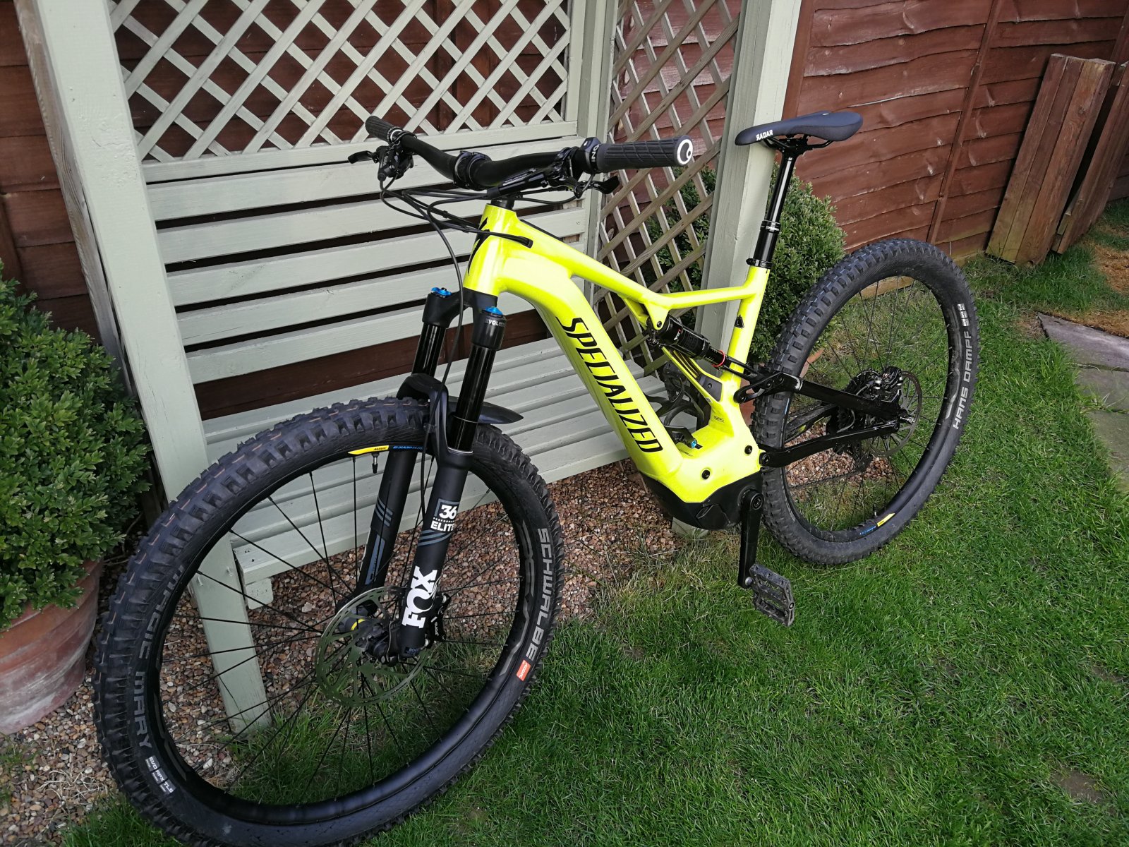

I see you have pretty much done what ive done from your bike pics. Looks class top model now for half the price ?
