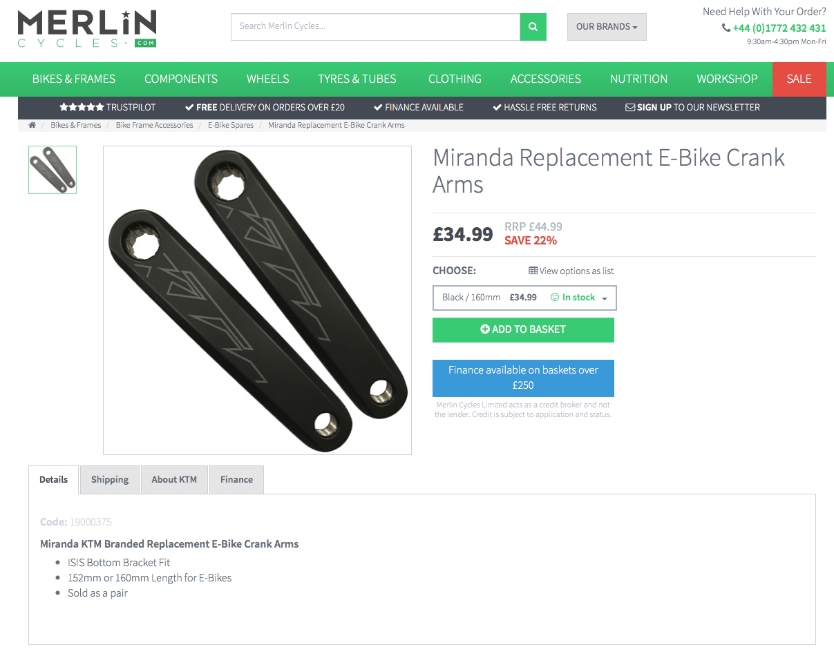

Right... after my off yesterday I need to get a new crank arm. I need to buy a pair as thats all the OEM Praxis are sold as.
I'm going to try and get 160mm, reducing it down from the standard 165mm. I get loads of pedal strikes, I know this won't solve it completely but I'm going to give it a go.
Has anyone changed theirs to anything other than standard?
Cheers,
Rob.

Be nice to find some to fit the shimano motor , no idea why mtb are made with such long cranks , I think it’s the last thing to become developed from the old standard roadie type bike where it all began not that long ago .

Brose is isis bb fit so dont see why they wont work
